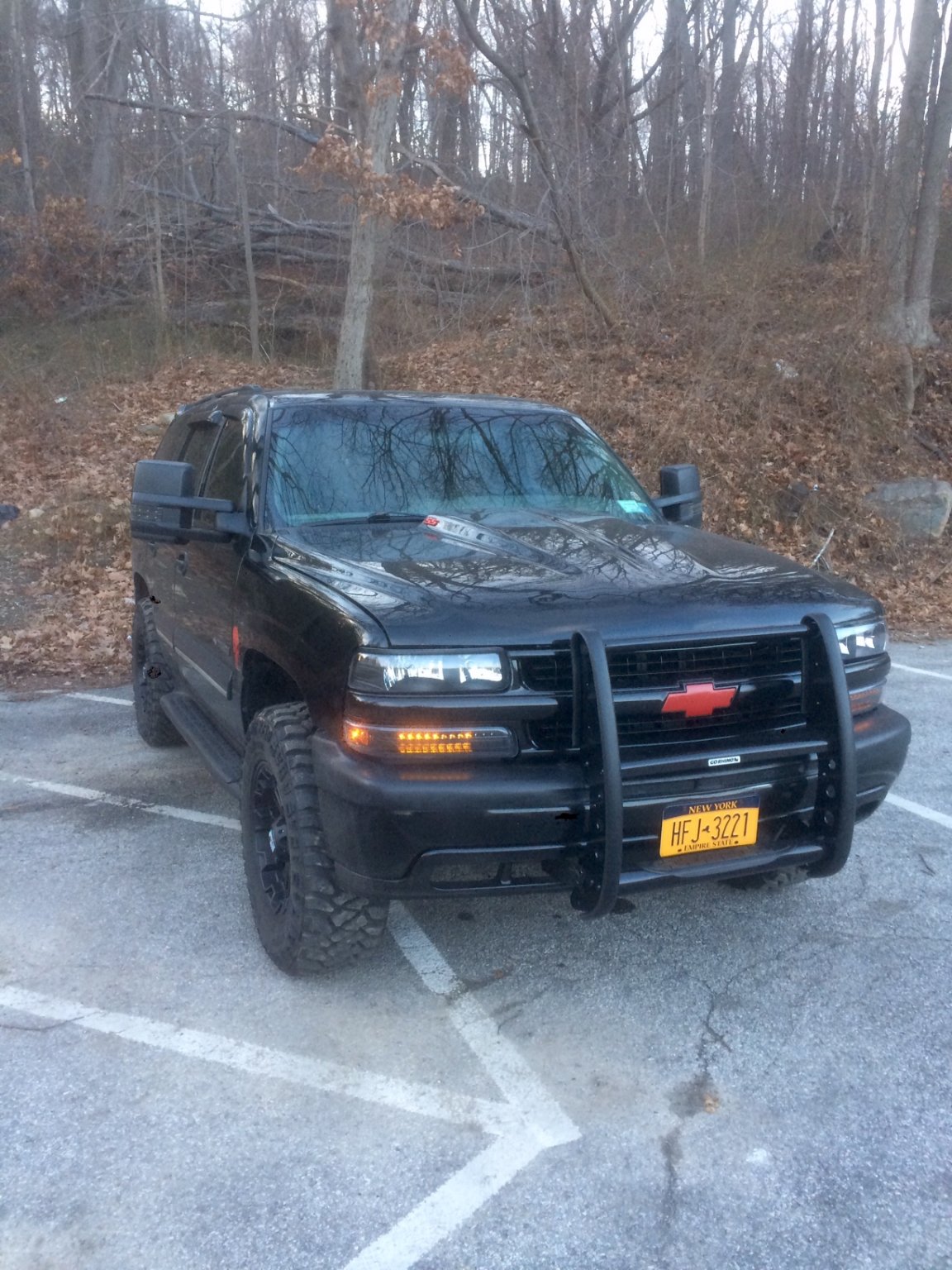

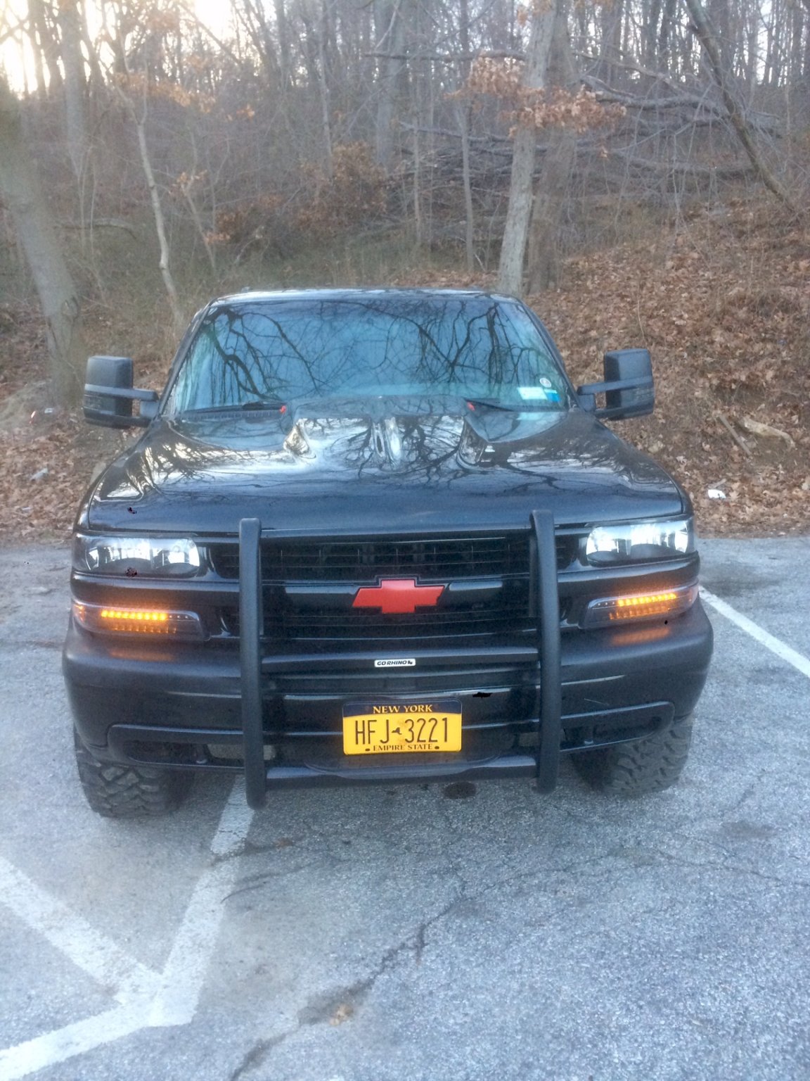

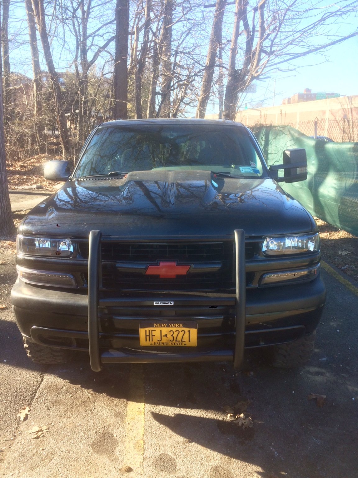

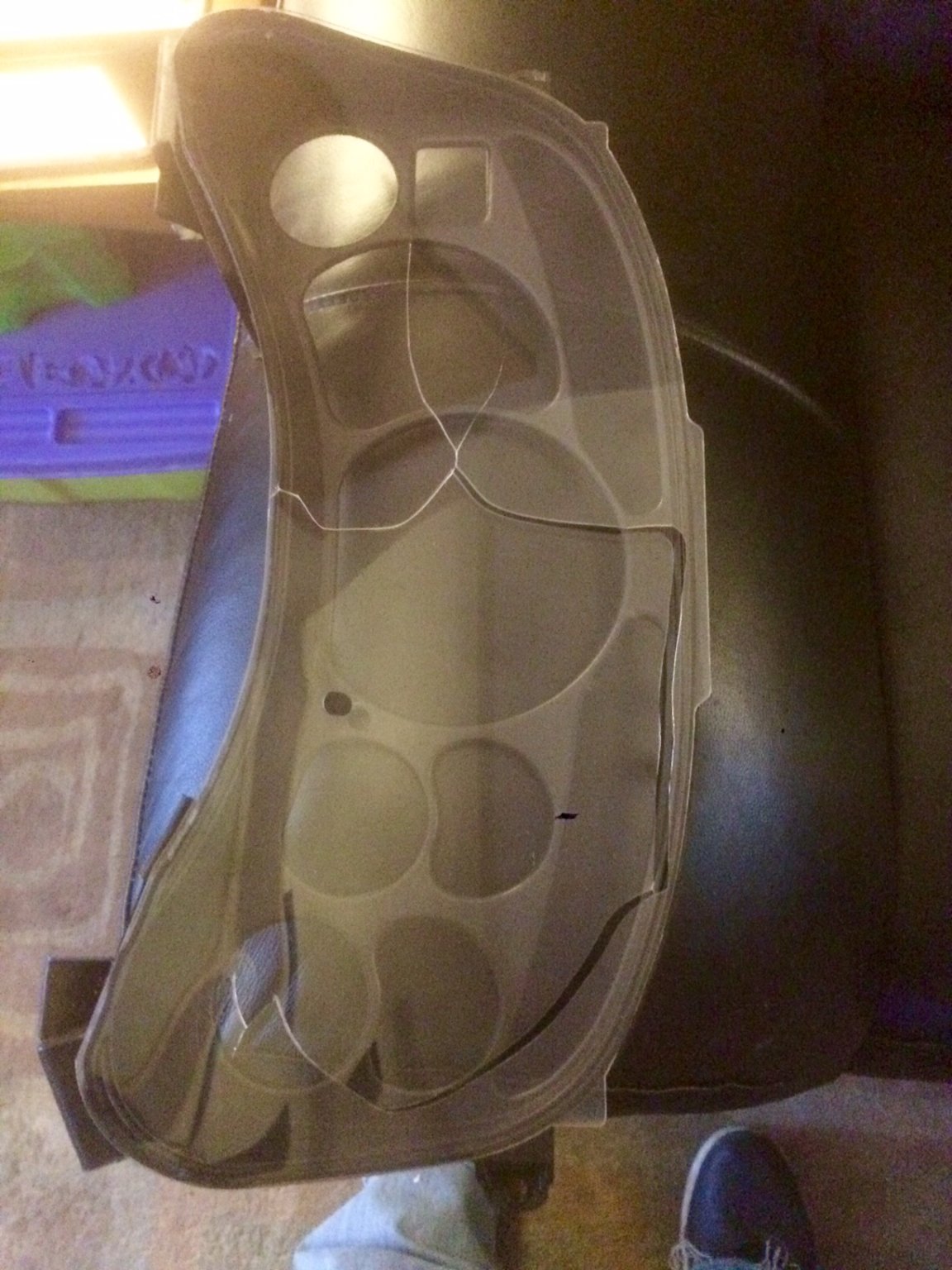

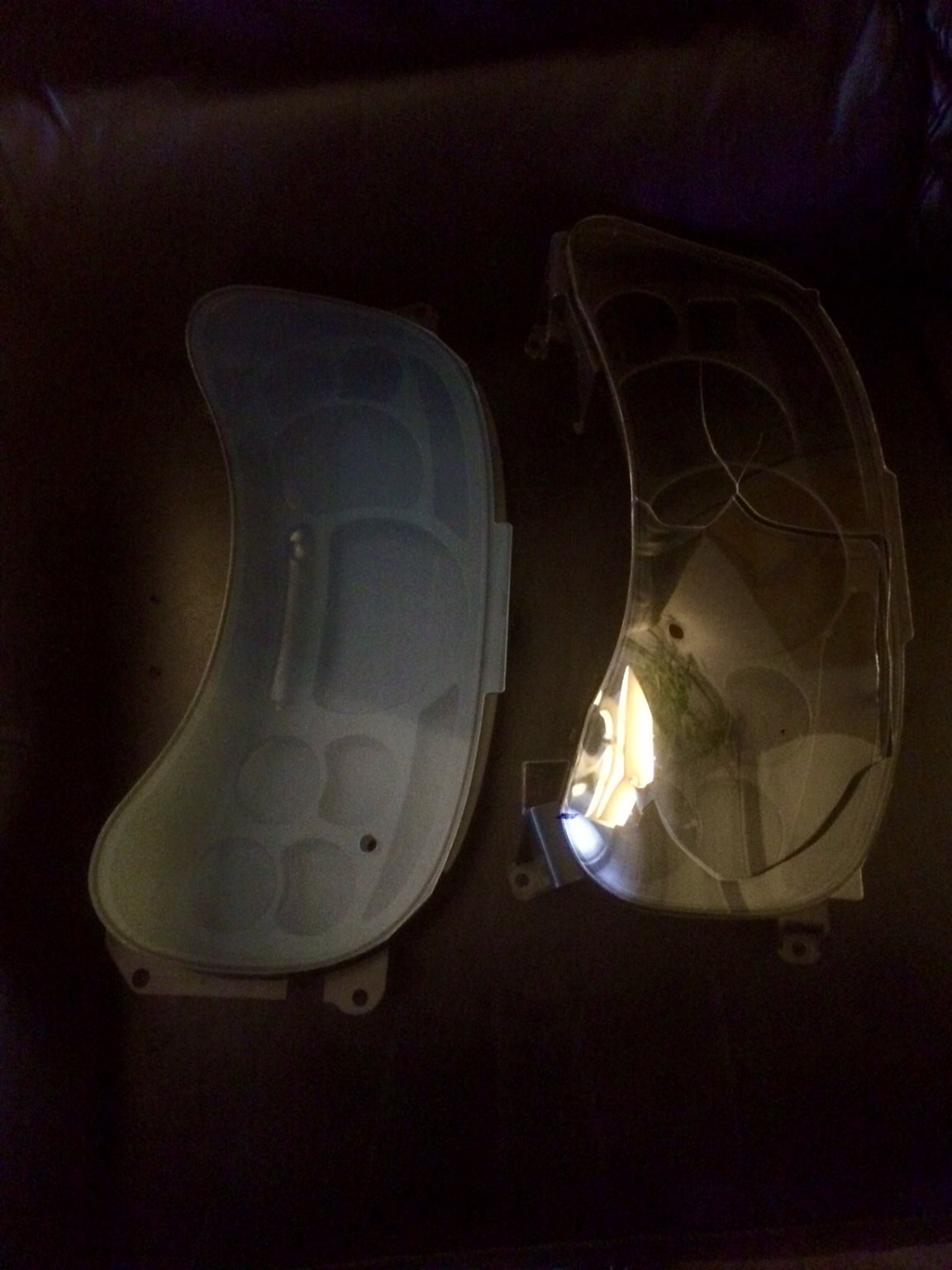

Lots of soldering today, i attempted to fix the PRND in my cluster today since it's been driving me crazy since i bought the truck. I ordered a new ac delco plastic cover for the cluster since i broke mine tapping on it too hard...after removing the cluster, i realized it was not OEM, it was from an '01 Silverado.

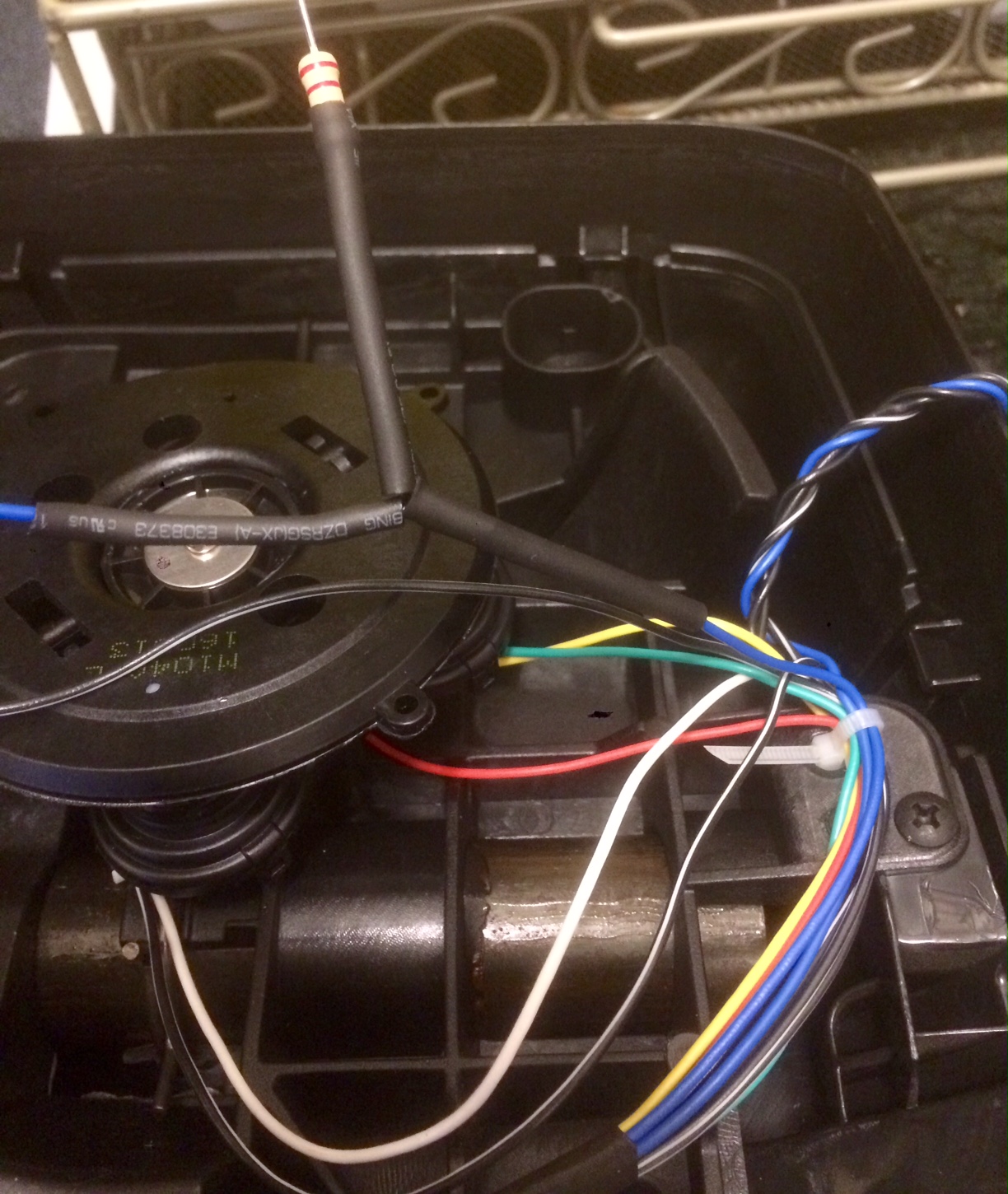

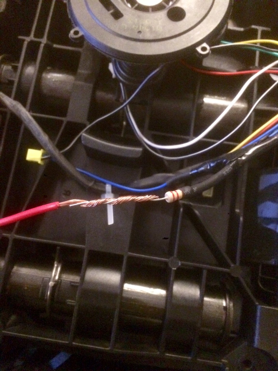

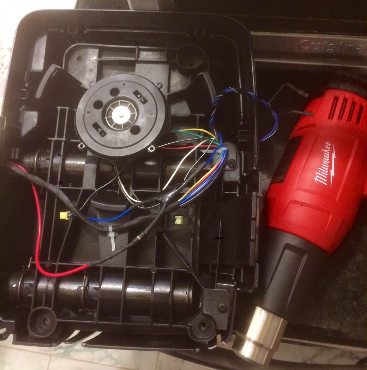

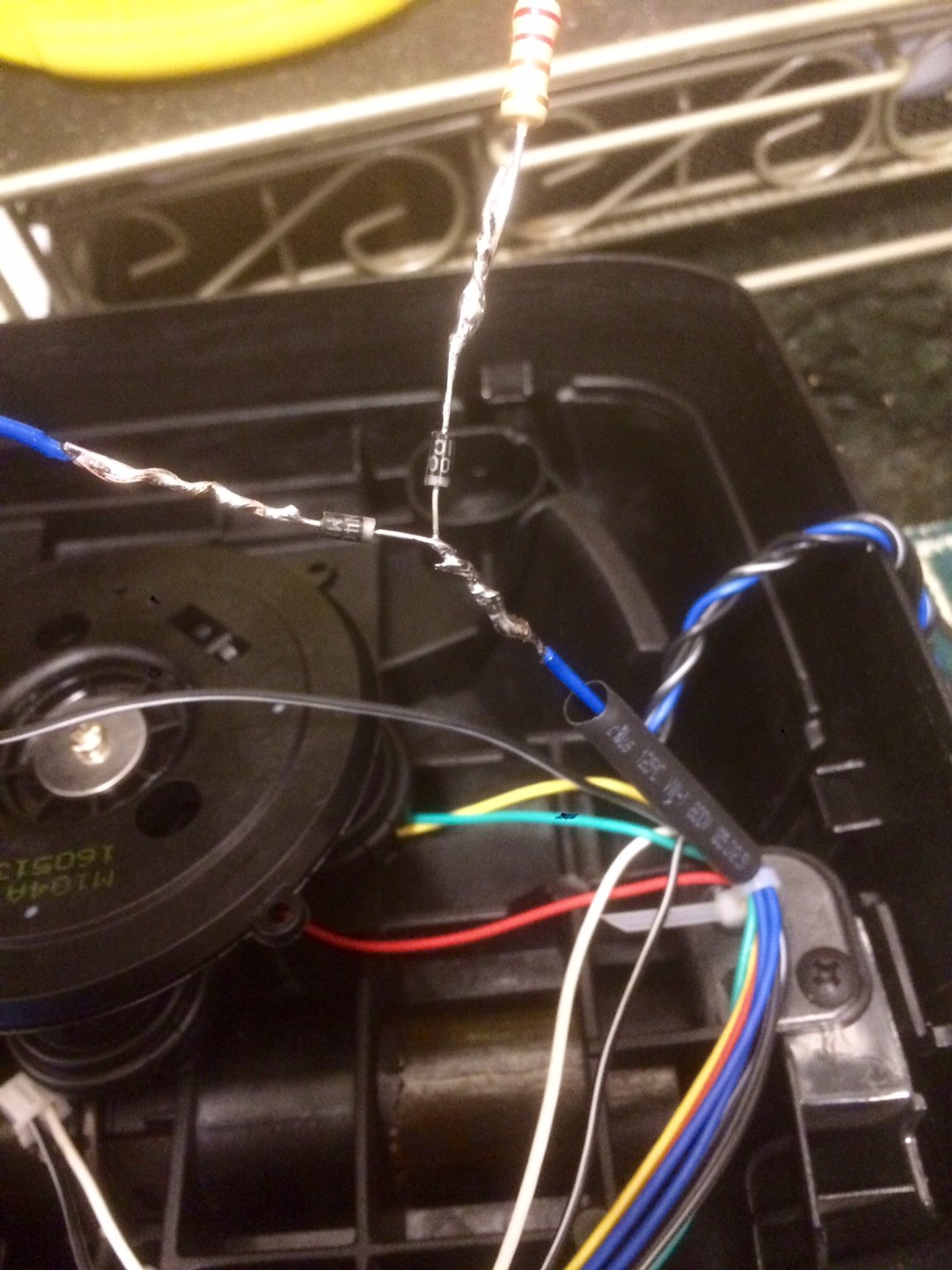

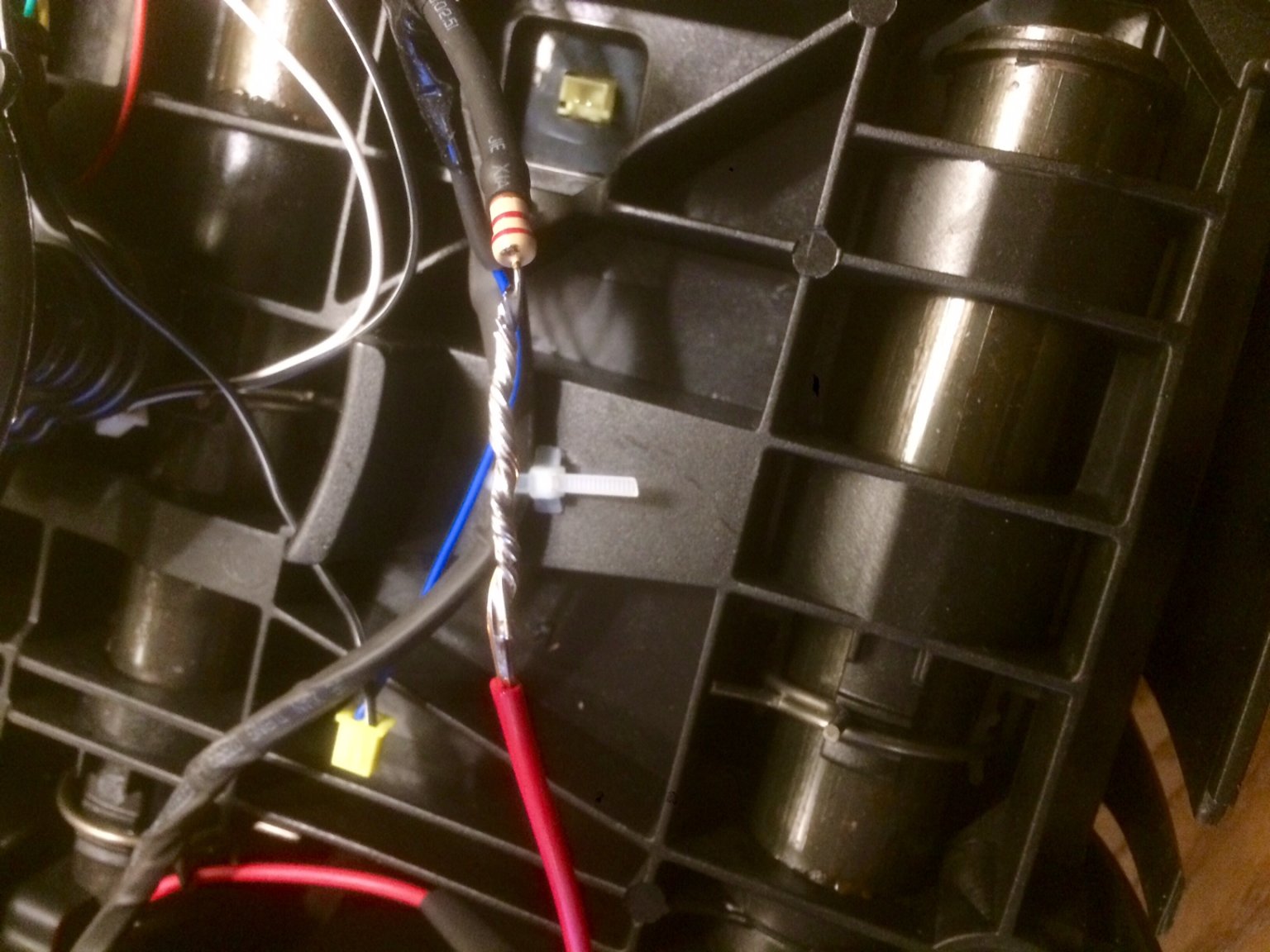

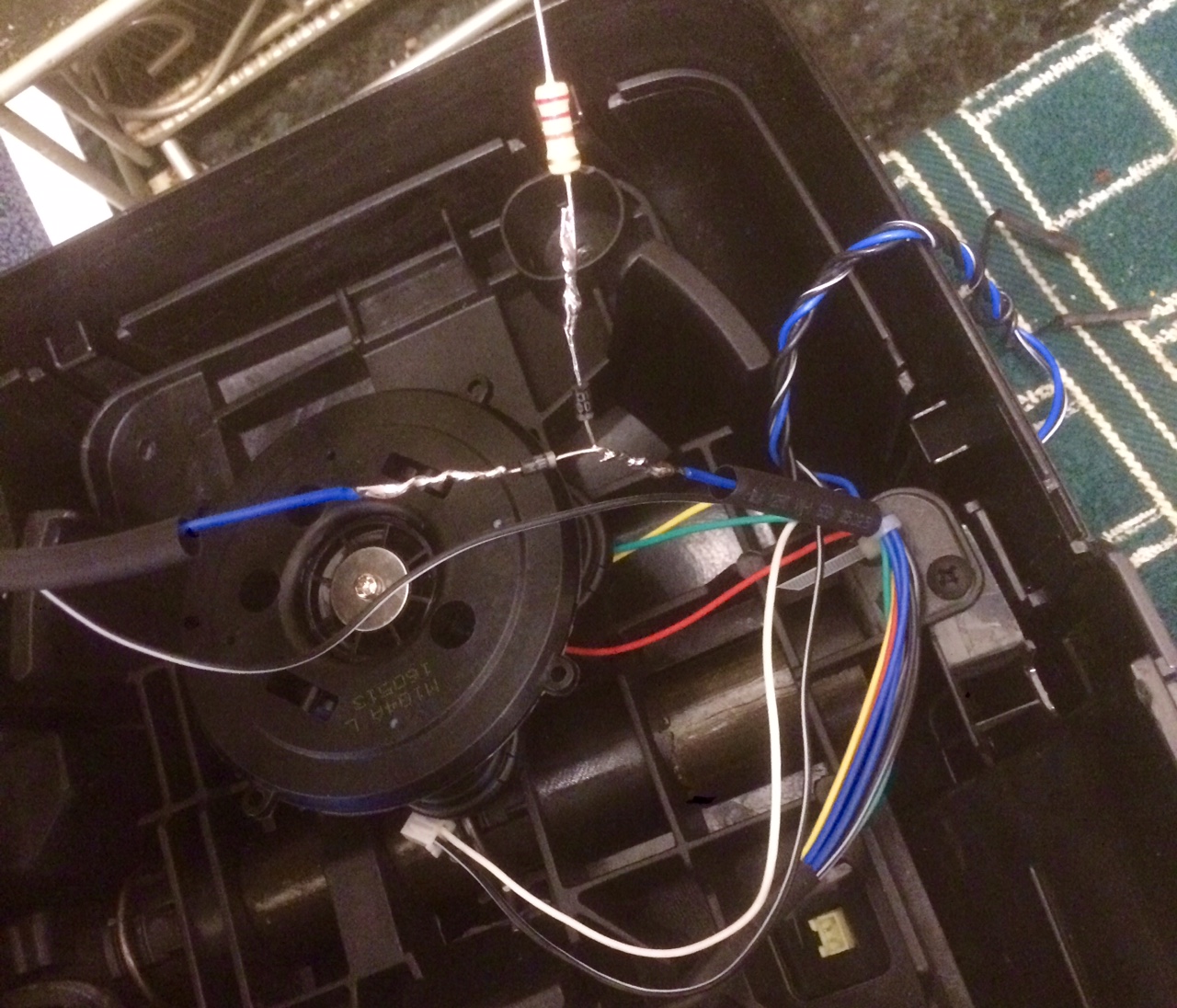

After reflowing just about every solder joint on the board, the PRND still didn't work for some reason. I decided to replace the blown out cluster bulbs on the cluster to blue LED's since i already had it out. I then began soldering a few diodes and resistors on the new tow mirrors i ordered so that i can have the front LED's on the mirrors work as DRL and Blinkers at the same time.
It was way too cold outside to wire up the tow mirrors today, maybe i'll give it a shot tomorrow before the super bowl. I took a few pics on how to re-wire/solder the tow mirrors up in case anyone else decides to get them...also took a few pics of my progress so far, it would be a lot easier if i wasn't hopping around on 1 leg and crutches
