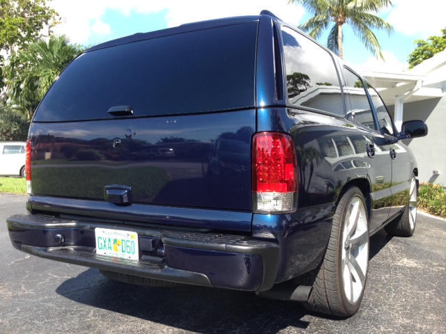

I think the picture labels of the first and second design back glass were accidentally reversed earlier in the thread.
NBS first design rear glass ↓
NBS second design rear glass ↓
I think you are correct here. My 06 has this style.

I think its more of a 06 thing, maybe just the very end of 05 had them. When i said first and second i meant in the order we were referring to them, not in order they were used. Sorry for the confusion.

i believe the supposingly 05-06 rear glass also came on some 03 trucks. i have been looking for another truck and came across 3-4 with this glass. they were all years 2003
