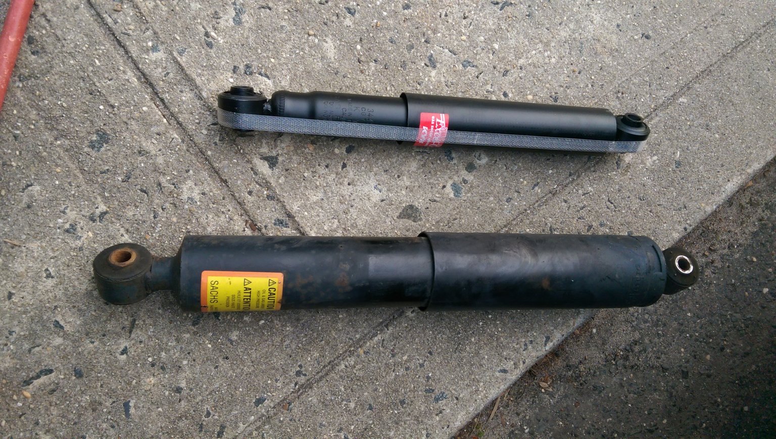

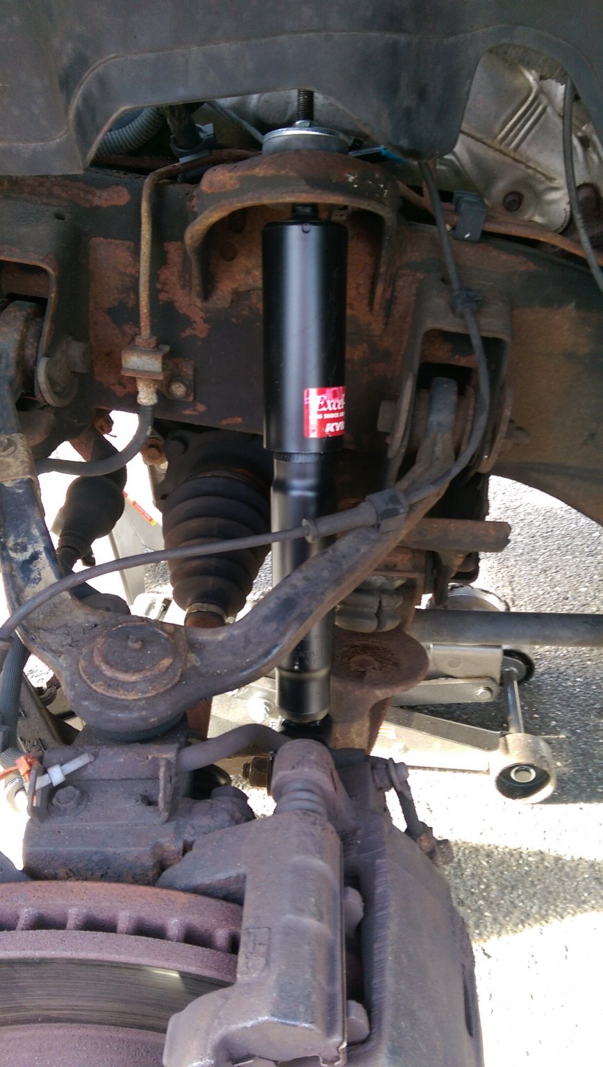

Did my shocks today. Surprisingly all the shocks we're still good. Front end used to wallow. Saw the passenger front bump stop is split. View attachment 71742Had stock shocks all around. Putting the KYB's in we're a PITA! Got them all in tho. Was too late to take it for a test drive to see if the ride improved. Hopefully it was worth the time, effort and money. View attachment 71743 View attachment 71744Look at the size difference. Length is the same, but check out the width.

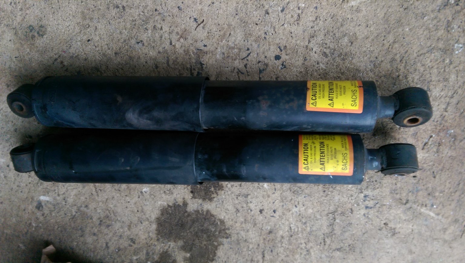

Btw- Anyone want the Sachs rear shocks? I'd hate to throw good shocks away. Fronts are a little rusty, but I think they're still good also. Free to anyone who wants to pick them up. Front and/or rears. Mailing would kill the free vibe. LolView attachment 71746
Your factory rear shocks look like Nivomat shocks. Do you have RPO code ZW7 in your glovebox?
I was able to unload mine on Craigslist for 200.00 with the matching springs, when I did my rear lift.

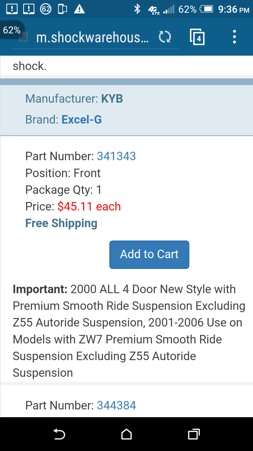

If I'm reading it right, says truck will sag if loaded. I don't really ever load it up, and the sag wouldn't be too bad in my eyes, since it sits higher in the rear then I like anyway. Now I'm just concerned about the handling with the new shocks.
33,200
51,446
Is it a softer spring that won't work well with the KYB's?
EDIT: I think/hope it'll be OK. Just looked it up on the site and it says I can use the Excel-G's with the ZW7 option. Keep your fingers crossed.
