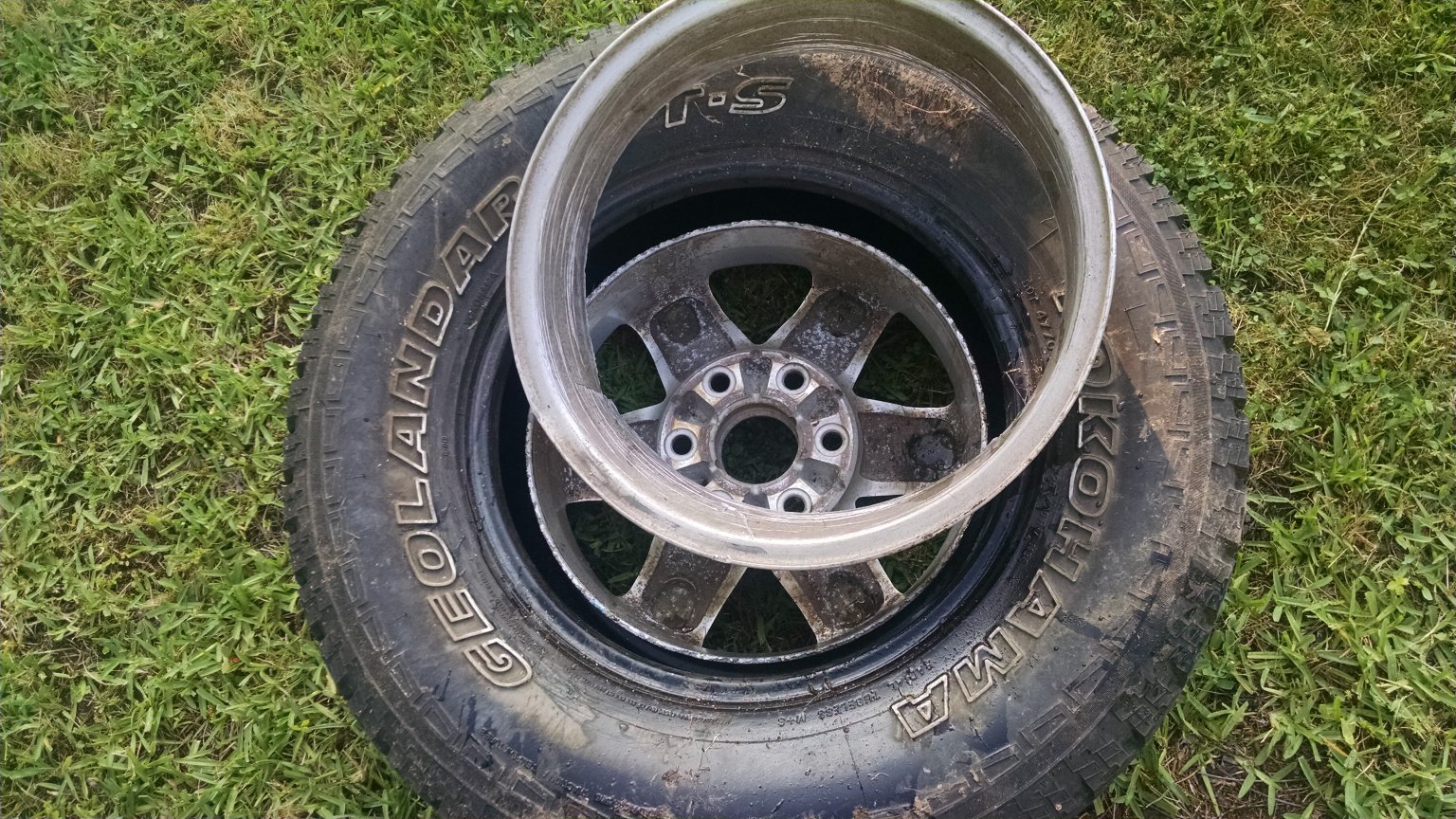

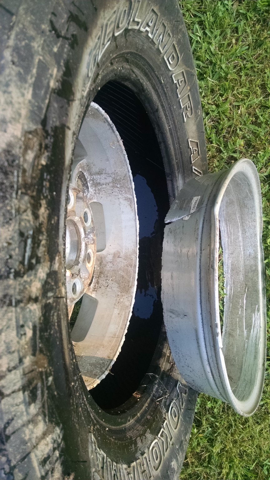

I had a similar situation back in April. I was driving back home from New Orleans, I was on the hwy dead in the middle of nowhere and I hear a loud PING sound and then a metal on metal scraping sound. I went to slow down and pull over to investigate, and as soon as I pressed the brake pedal my rear tire exploded! Then I felt the brake pedal immediately go ALL the way to the floor. I grabbed the steering wheel with both hands to maintain control. I calmly guided the truck off to the shoulder. I'm VERY lucky I didn't lose it, because having a blowout at 75mph AND losing the brakes, I could have easily fishtailed and flipped the truck. So anyways, after I calmed down the wife and kids, I get out and I see the wheel broken in half and sitting all crooked, the right rear shock bent to all hell, and brake fluid was EVERYWHERE!!! Once I got it jacked up and got the wheel off (what was left of the wheel) I saw what happened. A bolt in the brake caliper bracket vibrated loose and popped out, then the caliper pivoted on the remaining bolt and rubbed on the inner hoop of the wheel which ended up cutting the wheel open like a tin can. Then when the wheel "exploded", it busted the shoke and ripped the brake caliper hose. But thankfully a gentleman stopped to offer assistance, and he actually ended up giving me a ride over 30 minutes away to the nearest auto parts store to buy enough parts to get me back on the road so I could get home. I bought a new brake hose and banjo bolt, copper washers (which should have been 3/8" but they only had 1/2" washers in stock) new brake caliper mounting bolts and a bottle of brake fluid. I ALWAYS carry tools with me when traveling, so I was able to replace all of this on the side of the road with trucks whizzing right by. I rigged it up with the oversized washers and it held, I bled the brakes, and mounted up the spare tire and drove the rest of the 150 miles home wobbling on a busted rear shock. I fixe everything properly after I got it home and ordered everything from Rockauto. If that gentleman had not stopped and gave me a ride to get the parts, I would have really been screwed.
I'm blessed that I was both able to maintain control of my truck, and that this gentleman was in the right place at the right time to offer assistance to me when I needed it the most.

52,949
@ScottyBoy that's crazy how your wheel was cut in half! Glad nobody got hurt, that could have gone way bad. I'm thinking next time a wheel is off I'll be sure to check the caliper bolts!
ScottyBoy
Jun 27, 2010
2,684
2,035
Shreveport, La
YES! Anytime you have the wheels off, ESPECIALLY the rear wheels, check all the bolts on the calipers, and the caliper mounting brackets. And anytime you work on the brakes, use red Loctite when reinstalling the caliper bracket bolts. If you buy new bolts, they have thread locker already on the threads. I obviously had to replace the bolts on mine since one popped out.
And then I finally found a new wheel to replace the one that got cut in half. I honestly think this would have been a very minor problem had it happened just driving around the neighborhood. But with the caliper rubbing the wheel at 75mph, AND when I pressed the brakes to slow down, that caused the caliper to just dig into the wheel even harder and that's when I almost instantly heard the loud "BOOM".
I had a caliper bolt come loose the same way on a Honda Civic I used to have about 8 years ago. But I was driving about 25mph so it didn't cause any damage at all. I just bought new caliper bolts and replaced them and that was the end of it. On the Suburban, it was bolts, brake hose, banjo bolt, copper washers, new shocks, and a new wheel and tire. I ultimately ended up replacing the pads, socks and the hoses on both sides just to be sure everything was safe to take my truck on road trips again.
