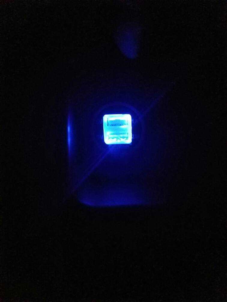

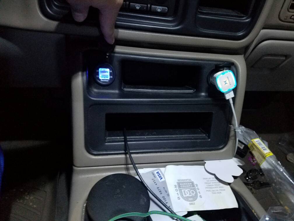

So I was looking at some pictures on here and wanted to get rid of my cigarette lighter and decided to put in a usb instead. As I looked on ebay I saw this. I have a Samsung Galaxy s7 edge so I need 2.1 amp for fast charging. And the wife needed the regular 1 amp. So I got this. Installed quick easy and painless. Recommend.

That's nice. You have a link?

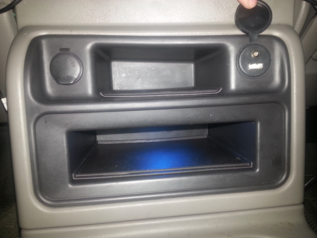

Thanks for the idea. Gonna replace my factory cigarette lighter on the left now. ;)

How was the install? Plug and play?
No plug and play but close. I cut the plug off as I wouldn't use the cigarette lighter anymore. So I just snipped it off and added the female connectors that came with it and done. The plastic piece just pulls right out. Held by pressure clips.
