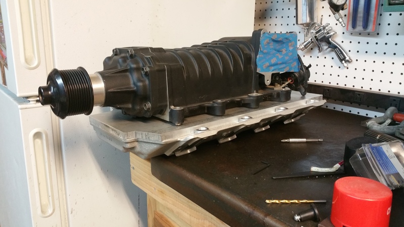

Worked on this goofy thing today. It will be on my truck soon :)

It's all kind of a bastardized deal, lol. The supercharger is off a Shelby gt500. You can find them pretty cheap because the Mustang guys upgrade to bigger ones. I'm using a Magnuson manifold with a top plate that I'm making. I have about $500 in it so far. A guy I work with just did a lot of upgrades on his Cts-v, and he's giving me his stock balancer and injectors. The cts balancer has a 10 rib blower pulley, so I'm going to position the blower out far enough (or go to a different offset blower pulley) so that it has its own 10 rib drive and I'll still have the stock accessory drive on my 5.3. There's no room for an intercooler right now, I've thought about just running meth injection. I do have an intercooler, and a lot of phenolic material, so I may make a spacer to move the top plate up so the intercooler will fit inside. It's all just mocking up right now.
In the long run it might cost more than just buying a kit, but I doubt it as most of them new are around $5-$6k. I just wanted to see if I could build it myself. :)
