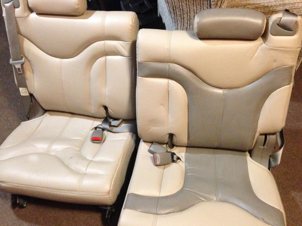

Started the 3rd row 2-tone project.
Still needs a few more coats, especially at the seams.....so don't judge yet

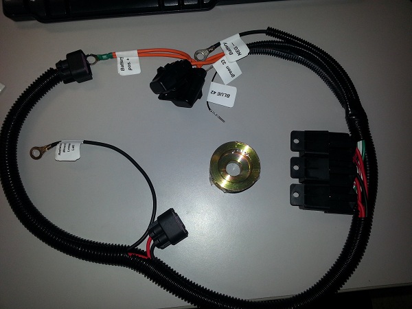

Well I technically didn't do anything to mine, however my Electric fans, harness, and pulley came in. I ordered the Dorman 620-653 electric fans. The harness and pulley came from LS1fans.com. Hopefully this weekend I can get them put on.

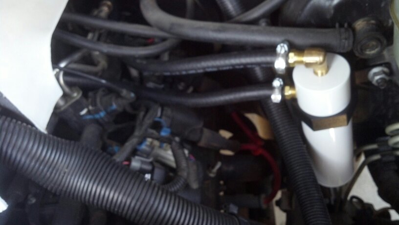

Stupid question.....what purpose does the catch can serve?

Burb.. I was reading up on then 2 months ago on Norcal SS' s page. I guess they are a must on our 5.3. Motor creates a lot of crank moisture.

Yes a Catch can helps. I have one.

X2 if that's gonna help the engine I'd like to get one and if anyone has a how to install that'd be great too.
Buy this --> http://catchcans.com/can1.html then go to your local napa or whatever you have in your city and buy 5' of 3/8 fuel line and hose clamps to go with them (4). Take off your old PCV line. The one that goes from your drivers side valve cover to your intake manifold. Then measure and cut a line that will go from the vavle cover to the top of the can. then one that will go from the side of the can to the intake manifold. Then put the lines on and tighten down.
