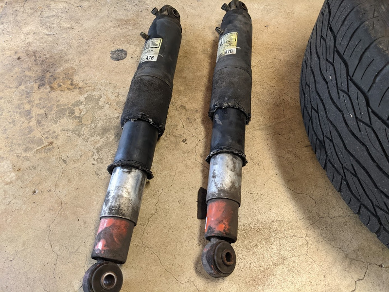

Does Arnott buy these and/or the front electronic ones as cores even if you didn't buy their rebuilt units?
The last I heard, and this was 2-3 years ago, is they had plenty of cores and weren’t buying them. Just accepting them as core returns when you buy new ones. I’m guessing there were plenty of the OEM ones that were failed. Now, if you have some off a Mercedes Maybach, they want them for sure!

Sweet, $50 for NNBS Z55 rears! They’re buying them again. Those Maybachs for $500 core though…I just checked RA and those struts are $2500 reman and they charge $1000 core.

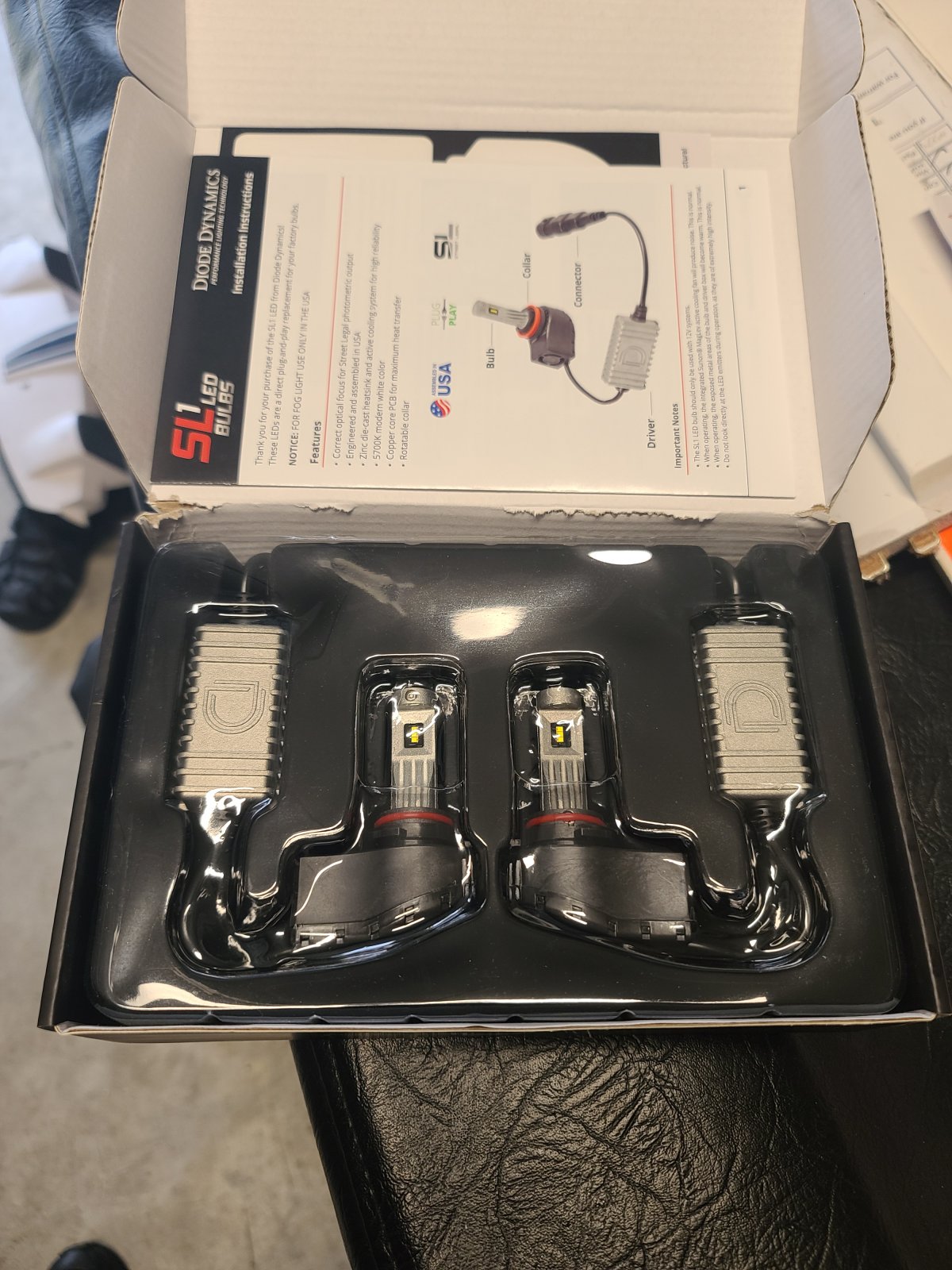

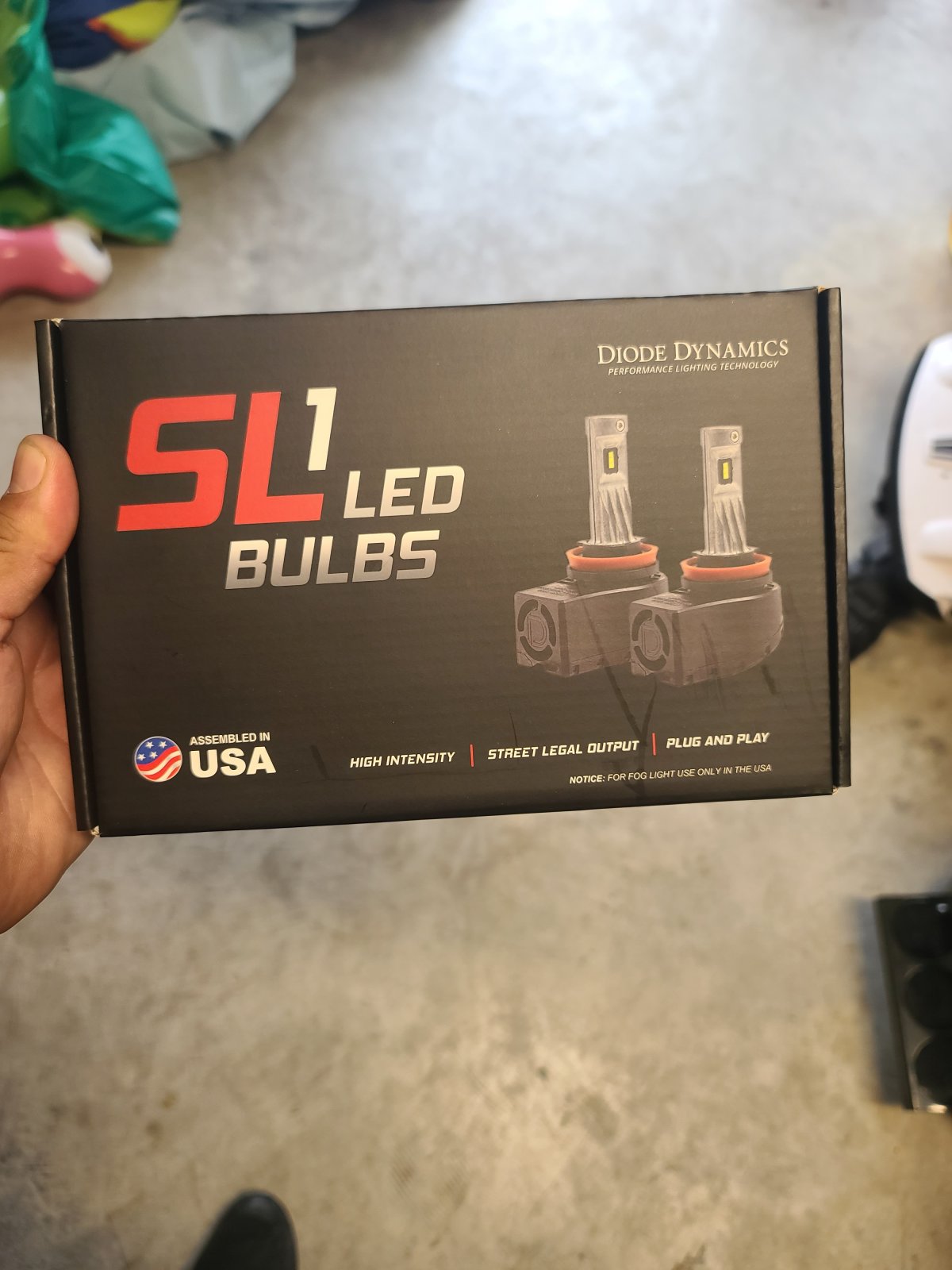

Got those for the front low beams in the mail just now. 3 yr warranty and made in the USA. Had to try them out after I saw the display and online reviews. Waiting till dark for final thoughts. Was previously on some garbage Sylvania bulbs that came with my Depos
Make sure you align them vertically. They should have a set screw to do this so once they’re twisted in place they’re as close to vertical as possible. It’s important, that will insure the best light output.
??? Dumb this down for me. Set screw on the bulbs? Damn I should have read the instructions
52,949
Both sets I installed had tiny set screws, I loosened them and the led could be rotated and then the set screw got retightened. Look at the bulbs. If they look like they’re not vertical, you need to do this. When this guy from TRS says 3 and 9 o’clock he’s talking about the leds themselves. The bulb should look like an “I” .
I appreciate your knowledge and input!!!! Thanks
