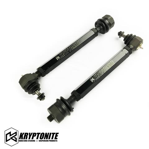

For tierods, you can't beat Kryptonite. For UCAs you just need to ensure you get the highest quality replacement, either OEM or MOOG problem solver IMO.
For ride quality, if you haven't done the free travel mod I'd do that and ensure nothing is limiting suspension travel front or rear. Or if you want the ultimate ride quality I'd say go coilovers in the front.
https://kryptoniteproducts.com/coll...oducts/kryptonite-death-grip-tie-rods-1-2-ton

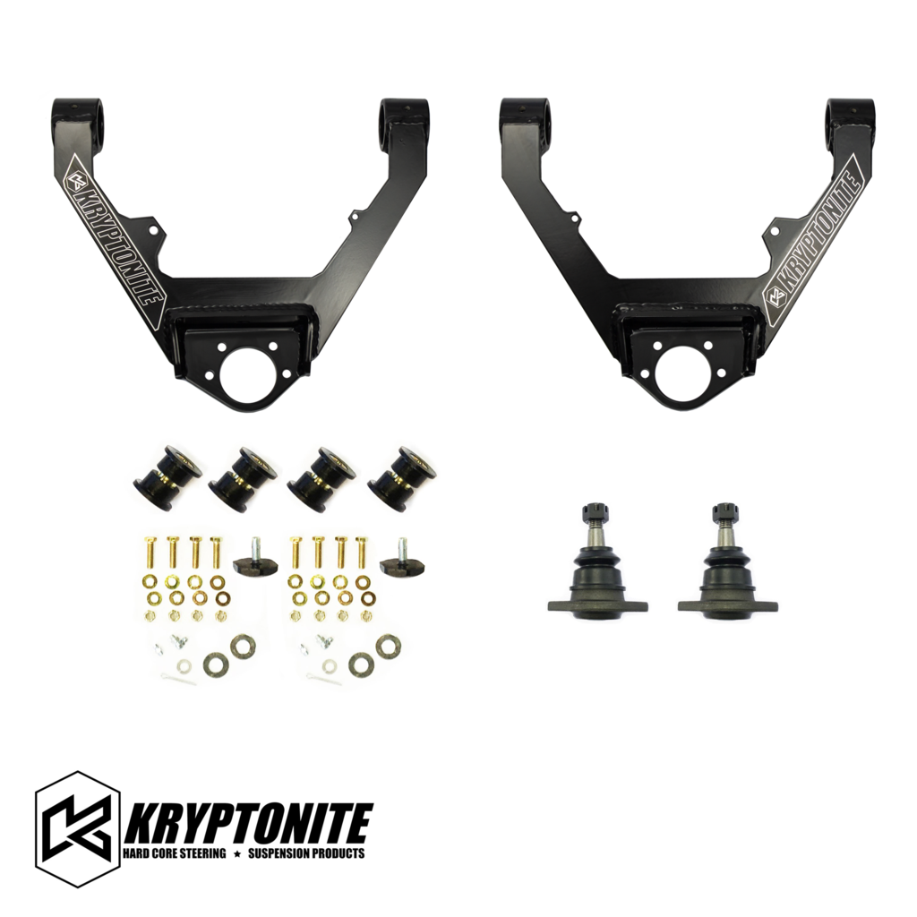

Being careful on install may help the boots last longer, I hope my Moog PS UCAs last a while, if not I did notice that Kryptonite is now making UCAs for these trucks and they look badass! They have a set of leveled trucks or regular height, not sure if the Belltech alignment bushings would fit them or not. If My UCAs wear out again I will likely move to this option.
Also kryptonite has pretty nice poly boots instead of rubber.
How much are those beauties? Damn.
I also didn't realize the tie rods were $350ish lol.
Idk how much more money I want to put into this thing

I think the UCAs were $600 which is about double the cost of Moog PS series. But they look cool and I have no doubt they will last a long time.
I get not wanting to dump a bunch of money into an old rig

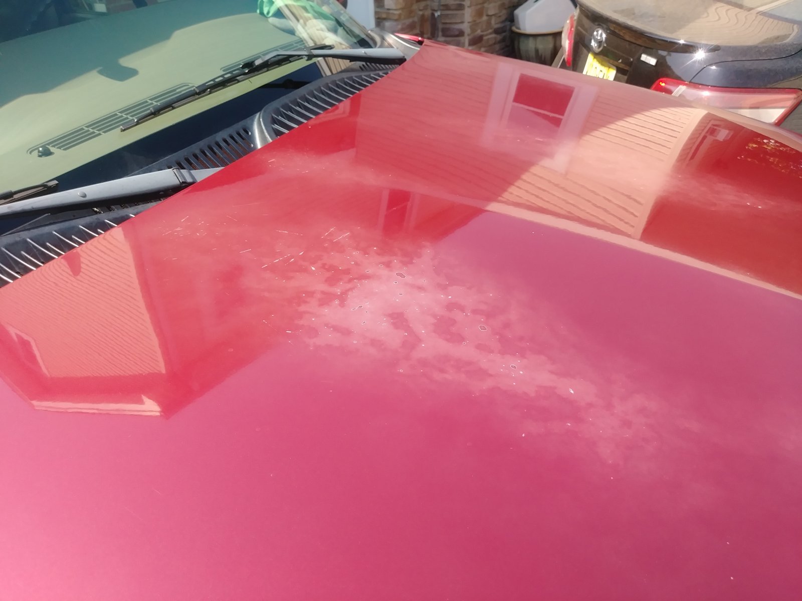

washed my dirty hoe. for real its been 6 months since its been washed. i do feel a bit bad for it. pic does it no justice on just how dirty it was.
cleaned up and some adams h2o on it. at least it shines again.
hoods got some messed up paint, time to get some SS decals or something to hide that crap.
then because it was just flat out killing me to drive the work truck, i gave it another mercy washing, damn thing actually shined up. no adams on this. hell didnt even dry it lol wish i had a before pic. it was so dirty it was almost brown looking.
