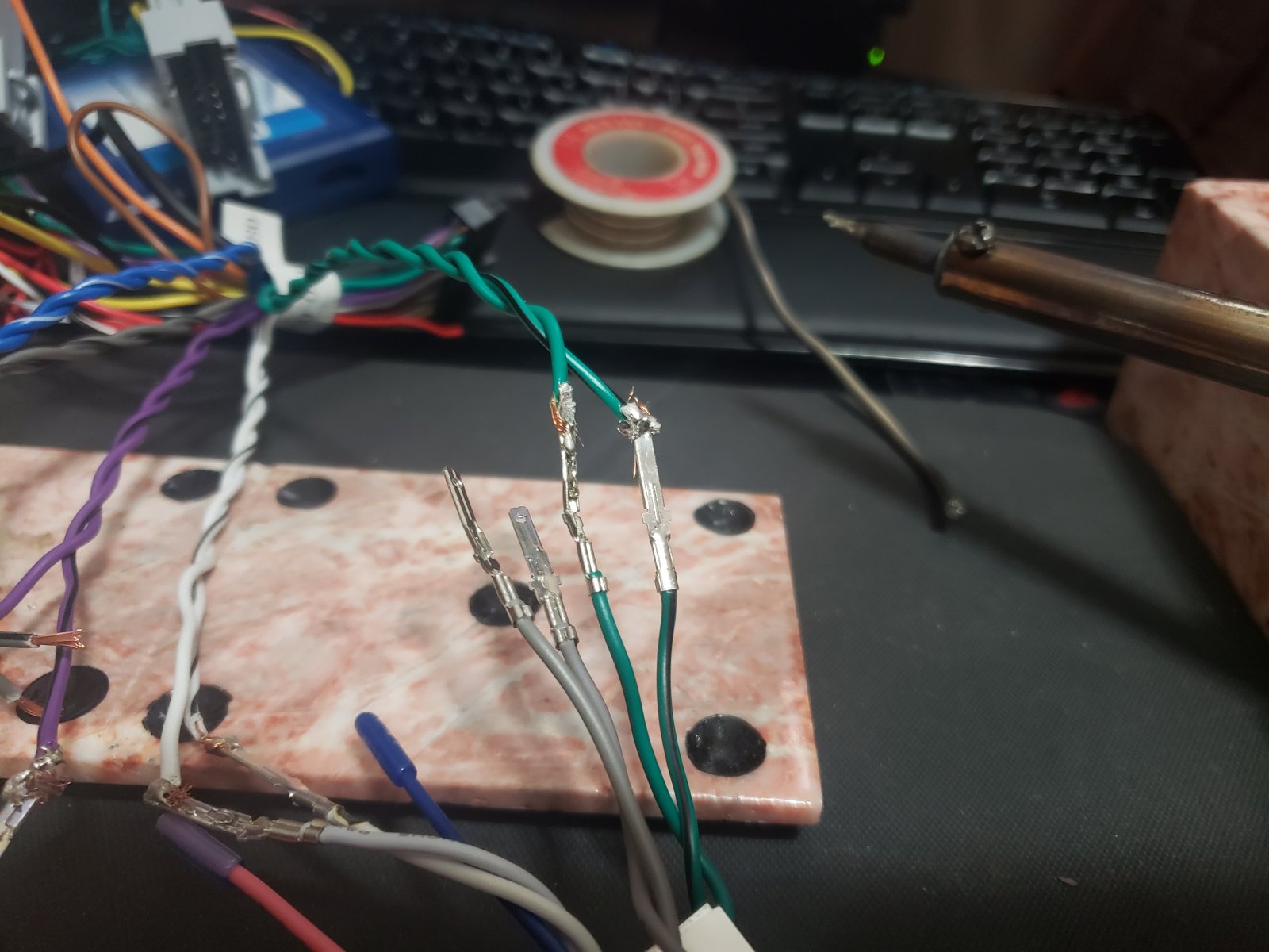

Soldering some speaker wires for this new android radio. I feel brave because I think I know what I am doing. Lol
52,949
Soldering some speaker wires for this new android radio. I feel brave because I think I know what I am doing. LolView attachment 249405
You should cut those connectors off, strip the wires and make sure there’s no “stragglers” sticking out. Then use heat shrink tubing on them instead of tape. When you solder and there’s individual strands sticking out like that, the solder flows onto those and make them stiff so when you wrap them with tape they can pierce through and cause shorts. All it takes is two tiny strands touching each other and it’s a short.
I'll definitely do that, I'm just impatient. Still figuring out how to wire all of this. Ordered shrink tubing and plugs. While I wait let's see if this works lol
