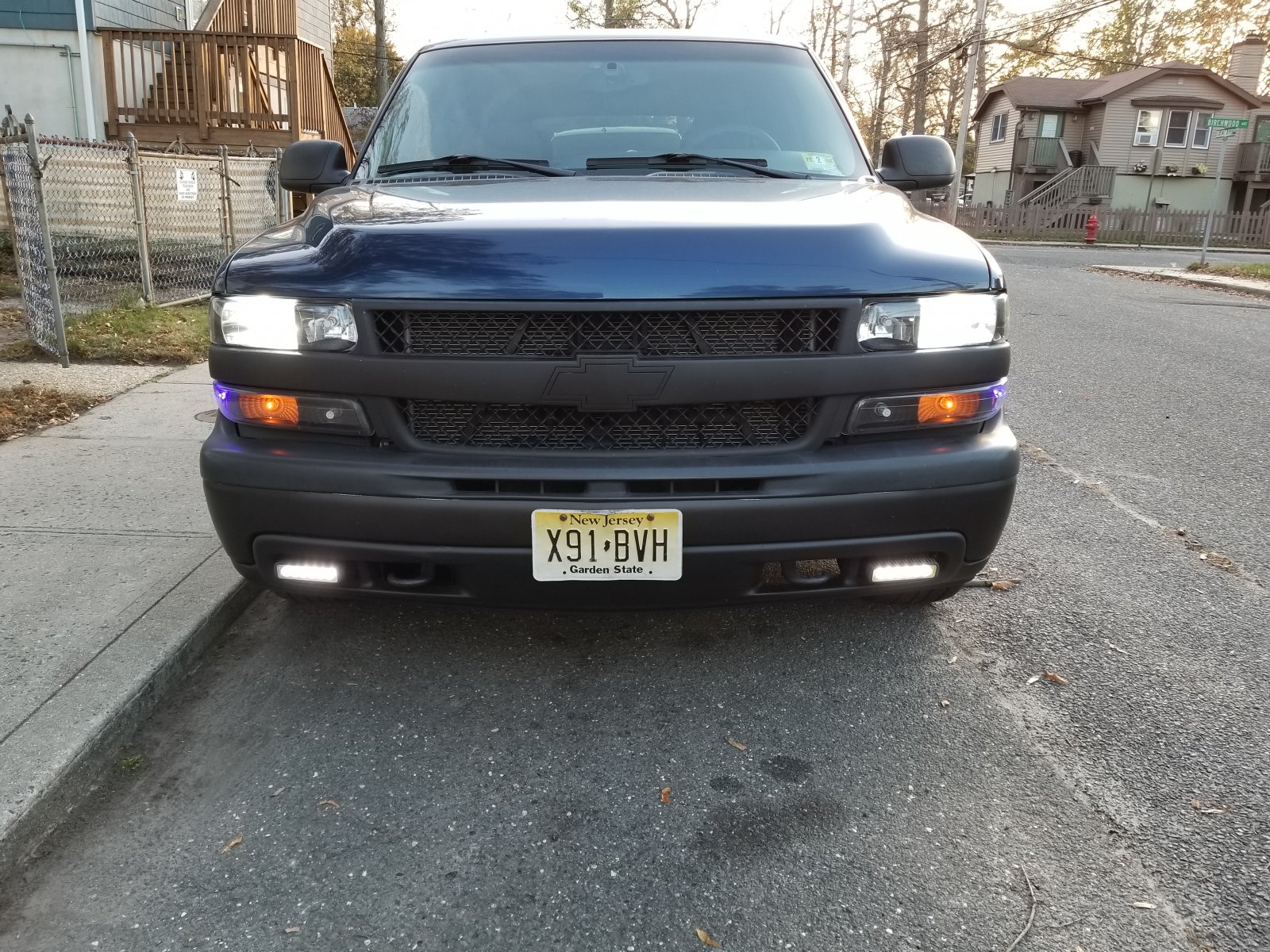

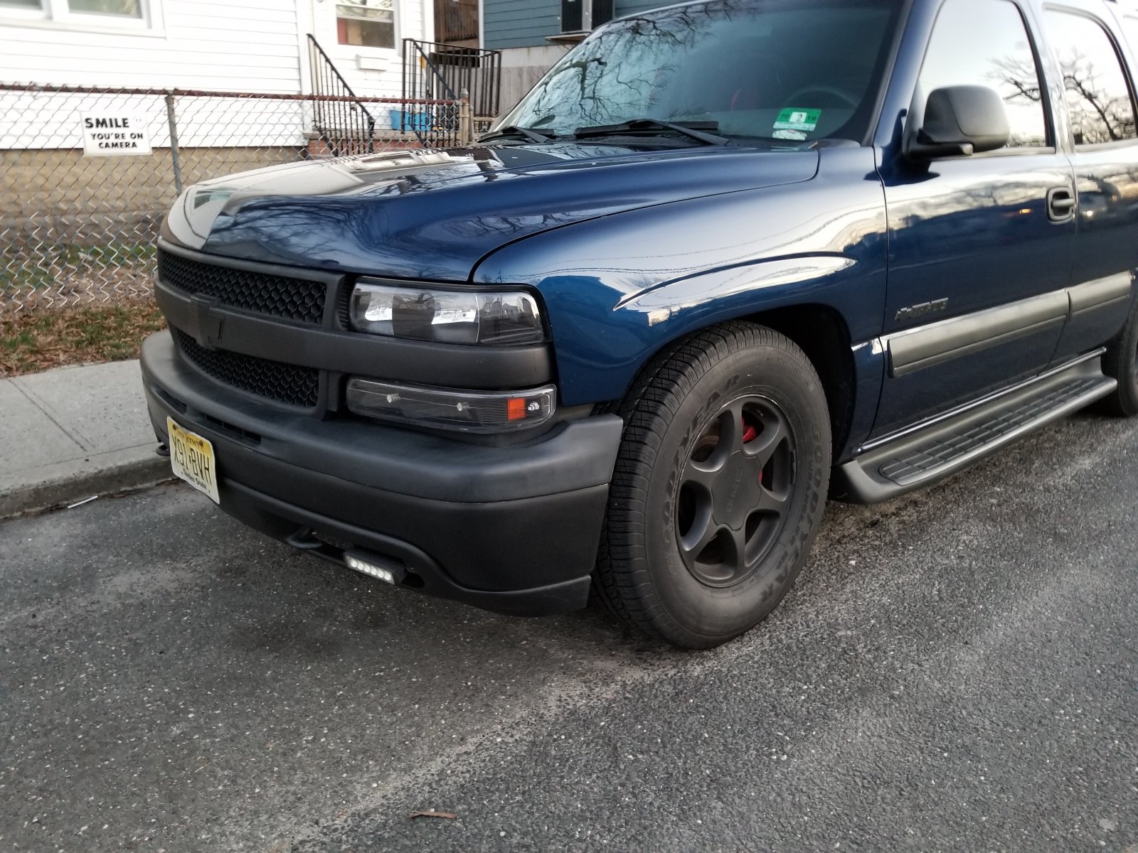

You are correct about the donor years. I did the swap to my 03. I just did the HD hood and grill--no cap. I did trim about 1" from the bottom of the grill, and a mounting tab from behind the grill.
I have kind of a how-to on my build thread.

You are correct about the donor years. I did the swap to my 03. I just did the HD hood and grill--no cap. I did trim about 1" from the bottom of the grill, and a mounting tab from behind the grill.View attachment 245795 View attachment 245796

Honestly I never thought about it. I guess it would depend on how thick that upper pad is, for it to get that 1" you need to cut off the bottom of the grill--for everything to line up.

The HD cap is not lower in the middle like it appears. Its actually taller on the sides. Very deceiving as I thought I could fit the grill as long as I did the HD cap at the same time. I was wrong and ended up dropping the bumper 1.5".
