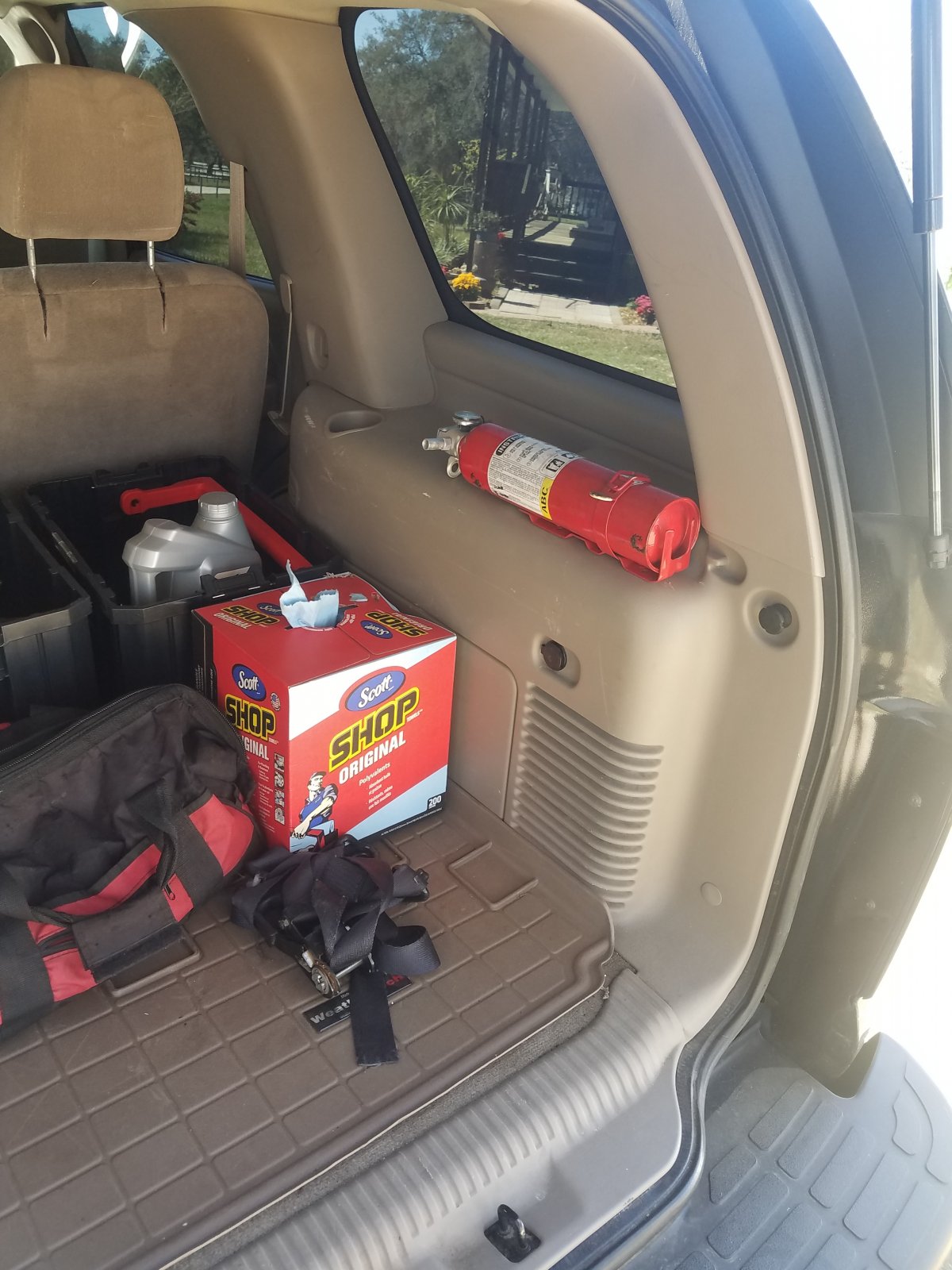

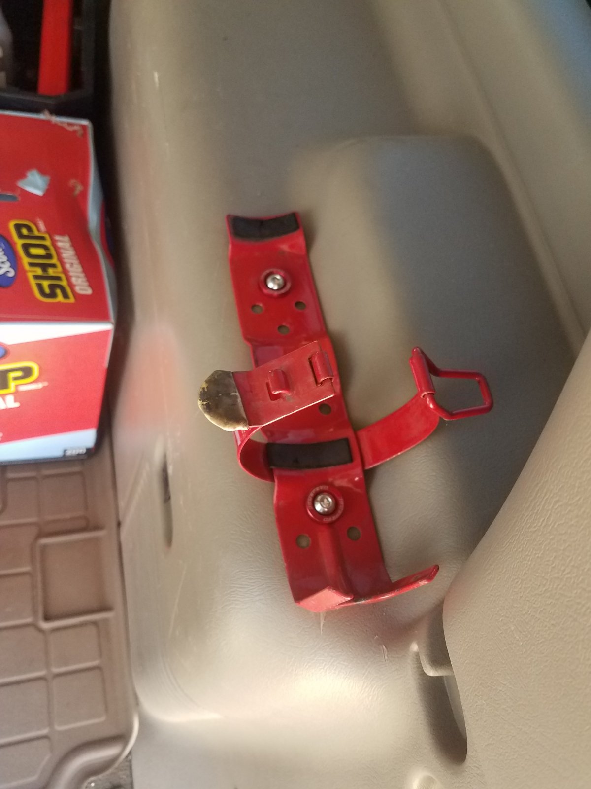

I always keep some tools in my rides and usually a fire extinguisher just incase. Before I had it sitting in one of my tool bins making it hard to find and get to during an emergency. Dug up the mount in my parts bins and rivnutted it to the plastic. Looks simple, easy to get to and it doesn't rattle.View attachment 241908 View attachment 241909 View attachment 241910
Rivnuts hold ok in the plastic? I'd be afraid of it becoming a projectile in an accident. Better than rolling around on the floor of course...

When I grab the bottle or the plastic panel and shake there is no sign that the plastic will fail. The extinguisher does not shake at all honestly I'm impressed with the single clamp on the mount. Only time will tell of course but so far so good.

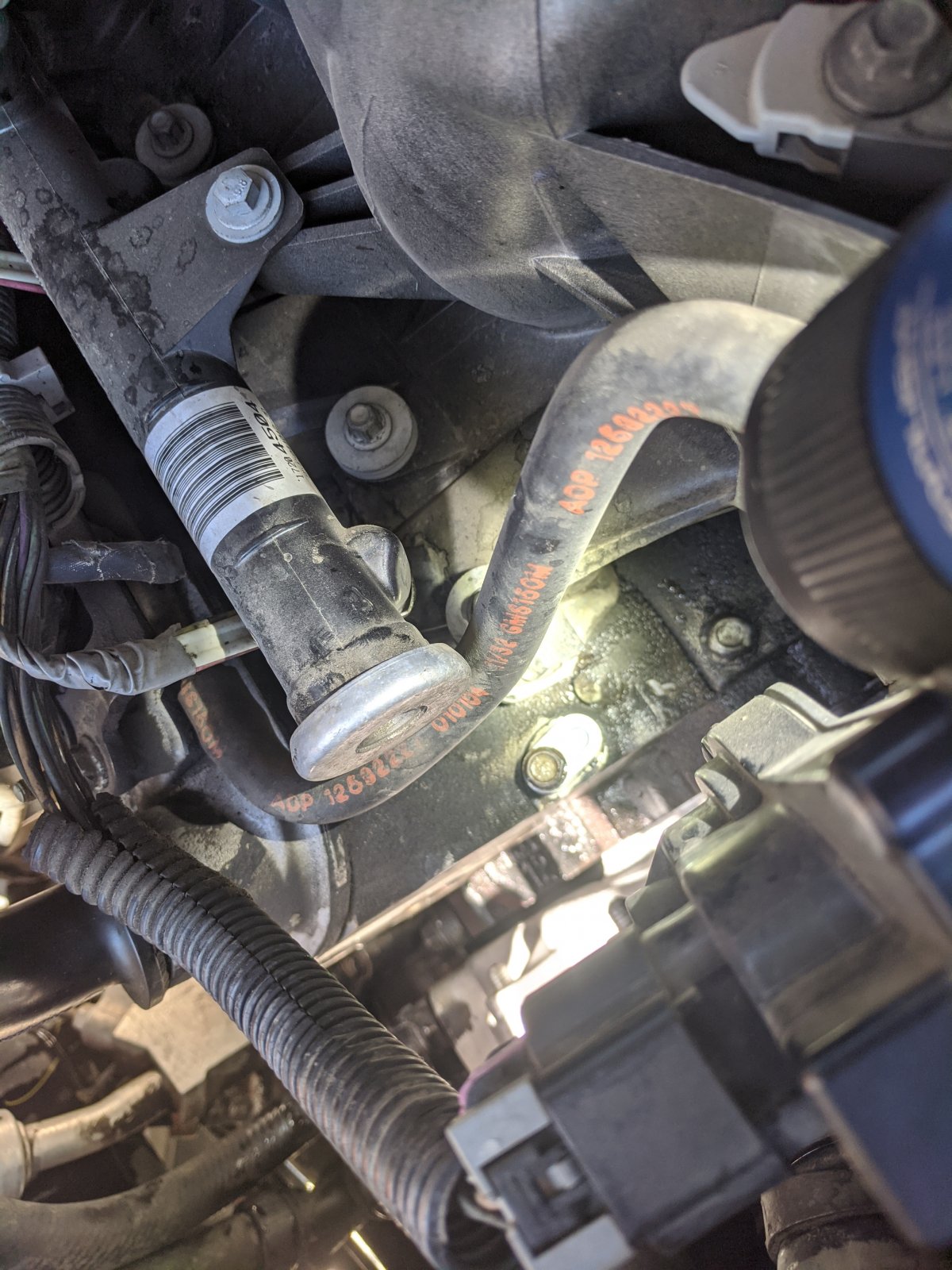

Crossover pipe delete
30,566
48,045
a couple of years or maybe 1 year not really sure have a coolant line that runs thru the throttle body (supposedly to help with idle when it is cold out), and most years also have the front and rear coolant crossover "steam" pipes that run coolant thru the heads. so on my old lady's 04 that throttle body coolant line has a "T" that goes from the throttle body to the crossover pipe, hers was leaking either where the hose clamps onto the metal line or where the o-ring is where the line enters the head, the dealer no longer sells the line or the o-ring's and they now sell a cap to cap it off, I could have got the o-rings at the autoparts store but I just said screw it and used the caps and capped off the coolant line from the radiator also.
the internet seems to be in a toss up as to whether or not the pipes are needed, I may just go ahead and order a dorman pipe and hook it back up and just delete it from the throttle body since it's cheap enough

30,566
48,045
Coincidentally, I drove 210 miles to get those damned O-rings between yesterday and today. Stores online wanted $6-$8 each, NAPA wanted $0.99.
I just ordered the dorman replacement pipe it was $47 shipped from rockauto, the old pipe didn't look so hot, I was just going to just leave it deleted but it gets hot here in Cali don't need more issue's on top of the noise it's decided it wants to make now.
45,012
I know they decided the rear ones weren't necessary and so they made the block-offs. But, I can't imagine them deleting the front ones.
That crossover through the TB is some BS. You know how they fixed it in the newer gens? They simply angled the TB a hair so any moisture that may be around the throttle blade won't collect on the blade where it could freeze.
