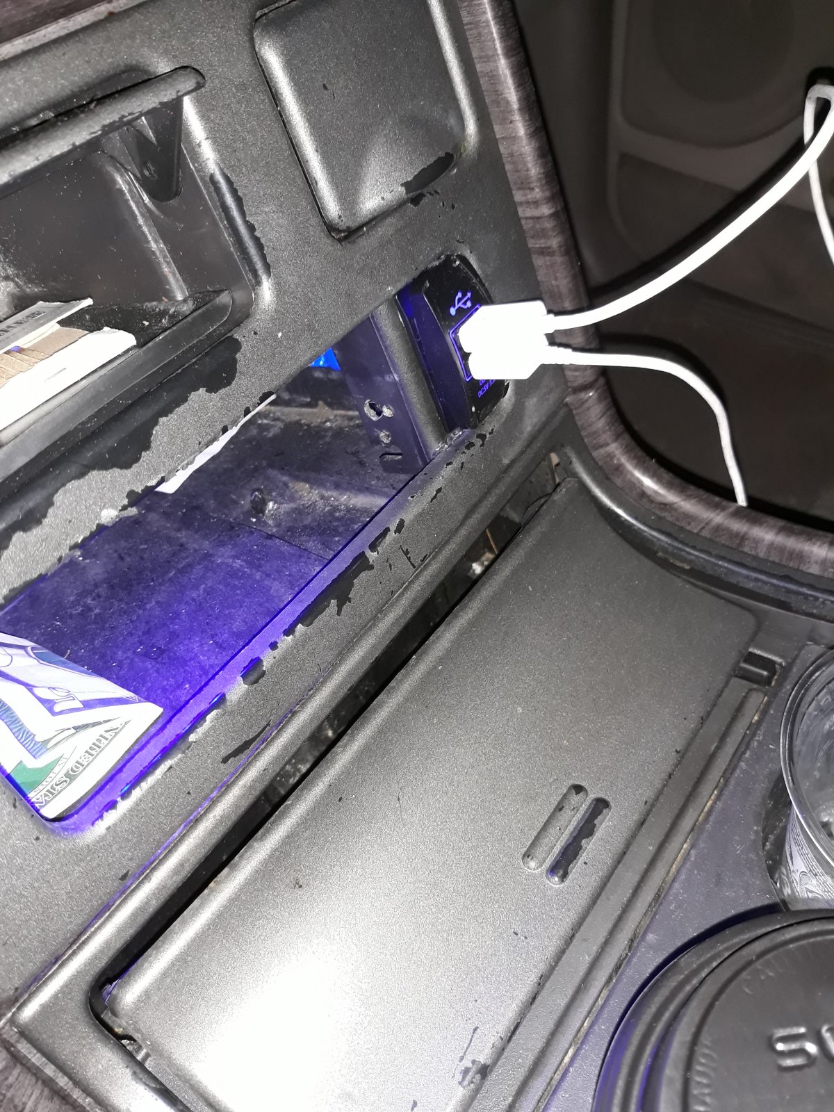

druiddonn
Oct 3, 2015
112
128
I added a USB port and toggle switch for a small LED
Both are powered by the cigarette lighter

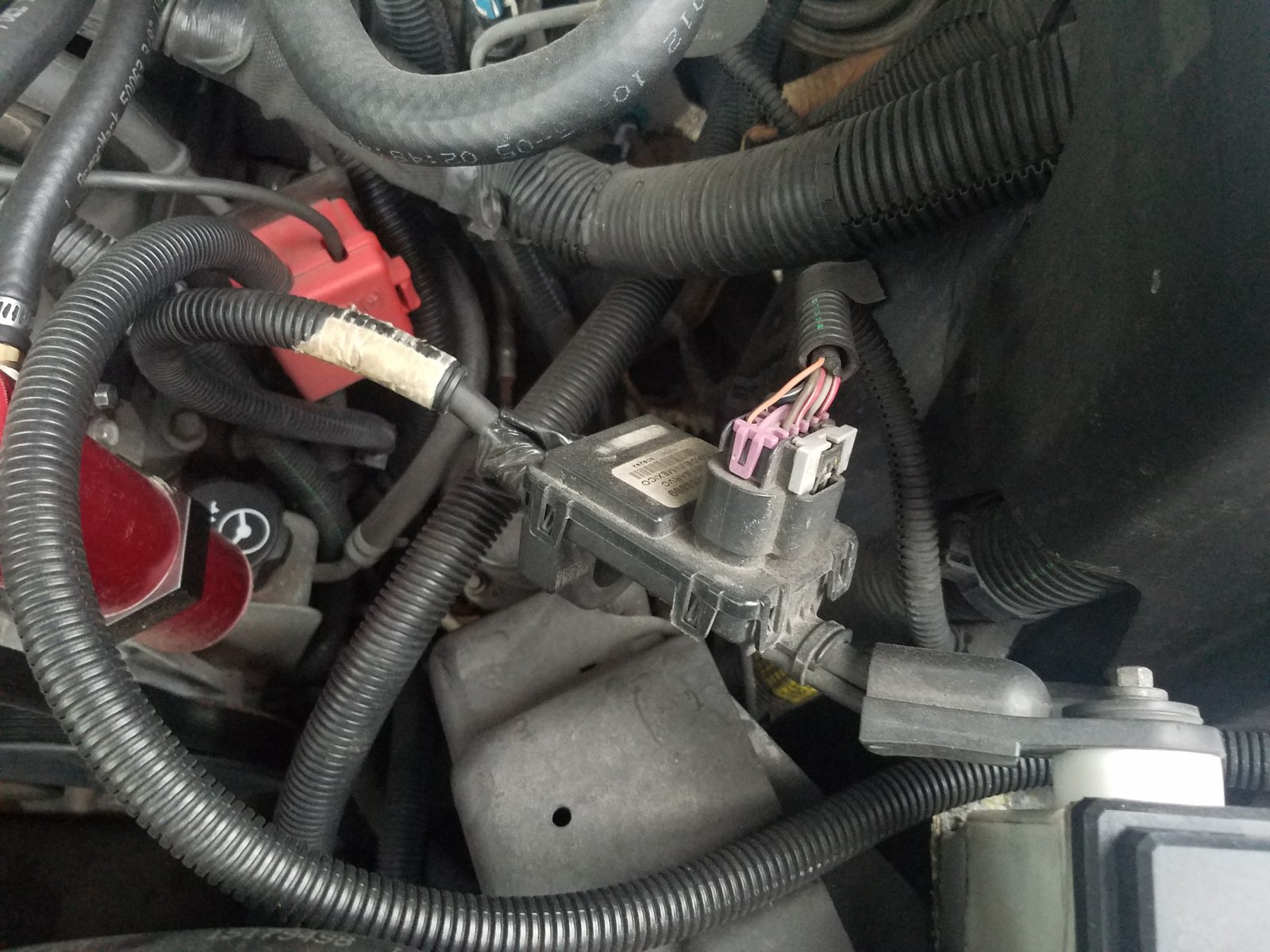

Changed front brake pads , mine were shot. Have an alt issue to figure out. Drops to about 12v on the gauge cruising down the highway but goes back to 14v on the gauge. Put the battery on the load tester at work and it shows 14v at idle.

What year truck? You may have rvc.
Edit: I just looked to refresh my memory. This is your 05? You may have it. Look for this on your negative cable....

Yes mine is an 05 and that is on my negative cable , plus I have battery light on the cluster also.
Not sure about your battery light, obviously...
But that sensor is the regulated voltage control. That's why your gauge goes from 12 to 14 and back wherever it wants. It's basically an amprobe that's deciding when / how much to charge your battery based on load.
Pull the codes? Have the battery tested. getting 14v @ battery while idling indicates your alt is likely working as intended. Try testing it when hot though, sometimes issues don't show up til you get some heat in the alt.
I had a optima battery that I was getting a battery light on the dash from. 14v @ idle. Always started no problem. I had the battery tested and it was failing the test. Some bad cells. Optimas are not what they used to be....

I get no codes for the alt , just a camshaft position sensor code. I have the red top optima out of my race car in it. Maybe its the battery , I'll test it tomorrow at work.
