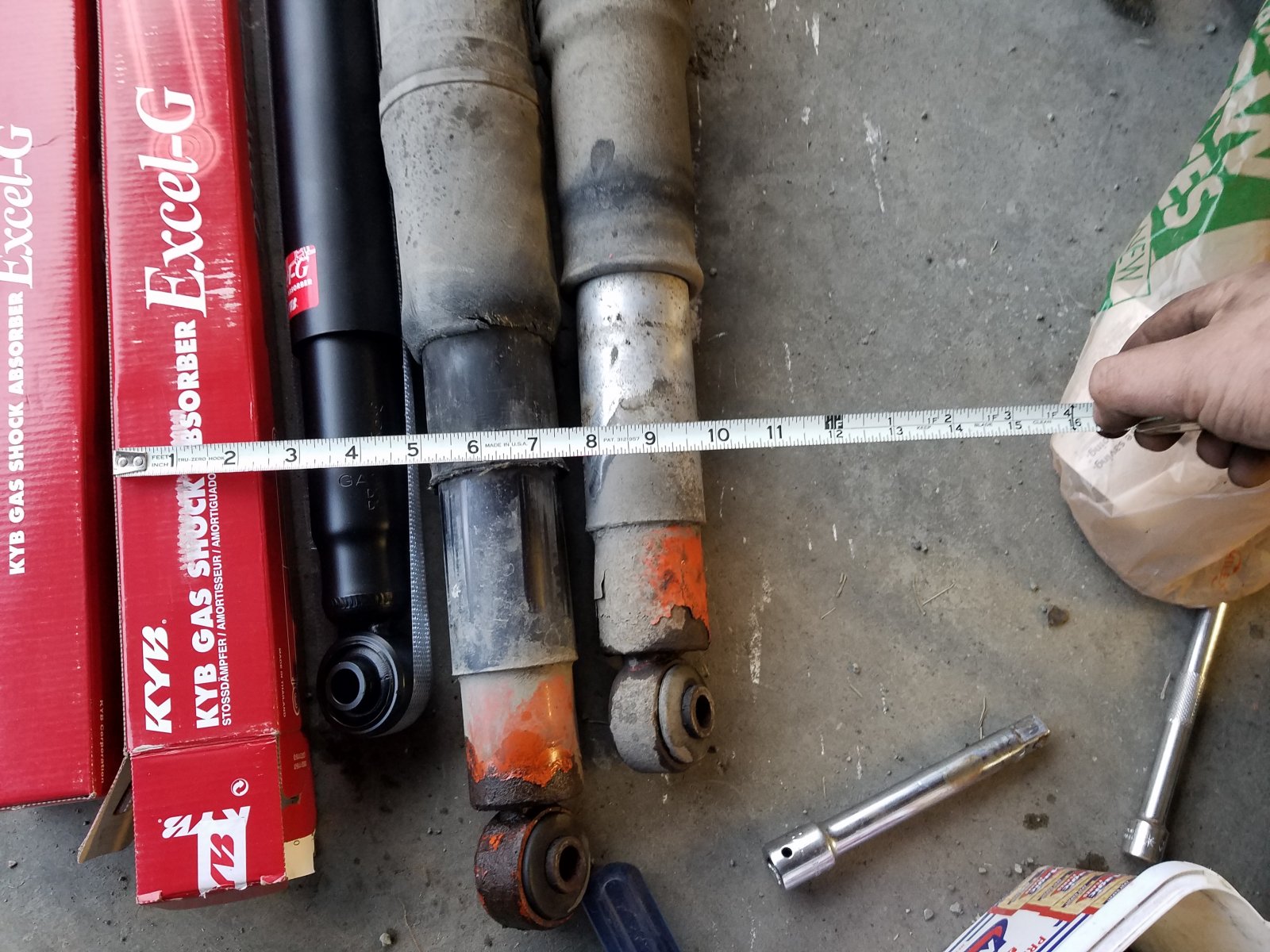

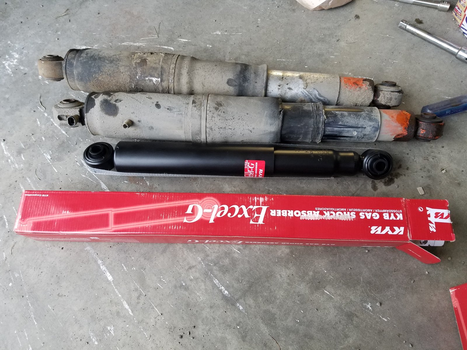

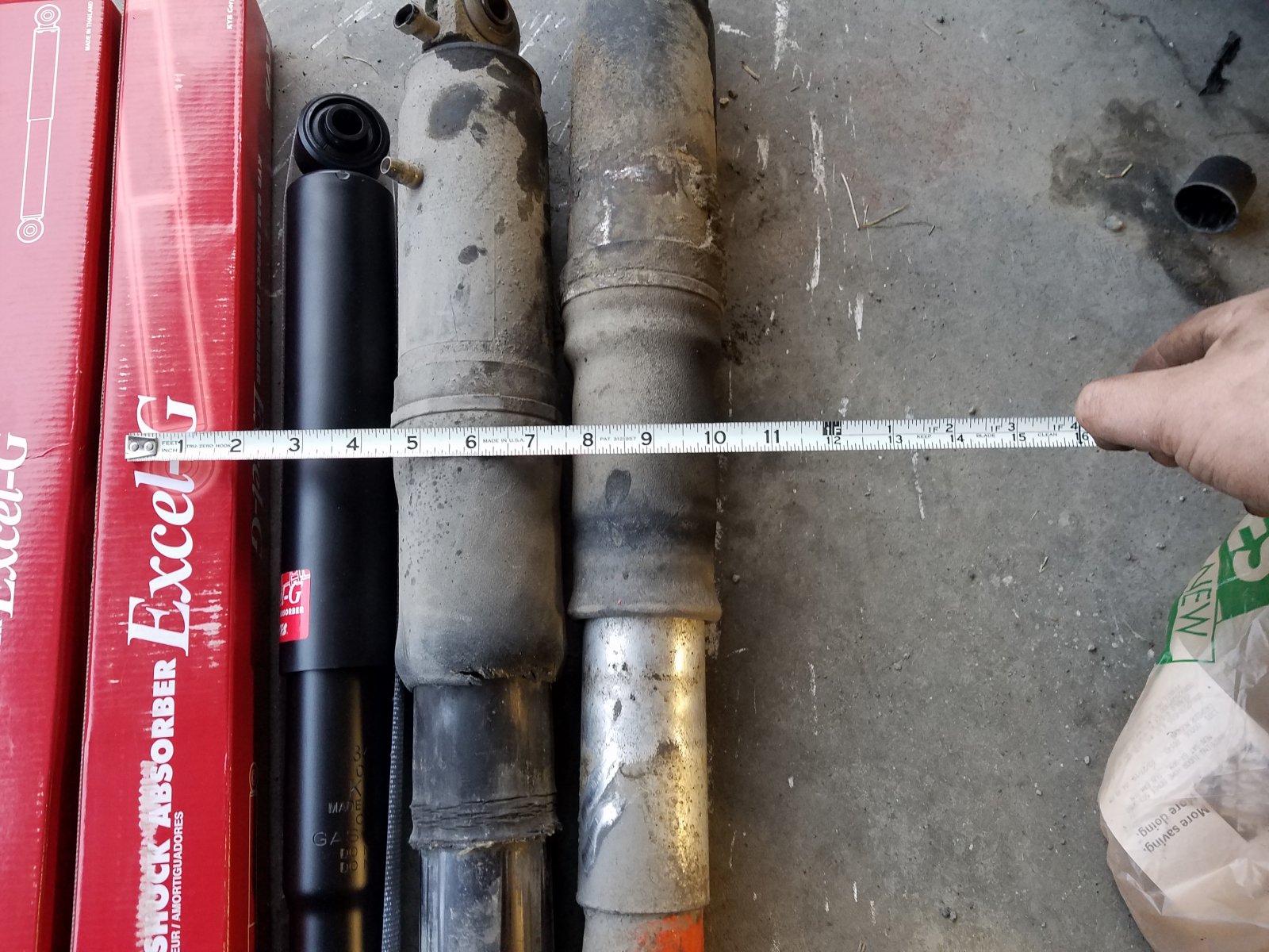

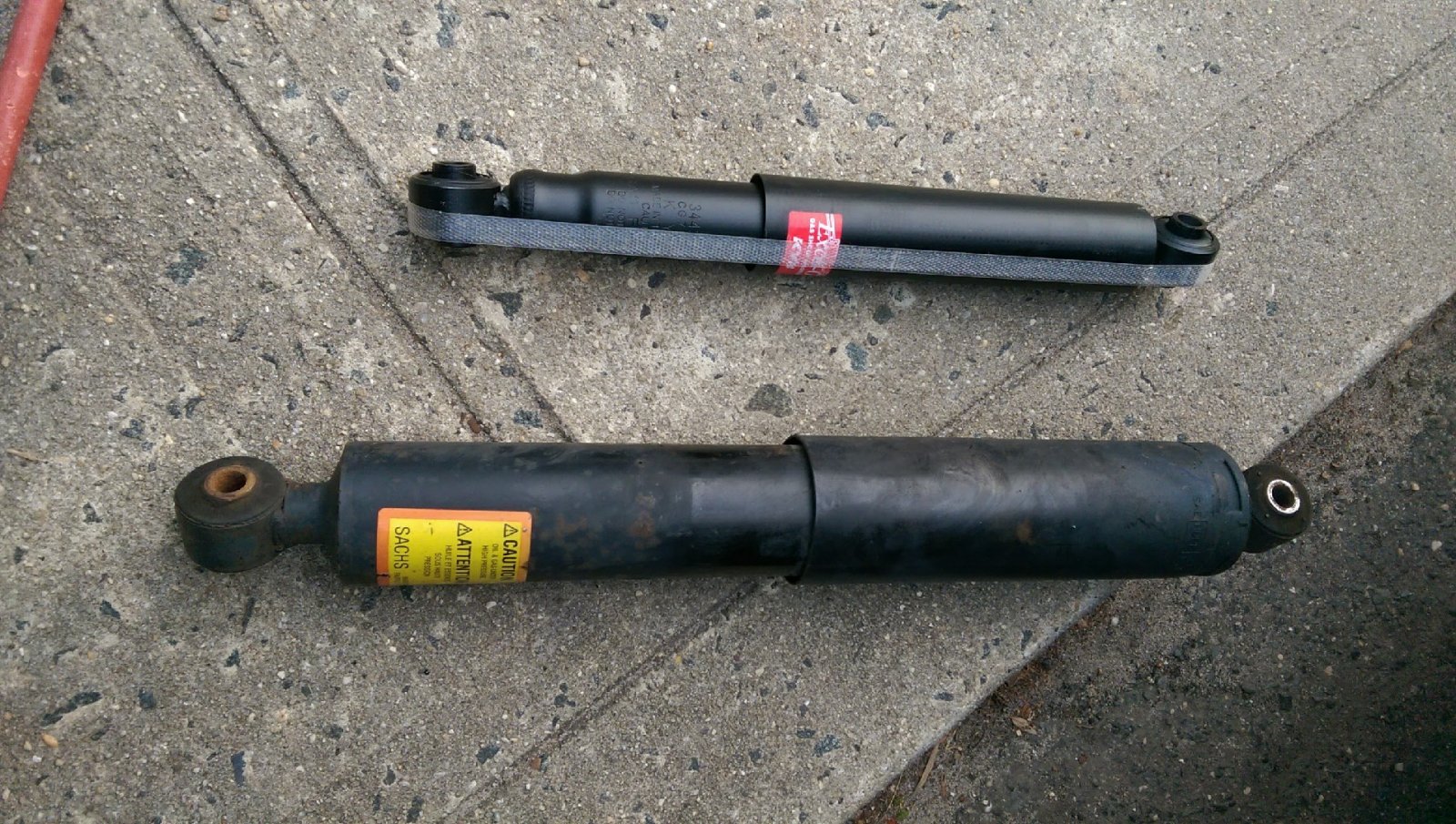

Bought some kyb shocks. Basic oem comparable. Are these small or are my autoride air shocks huge ?
Part number 344384 rear and 344381 for fronts

Return them and get the Bilstein shocks you won’t regret it, they are about the same size as the autoride shocks front and rear
I need to do this. My RPO codes are:
[emoji3502]6XK - Spring comptr select frt lh
[emoji3502]7XK - component frt rh computer sel susp (7XK)
[emoji3502]G65 - Level Control man, self-adjusting
[emoji3502]YD6 - spring, rear (base equipment)
[emoji3502]ZW7 - chassis package, premium smooth ride
I believe this is just the self leveling shocks.. not sure if they have a sensor or not. I do not have the air pump.
Wanting Bilsteins but after reading a lot about this, I’m still not sure what I need, and if I need replacement springs as well.
