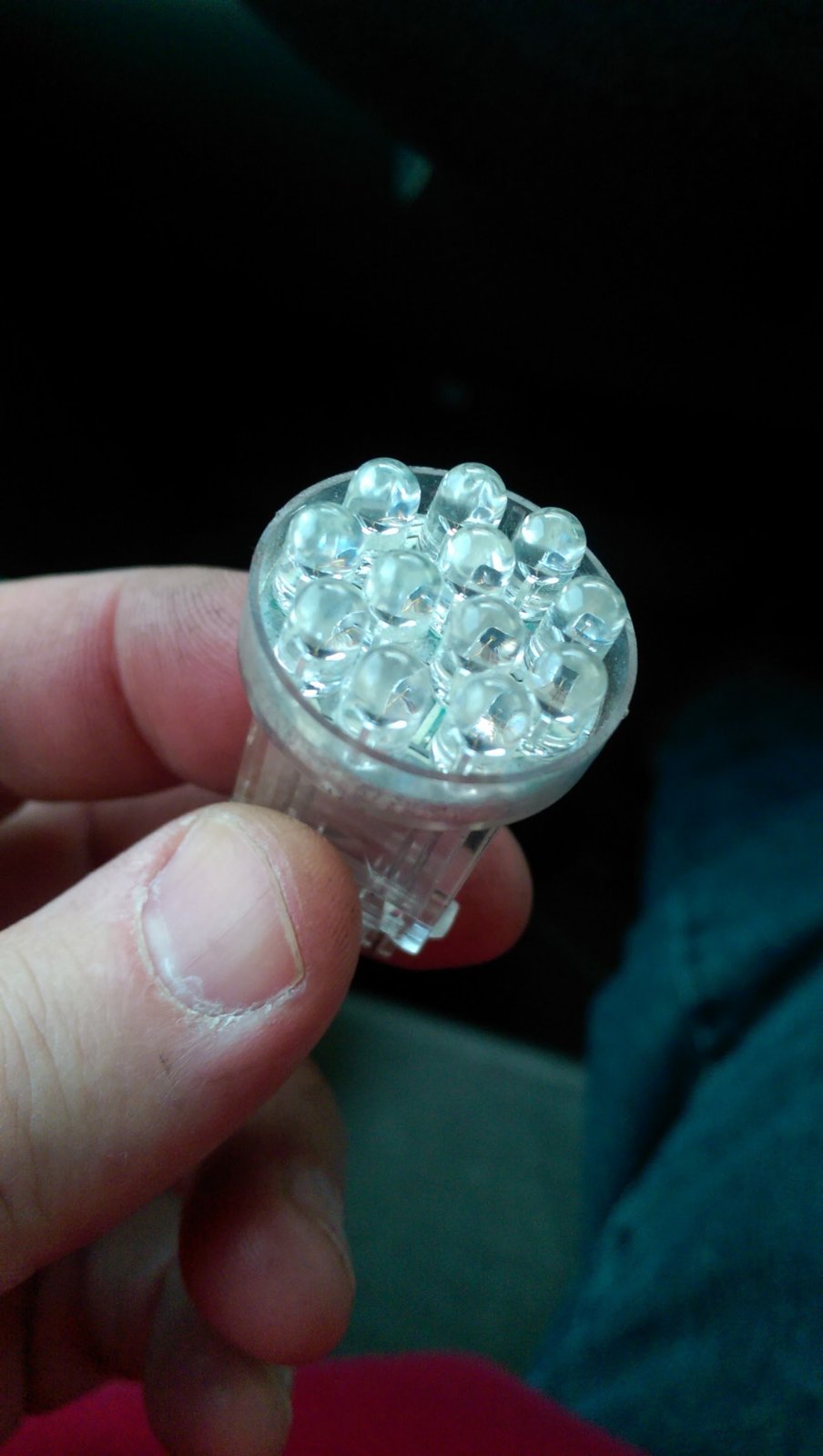

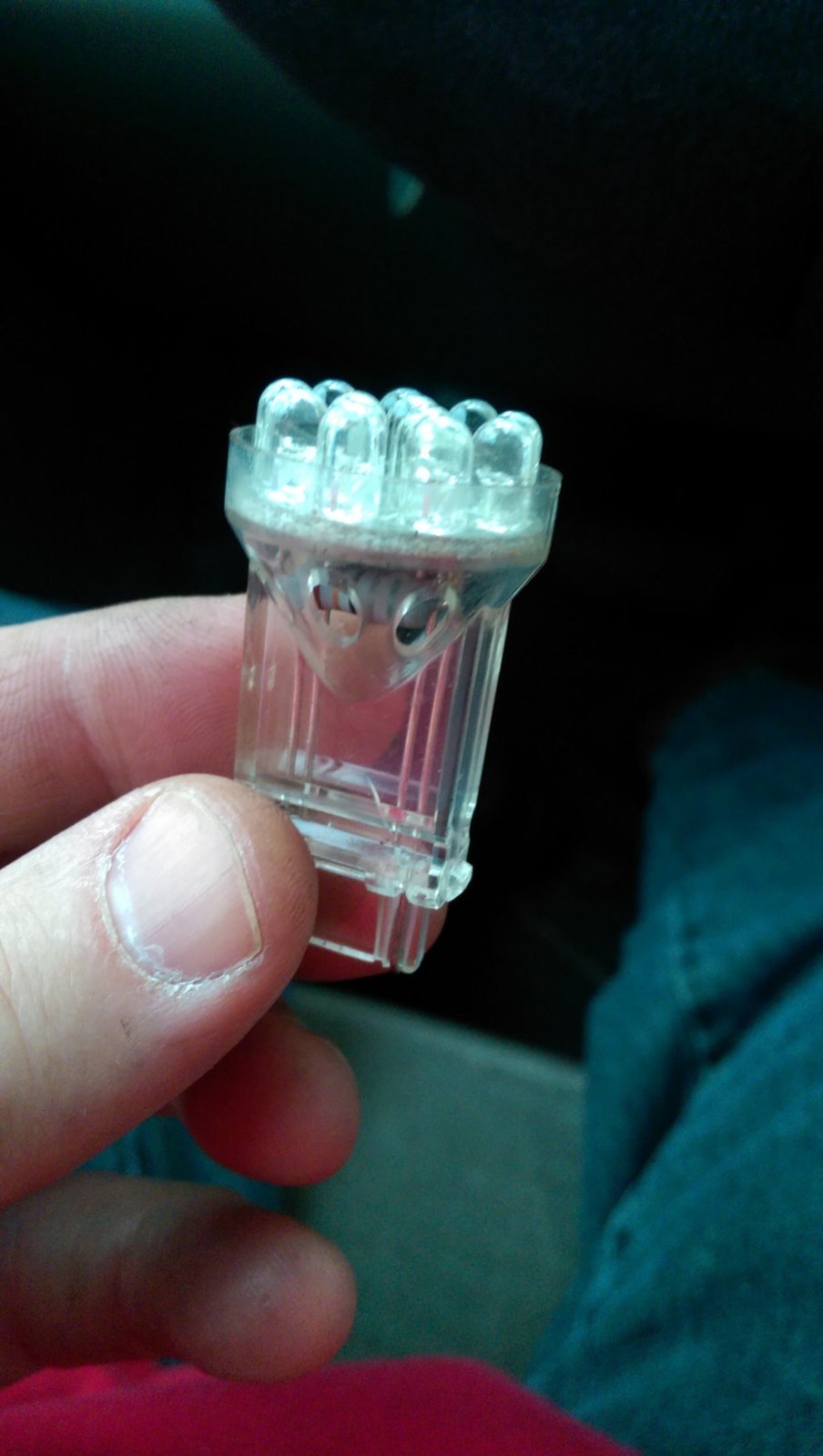

I tried led bulbs in my rear brake light housings and you could barely see them. I have these in there and they're ok.View attachment 210672 View attachment 210673
Thanks, Do you need resisters also to use them Tonyrodz?

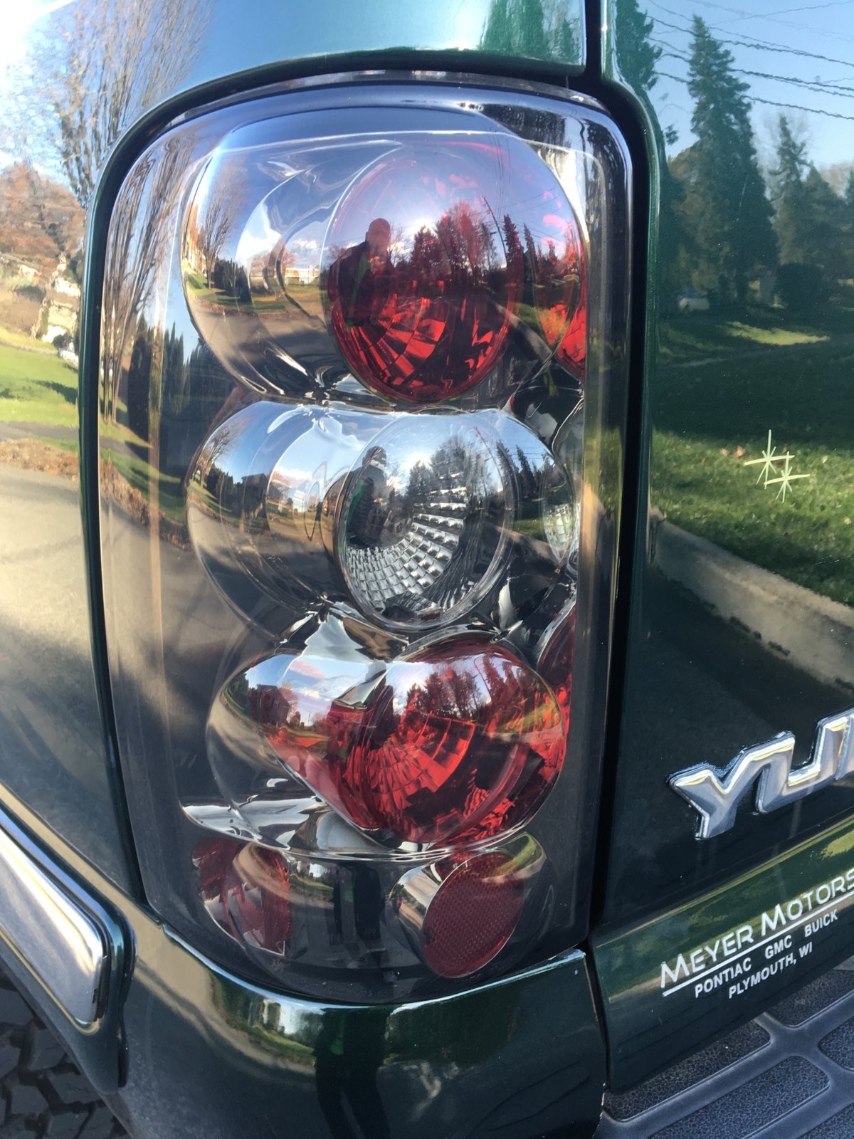

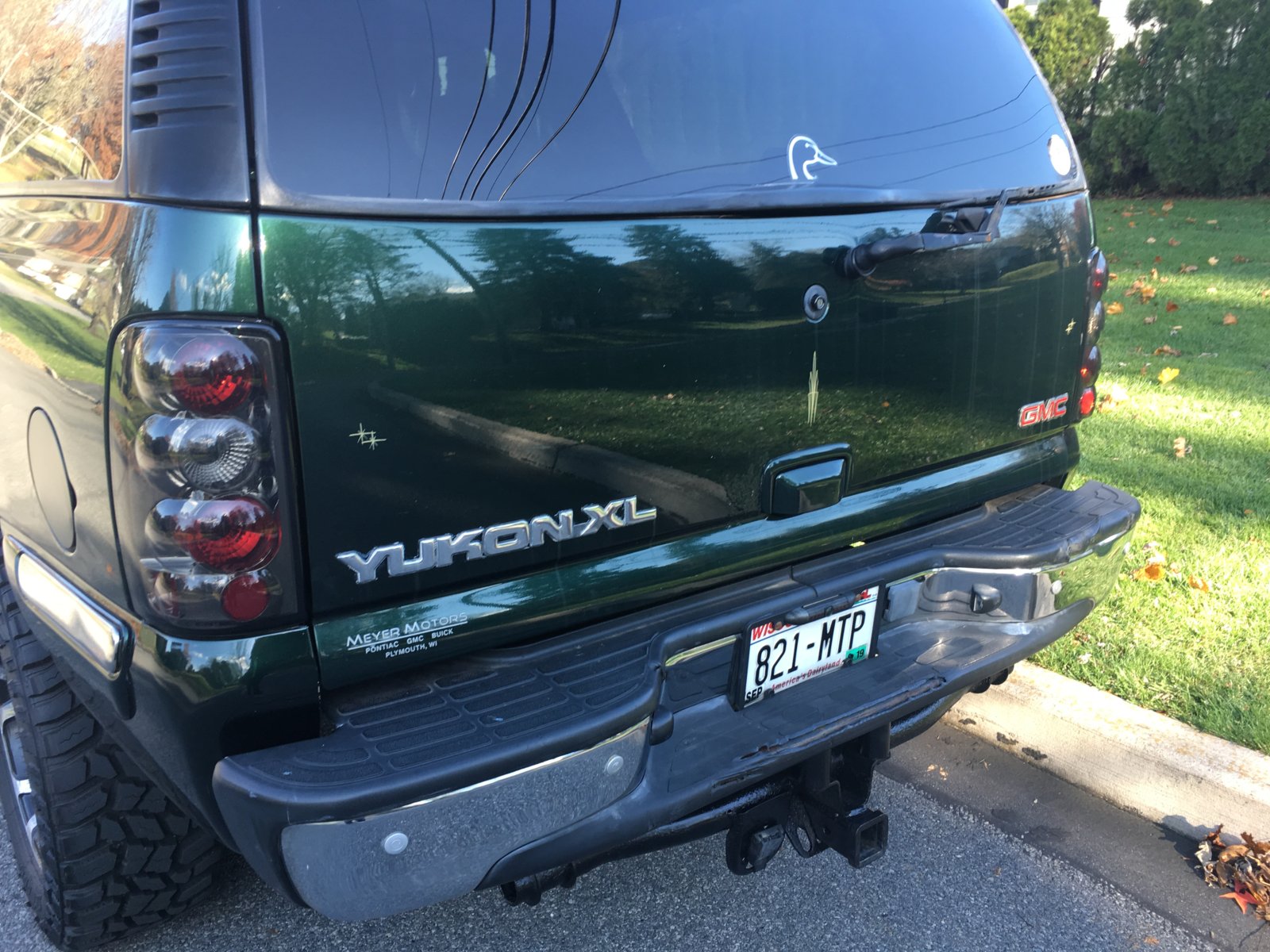

These are my tail lights. They are slightly tinted which is one of the reasons the lights are dim.

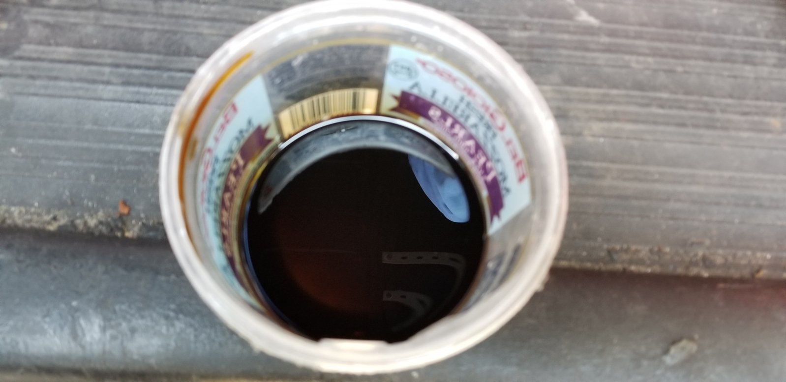

Emptied my catch can today. I haven't touched it for over 6,000 miles--2 oil changes--and I got maybe 1-2 ozs out of it. Before the whole catch can controversy I would've thought that was good. Not so sure now.View attachment 210674 View attachment 210675 View attachment 210676
For all you chefs out there--got you a quick recipe. @Galante it's right up your alley Paison.View attachment 210677
When I had a catch can on my 6.0, I barely got any at all. Maybe it's the valley cover or the valve covers on the 6.0's that keep the blow-by down. I have since replaced my DS valve cover with the newest design that's supposed to help even more. I didn't want a catch can with my blower.

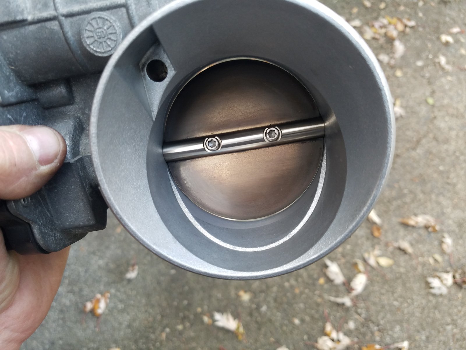

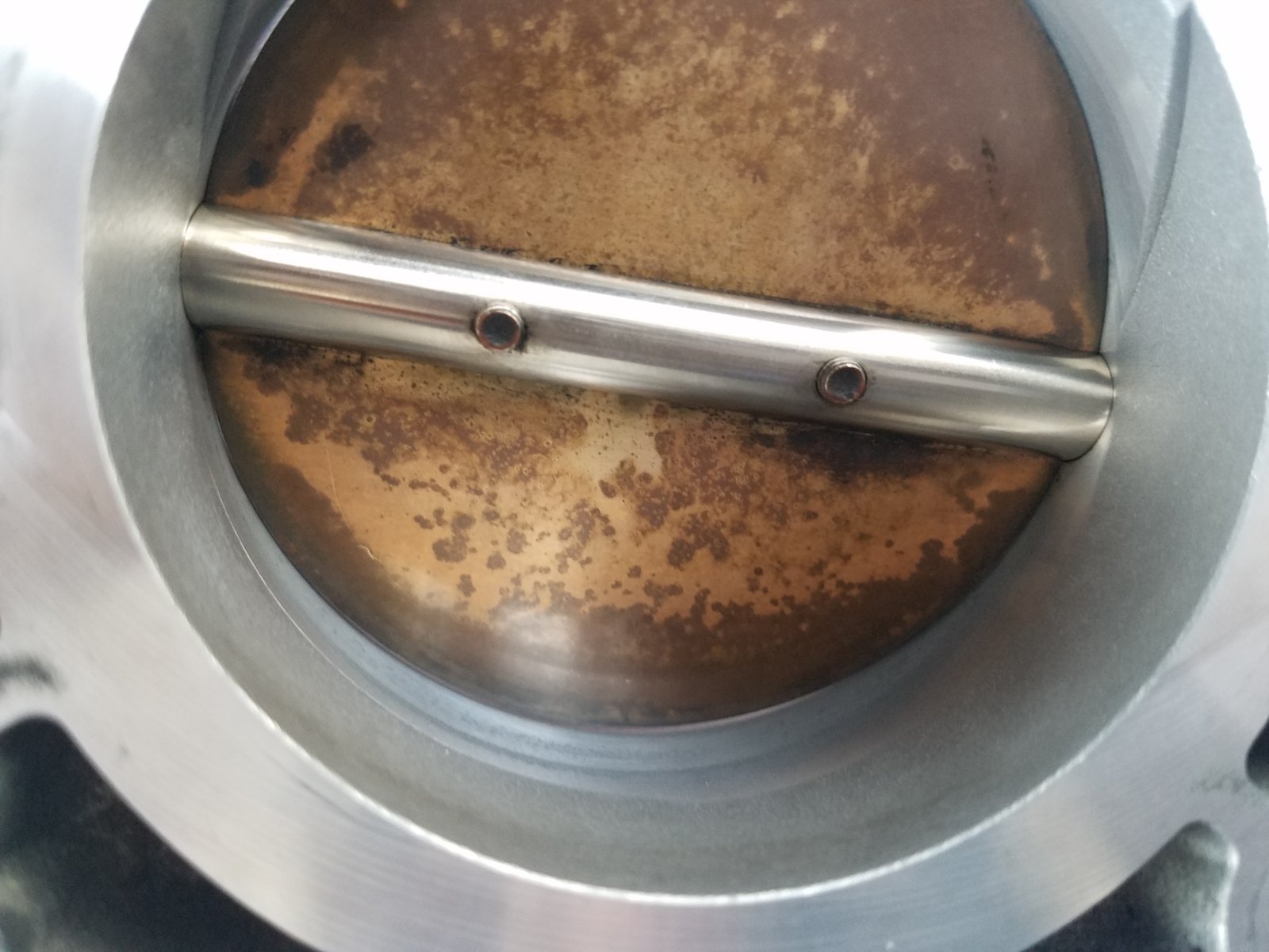

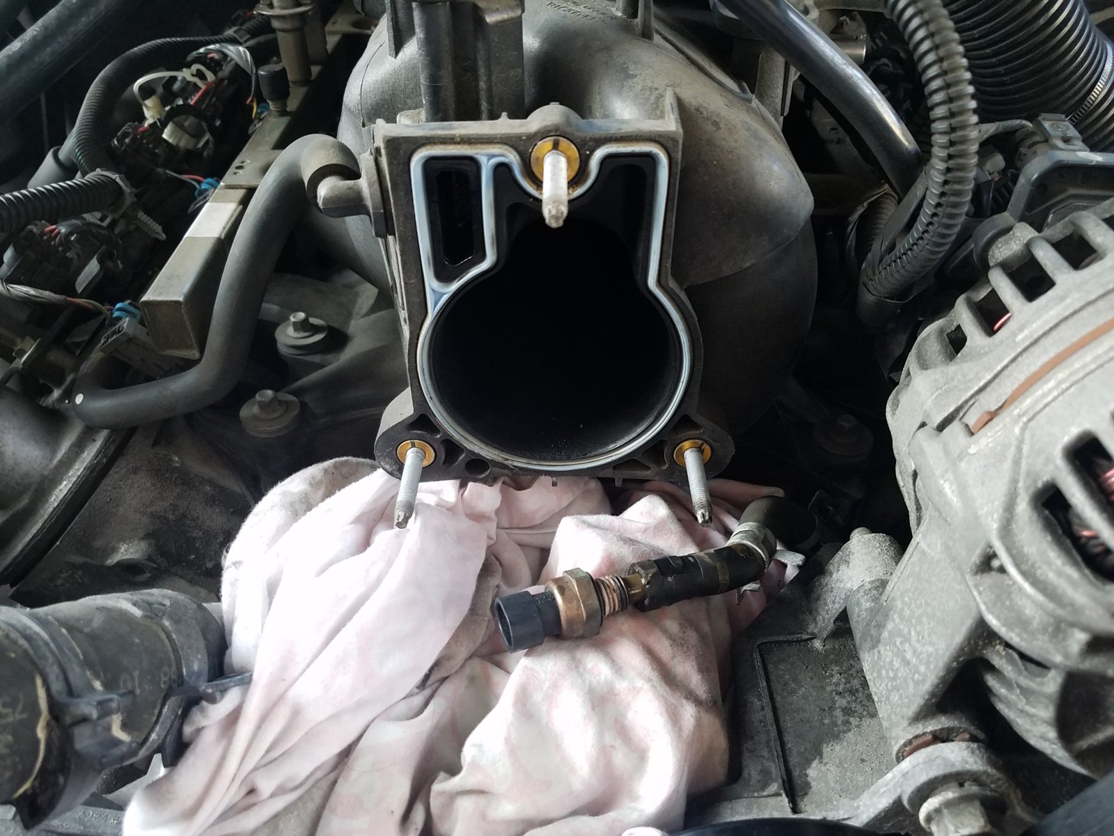

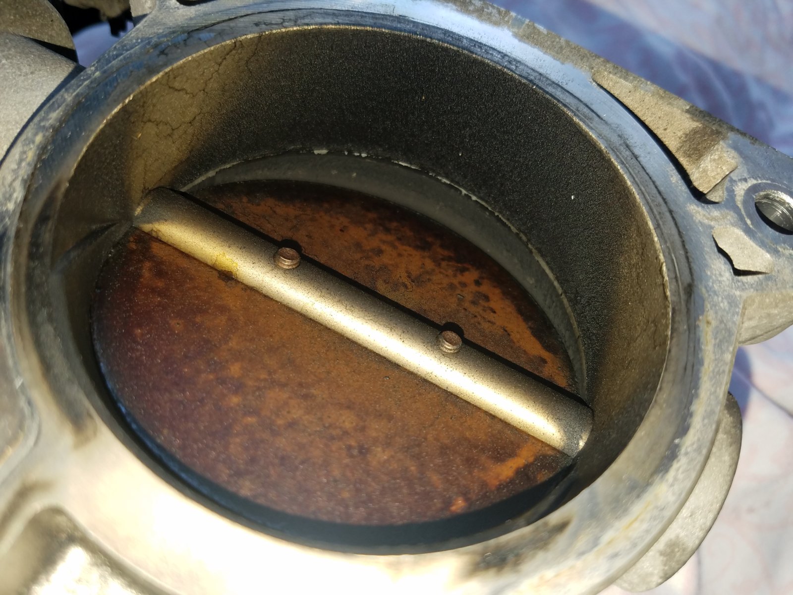

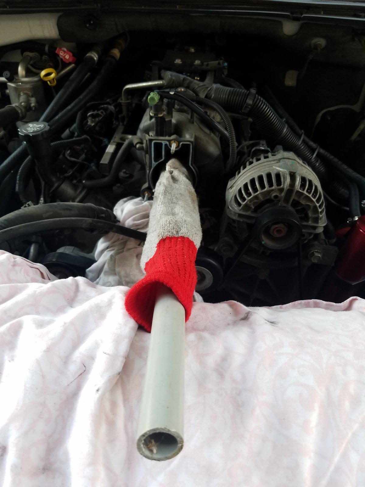

At my tune appt., Justin @BlackBearPerf told me to clean my throttle body before Thanksgiving. He was right (obviously) with TPS 12.9% at idle.
Disconnected battery and TB harness. Removed TB and used an old coolant sensor as a cork for the crossover.... Worked perfectly.
Sprayed and cleaned the intake as best I could with CRC throttle body /Intake cleaner. Used a sock and a pipe. It wasn't shining, but it was noticeably cleaner with a flashlight....
You filthy little thing, you....
I decided I would ignore all the "don't move it by hand" talk. I was CAREFUL. I pushed it closed, mostly. I took my time. I used a toothbrush with frayed bristles to get in between the body and the plate when in idle position, pushed it closed, and wiped with a microfiber cloth. Repeat x 14,000. I opened it a little just a few times gently. All cleaned up....
Reinstalled. Hooked up the scanner to watch for codes, RPM, and TPS. Decided to do the "relearn" right off the bat. Fired her up, seemed petty good. 3:00 on, 0:60 off. Repeated this a few times. No CEL. By the end, she has just about settled at a solid 600 RPM. TPS at 2.7%. A few minor fluctuations here and there, a little slow back to idle after a throttle burst. I'm sure a little driving will finish it off. Can't complain with a 10%+ decrease in TPS and no 2000 RPM idle. Happy camper over here.
