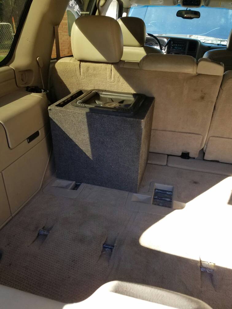

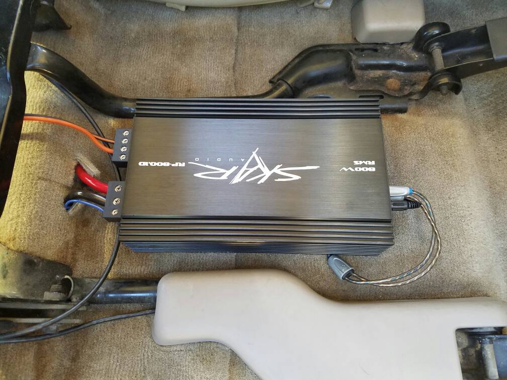

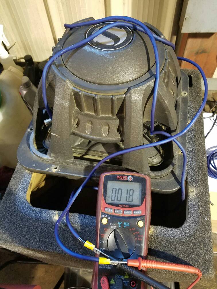

I recently bought my old l7 12. I ordered a skar rp800.1 to power it. The sub is 4 0hm wired in series to 2 0hm bridged. Got everything wired up. Mounted the amp under the second row passenger seat so I can still lay the big seat down to haul stuff. The speaker wire isn't hide very well l so the sub can be removed easily. I ran the power wire under the fuse block cover to a stud under the hood. The factory radio really limits me as to what the sub and amp can do. But it works for now

Did you do the big 3 upgrade?

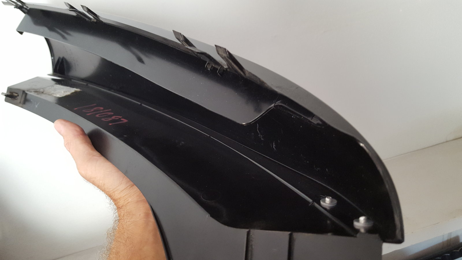

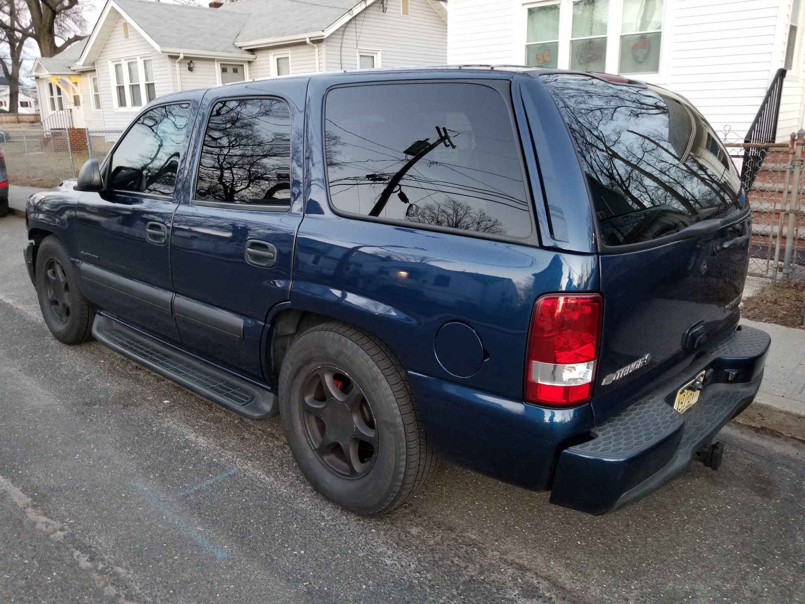

I finally got a pair of Esky vent covers ( used / painted black) and put them on today..... But in fairly good condition. ( I installed them to check for 'issues' before I paint them my Carbon Metallic).....
I discovered they are a "2-piece" construction, glued. The top was coming apart a 'bit' so I glued it & a couple rivets , so when I remove them, it won't detach more, since you gotta pull them out FIRMLY.
I ALSO noticed, the top curve isn't exactly the same as my door curve. But with my aftermarket tail lights , it looks good!!

Have my L7 12 at 2ohm and joined with a 1200 watt kicker amp. L7 came in the same box and it hit ok, but once I built a bigger box for it that's when she slammed nicely.
Do you have a in-line fuse for the power wire?

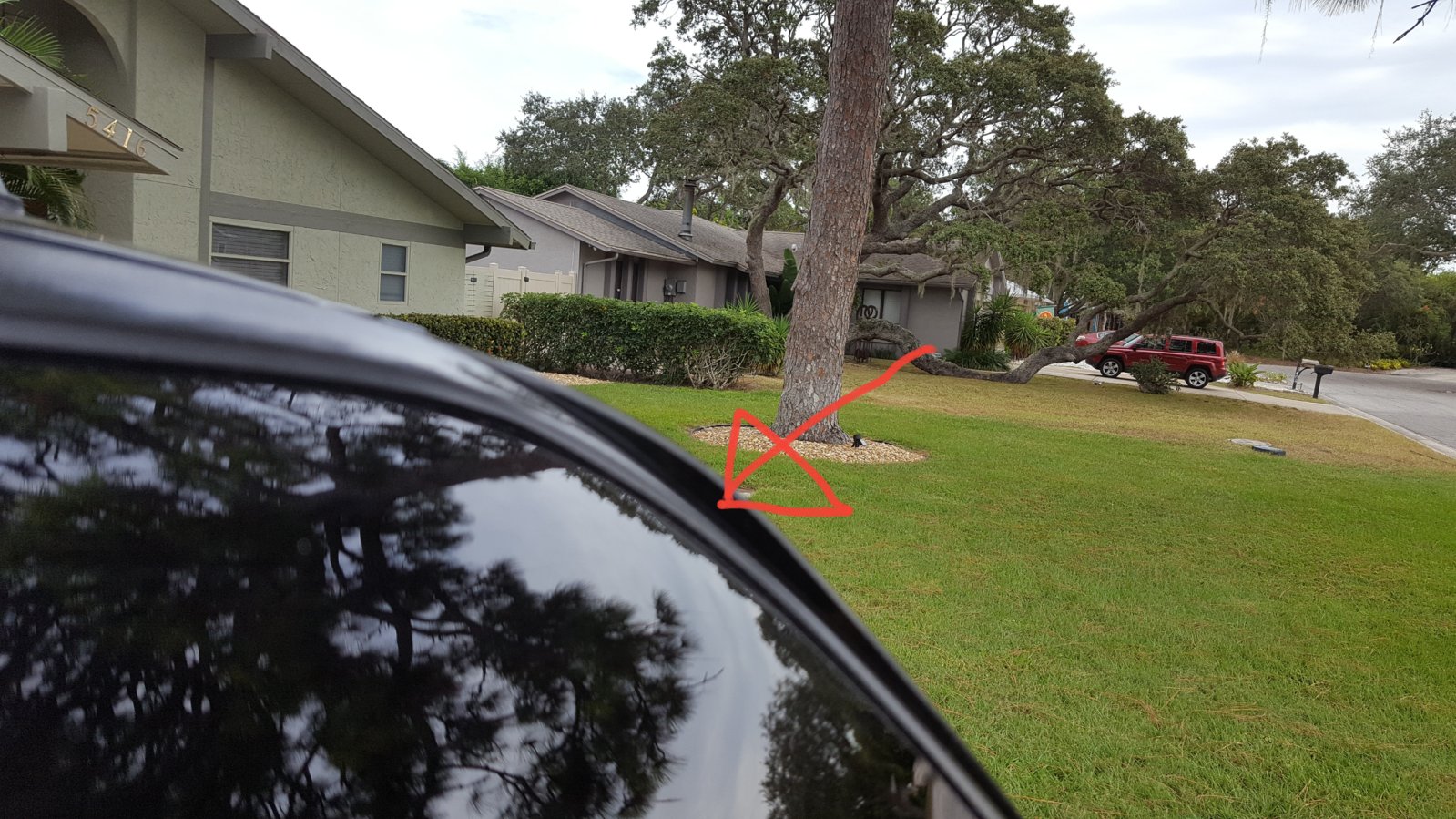

Here's a close view of the vent cover, different curve at the top, verses the original cover.... dosen't match the curve of my Yukon's curve...... but, unless you didn't know, you don't really notice. No one has ever mentioned the difference of shape, or if one year was different than another.
