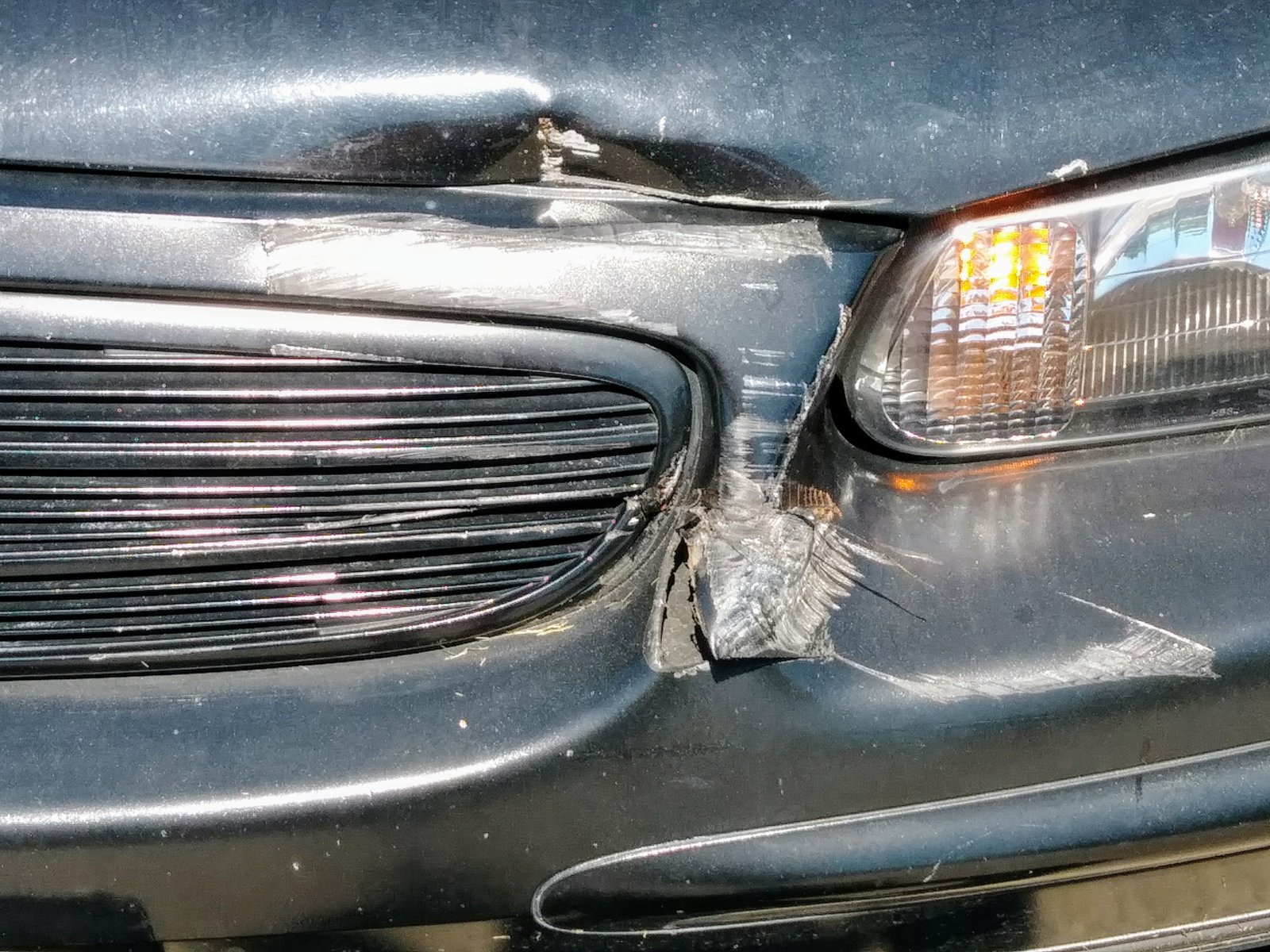

im also in the parking lot hit and run club. the scum that walks among us.
lucky for me they missed the head light, just bought new and installed then about a month before the hit. and what you cant see is they cracked my intercooler res tank. i was mad for maybe two weeks, bent the hood out best i could, repaired my tank. its still ugly looking, but i no longer see it.
