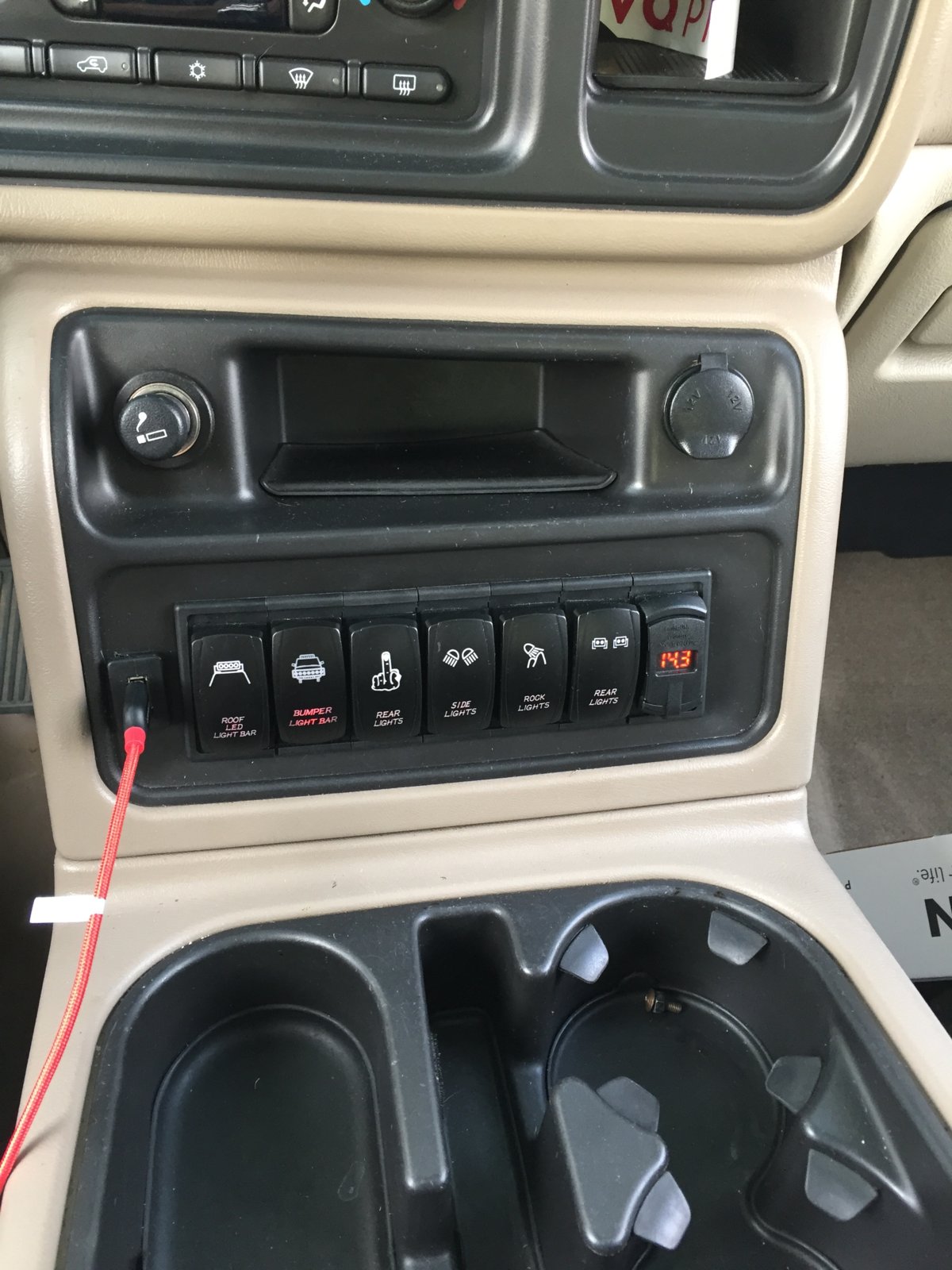

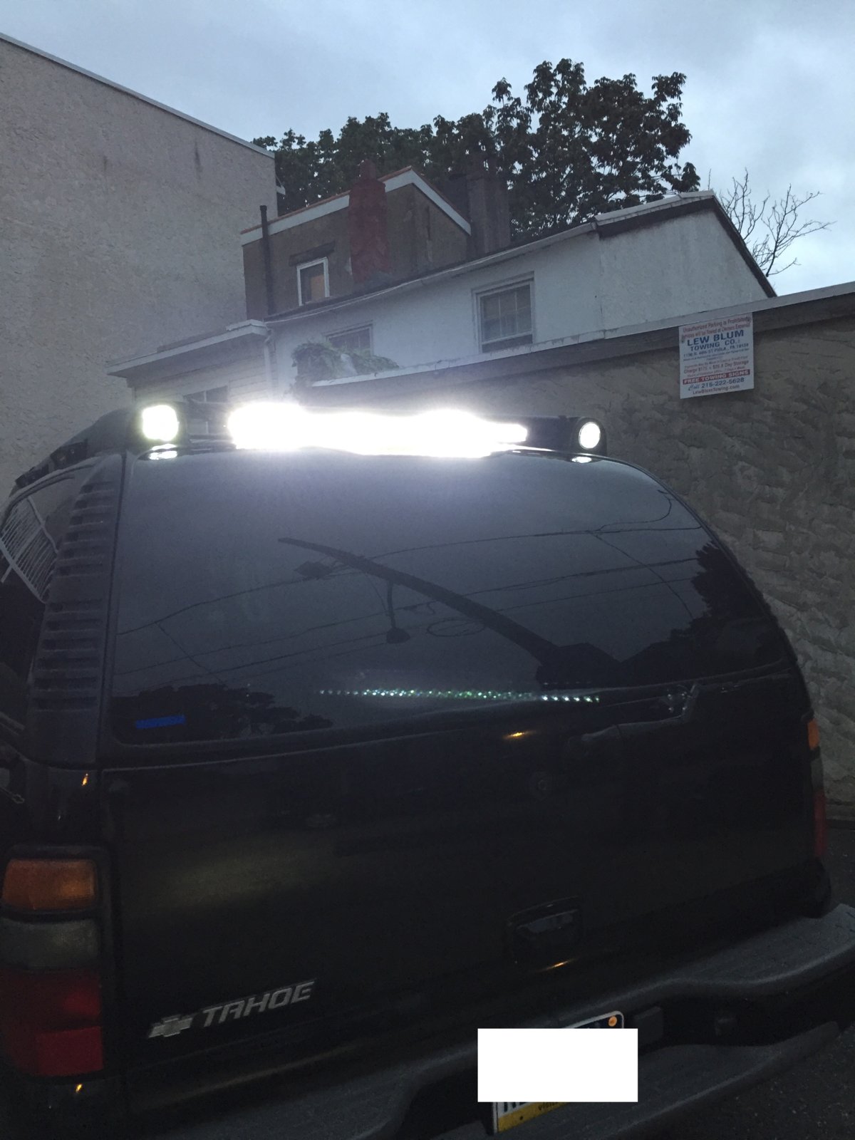

Here are some LED light bars and rocker switches I installed recently. No cutting require to install the rocker switches in a stock 05 lower dash slotView attachment 207764 View attachment 207765 View attachment 207768 View attachment 207770
Hey man do you have some of the same pics with no lights on? And a little write up on how you did it and where you got the lights to fit all the spots.
