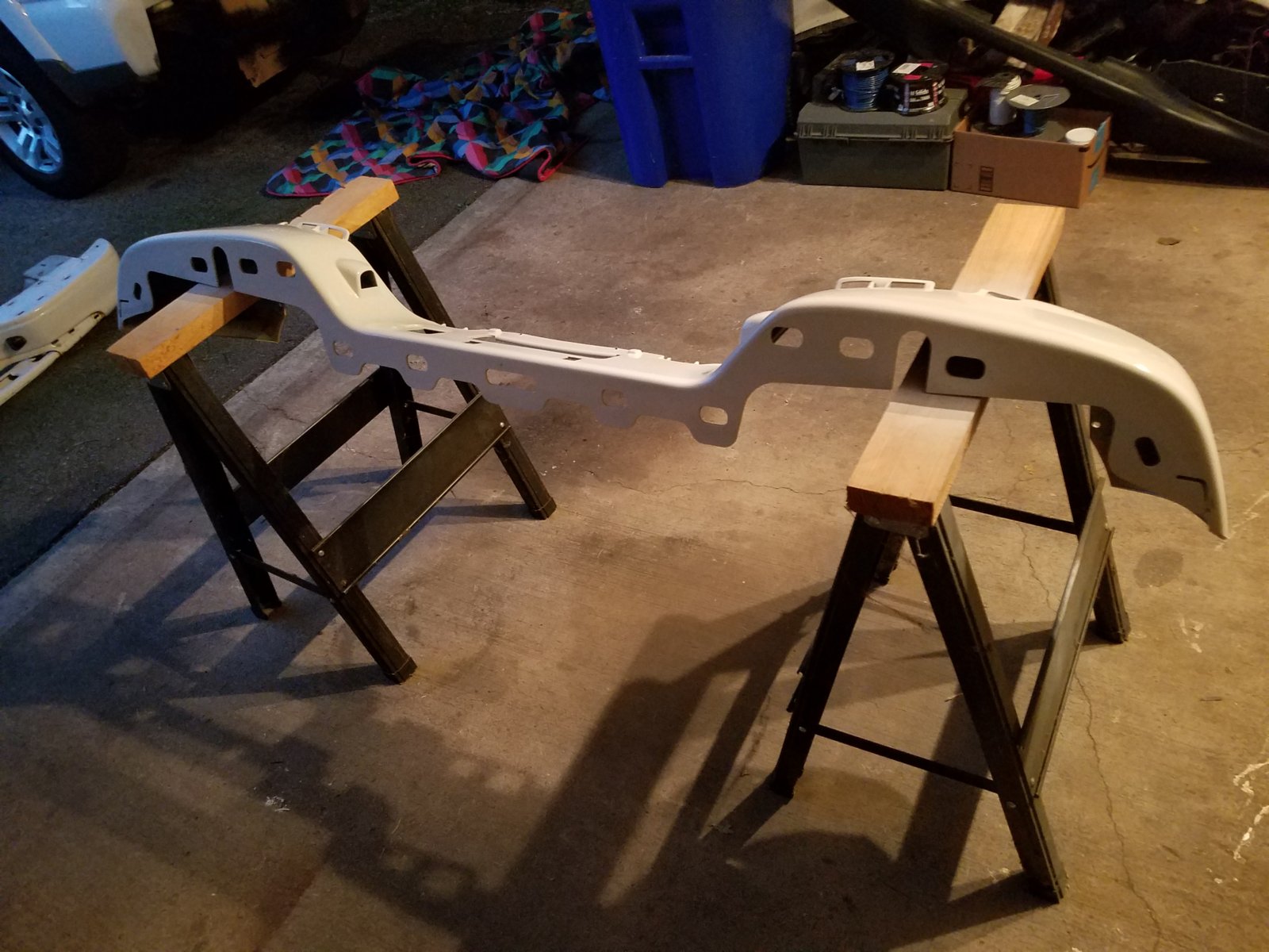

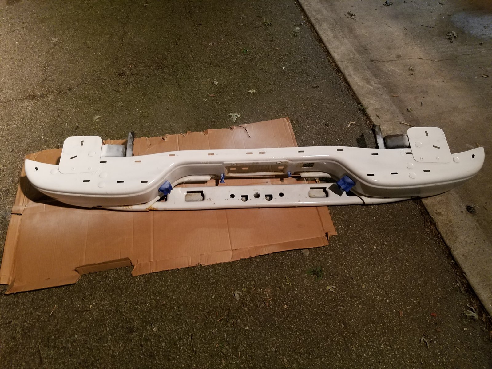

So pretty much if I lay on my back under the back bumper I should see the clips and just use pliers to undo them? I don't actually have to remove the bumper
Here is the hole pattern for the step pad. Every one of those little rectangles is a clip.
Then, of course you've got the bottom piece to deal with as well. It took me maybe 15 minutes to yank the bumper first.

Better luck is to take it of to try and remove it. I know for a fact laying under it to try and remove it is a pain
Thanks. Maybe what I'll do since it's holding in there now I'll wait till it's warmer out to do it to repaint the bumper pad and do it all at once
Also thanks for the picture
Are there clips under it for the bumper cover?
Nope. The cover is held on by the black pieces. Here is the cover :
You can see all those holes line up with the ones in the bumper and the clips on the black pieces just go through both.

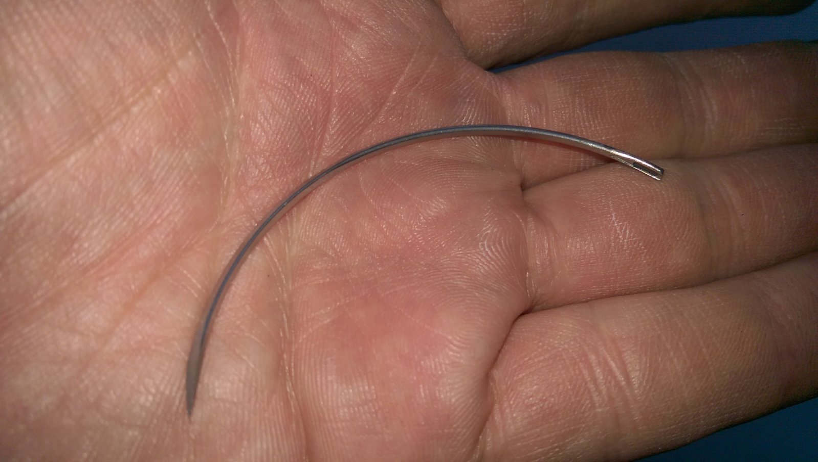

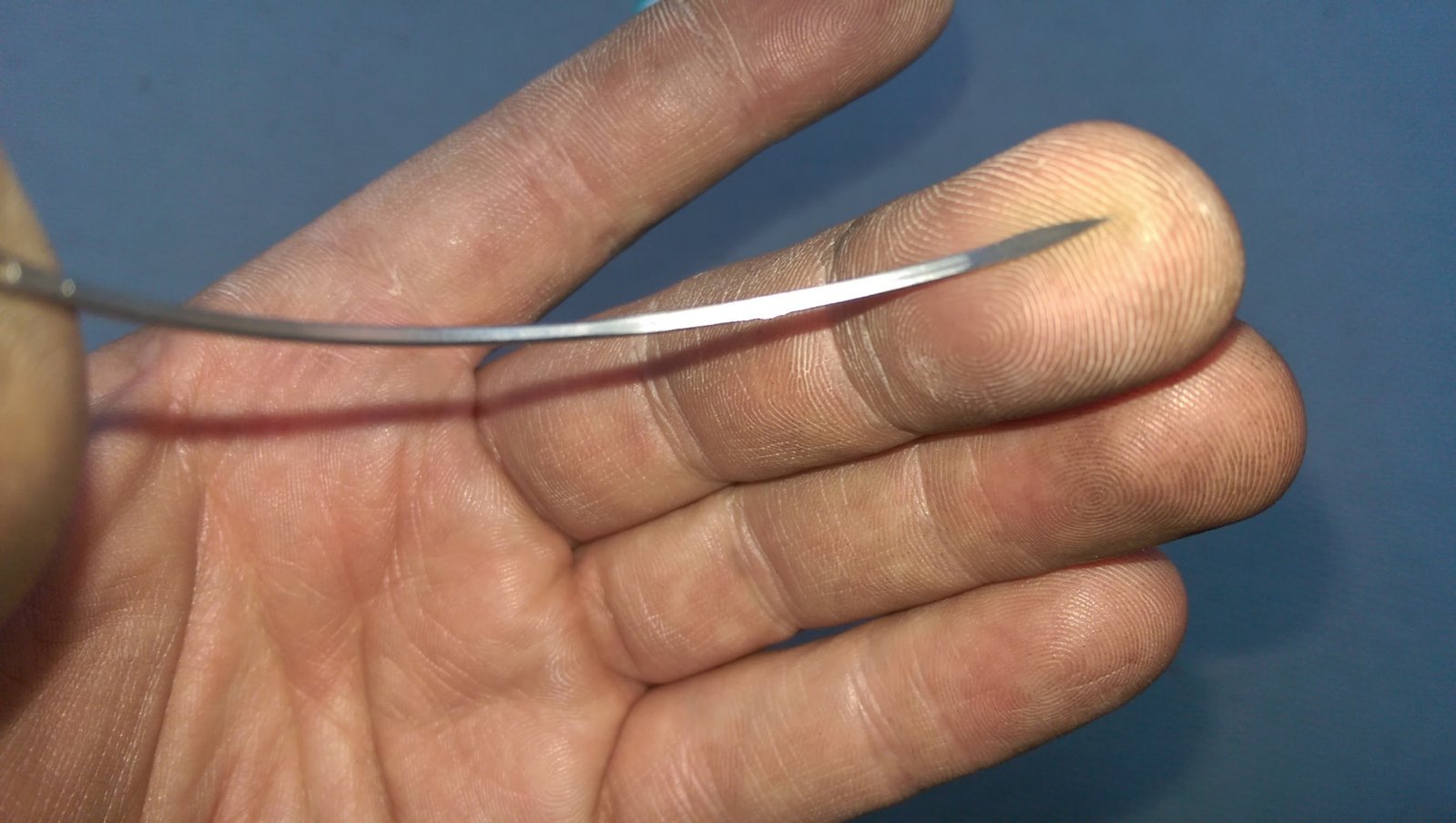

teach me your ways Tony. Any good how to's? I have a small puncture and some stress cracks in the coating Id like to minimize.
33,199
51,441
I use a huge angled needle, more like a harpoon.
This happens alot-
For cracks I use a heat activated paste, and these rubber pads that have leather grain in them. Long and tedious. I don't really know any how to's. Everything I use is a specialized tool/materials.
