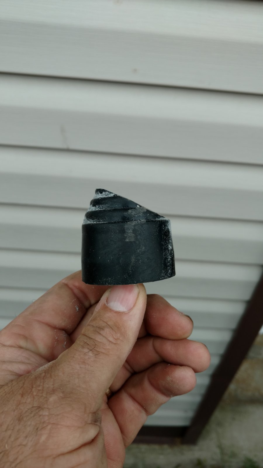

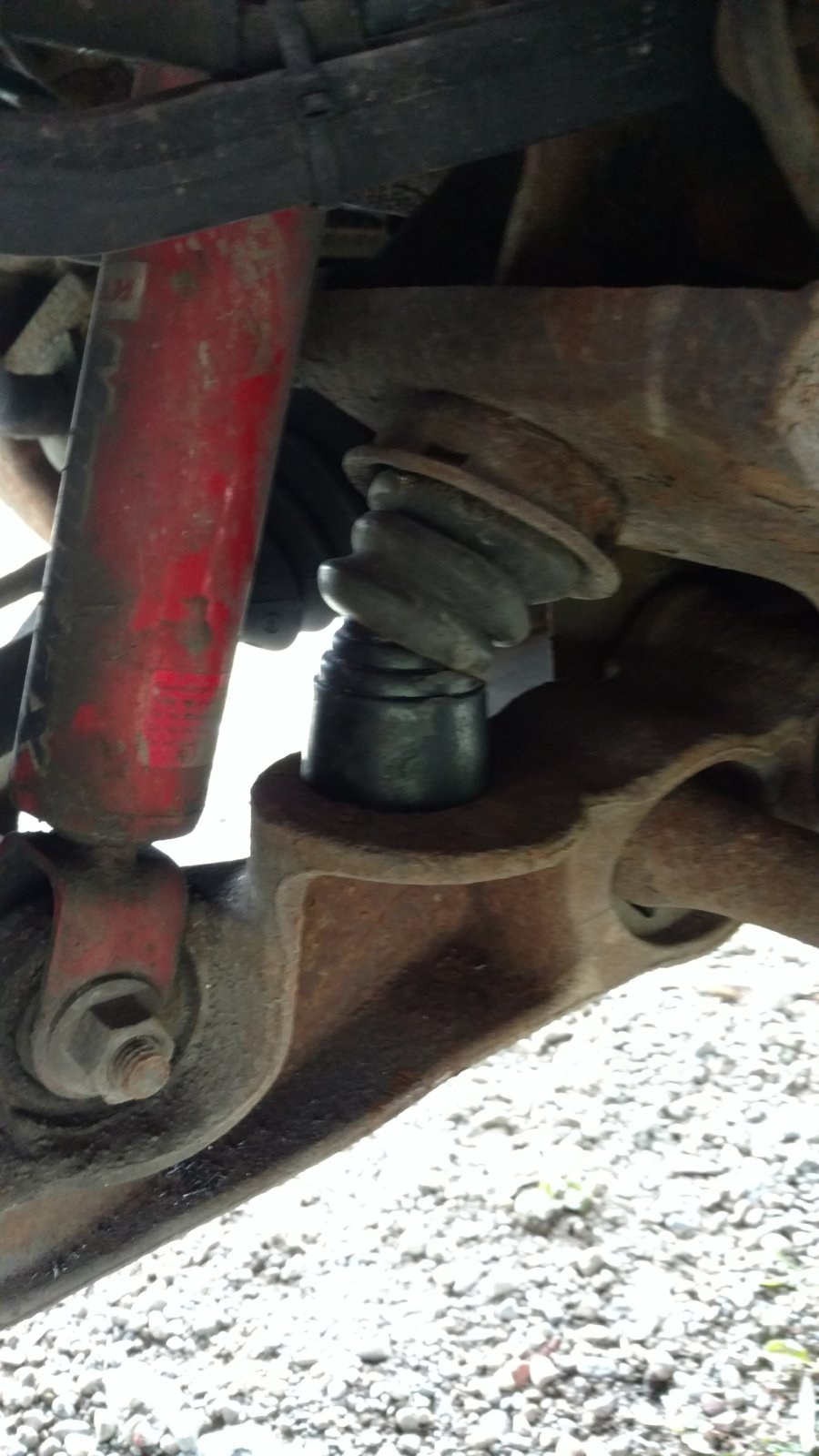

Finally got around to installing the LCA bumpstops I bought in December of last year.
Took them to the grinder to maximize contact area with the factory bumstops.
Not perfectly centered, but pretty close.
Can't say I've noticed a huge difference, but it does seem like the front end is more "connected", for lack of a better term.
You might need a set of shock extender brackets.
Is that the factory shocks in front, there? That is quite a bit of lift you got there. I put in some lift keys that completely leveled my truck out and I still have the bump stops touching the CA. I don't know how as they were up about 1-inch but I played with the adjustment bolts a few times and got them back in contact again without sacrificing any of the lift.
I have to replace the bushings up in that torsion bar cross-member tomorrow so we will see if that changes anything.

Nope, replacement shocks are MonoMAX for a 2-5" lift. Mine isn't leveled, I have Z71 springs and 2" spacers, rear fender heights are 40 1/4", while the fronts are at 39 1/2" (have 285/75/16's for tires). I don't know how some guys are getting 41" or more on the fronts, my UCA's would almost be riding on the limit steps, if I still had them - mine would bang when when going into full droop (or lack thereof) when I would go off-road. Conceivably, I could crank my keys more, max out the passenger side and get another inch plus, and match the passenger side..... but my wallet would be empty all the time, I'd be going through front end parts at least every six months.

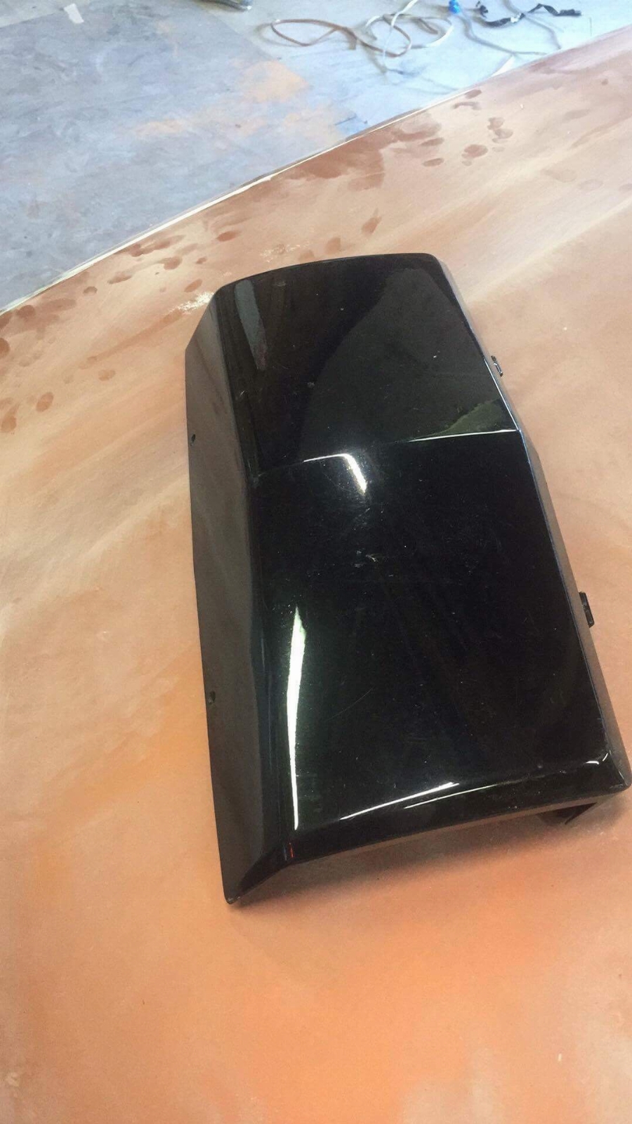

Filled up the Escalade with 93 V-Power and scored this plate delete cover in black

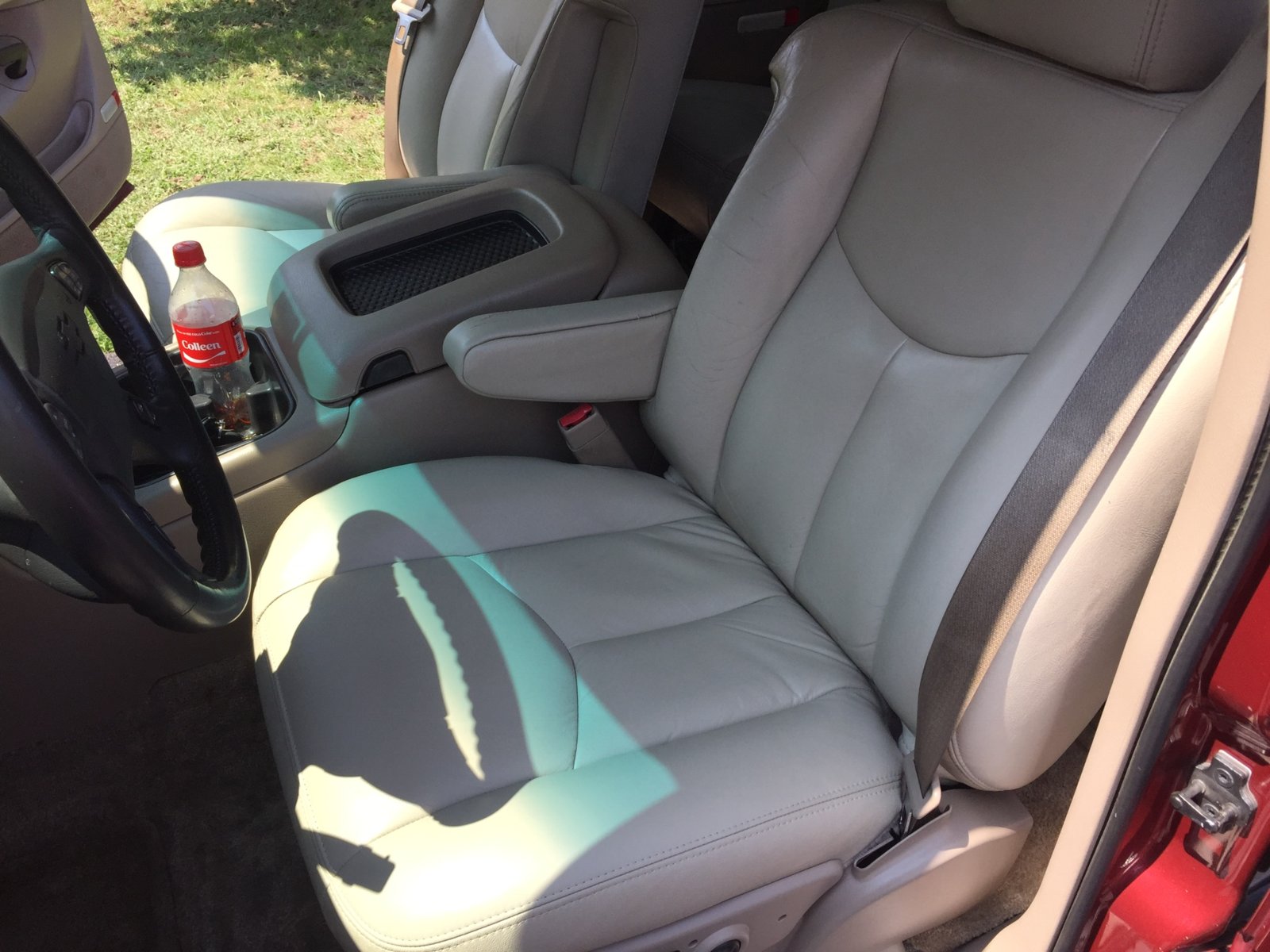

Does anyone have recommendations for driver seat replacement leather seat bottom that won't break the bank. As well as replacement side mirrors that have the puddle lights
Thanks in advance

Highly recommend TheSeatShop.com replacement leather. I just did mine.

Right on. See that was my concern, also, altering those stock steering & axle geometrics. Then, I saw where the jounce bump stops are supposed to be in contact with lower CA so that's when I began finagling the adj bolts. See I just wanted to fit the tires that I had & improve the look, not necessarily get a bunch of height out of the deal. And then like you said about the UCA bottoming out on that frame piece or whatever... Just seems like a bad idea doing anymore than 2" without a kit or addressing all of the other components. But anyway you know what you are doing I just noticed hella lift there & wondered what you had going on. Stay cool

I used Richmond Auto Upholstery https://leather-auto-seats.com/ and have just received the best customer service from any company I've ever dealt with. I bought the front bottoms in January 2015 and recently the driver side developed a weird wear area and they sent me a replacement as well as some jute to help the worn padding, free of charge even though the warranty was up over 2 years ago. I've never had better service and their covers are top quality too.
