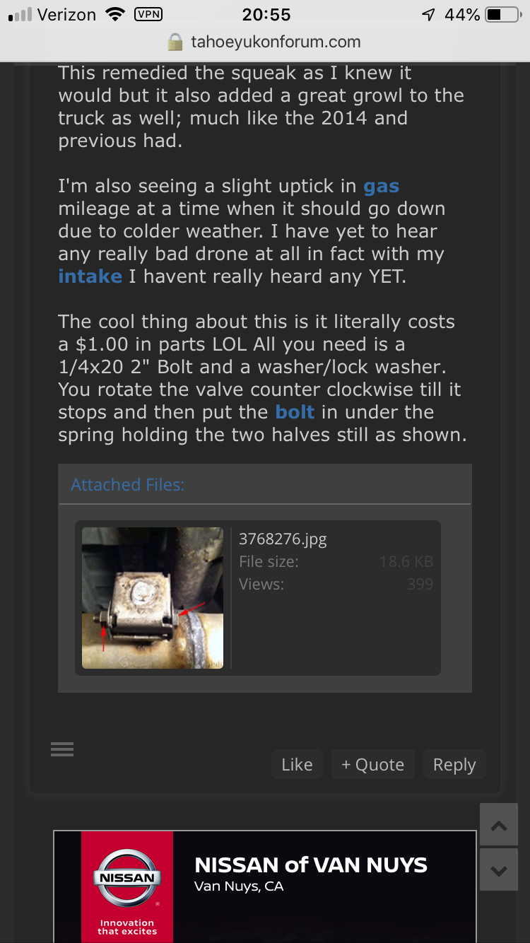

A strategically placed bolt to keep the butterfly open.
I’m Assuming this is on a performance exhaust optioned truck?
Big letdown for me is I have two other v8s that when started, shake my wife’s paintings off the wall in the living room. I remote start my Tahoe and I have to look out the window to see if the LED lights are on to figure out if my V8 is running. Can’t hear the stupid thing. Sad.

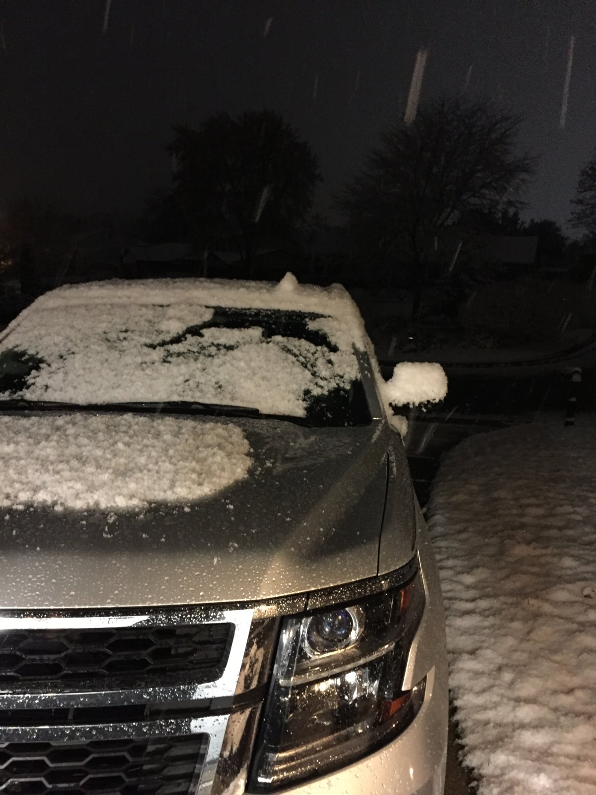

Rain tonight, but snow kicks off again tomorrow night. I’d take rain over snow anyday my friend

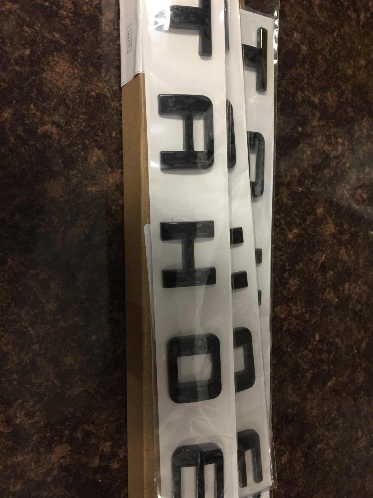

My gloss black Tahoe script arrived. Will have to wait until April to install. Plastidip works fine with most of the emblems, but the script has sharp edges, so wash mits and towels catch them the wrong way once in a while. $39 for all 3 is worth it.
