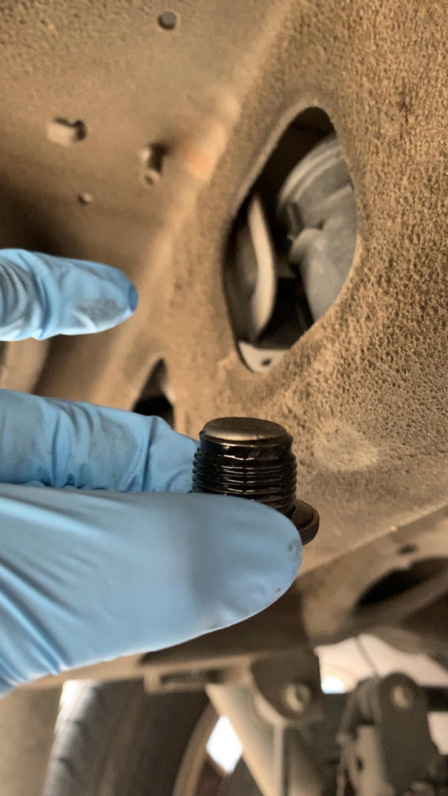

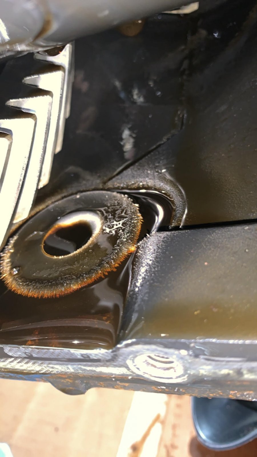

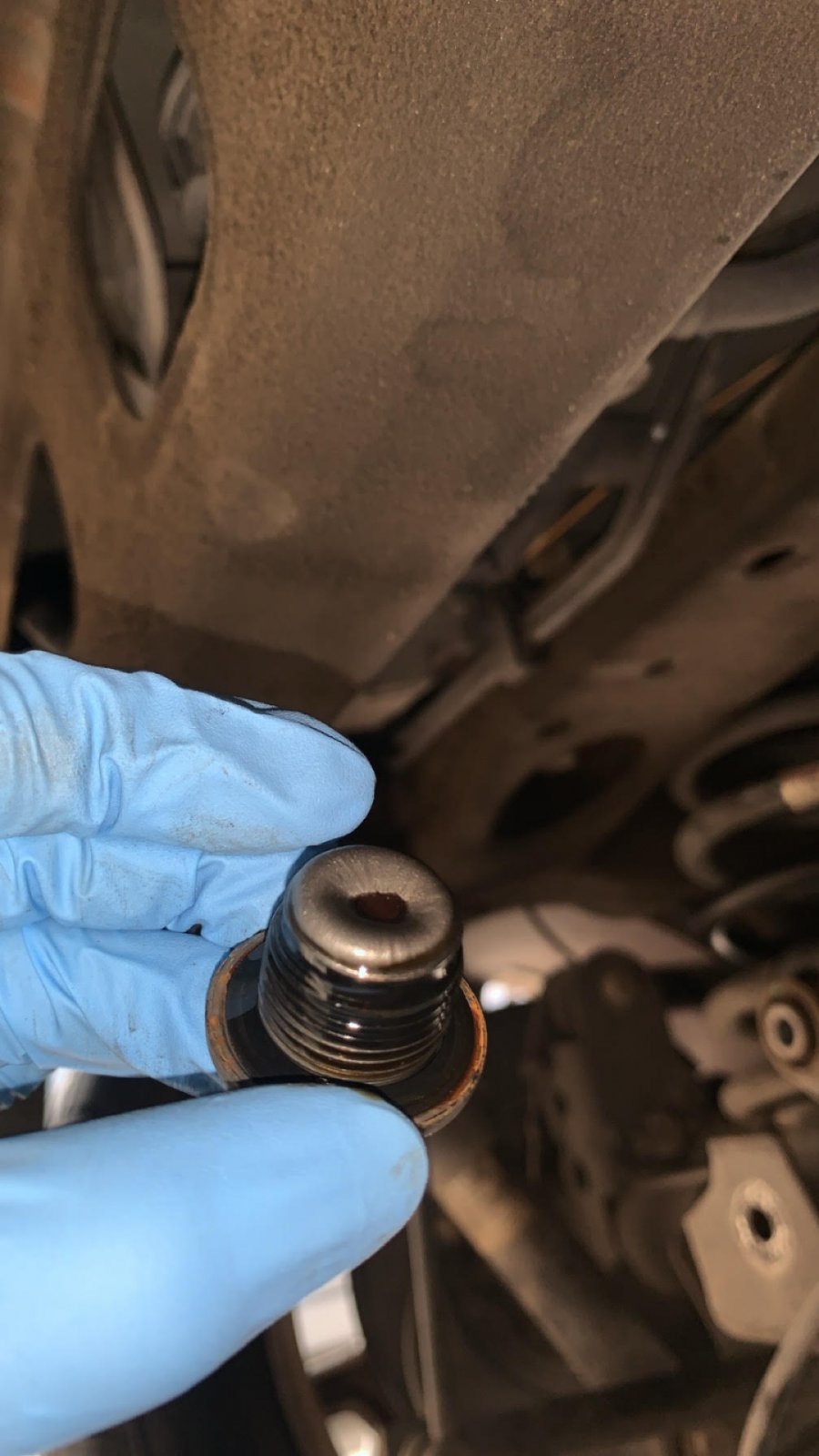

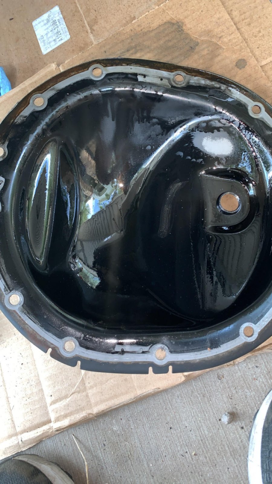

Good evening,
Changed the rear diff oil on my 2016 Yukon w/ 98k miles. I think it has never been changed due to the color.
Followed some YT videos, and finished in 1.5 hours- I've never done this before so I took my time and did everything carefully.
I used AC Delco 10-4016 75w-90 Gear Oil, the diff took ~2.5 qts.
Here are some pics.

I just did this on my 17 as well, mine called for 75-85 gear oil not 90. Not sure it would make much of a difference either way but might be something to look into just in case. I think its more important to follow the guidelines of either friction adder or no friction adder which if you used the AC Delco it should be correct without adder

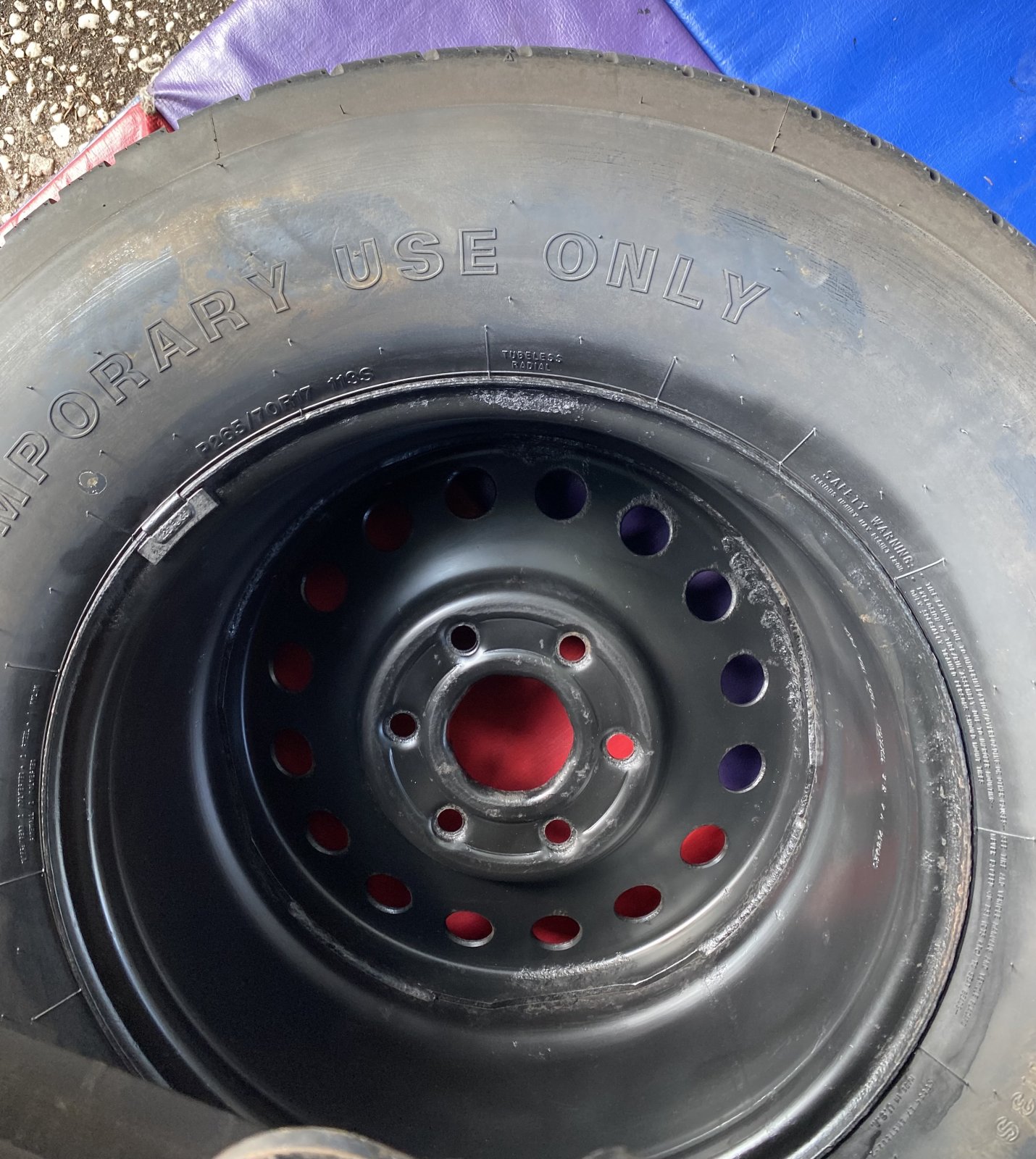

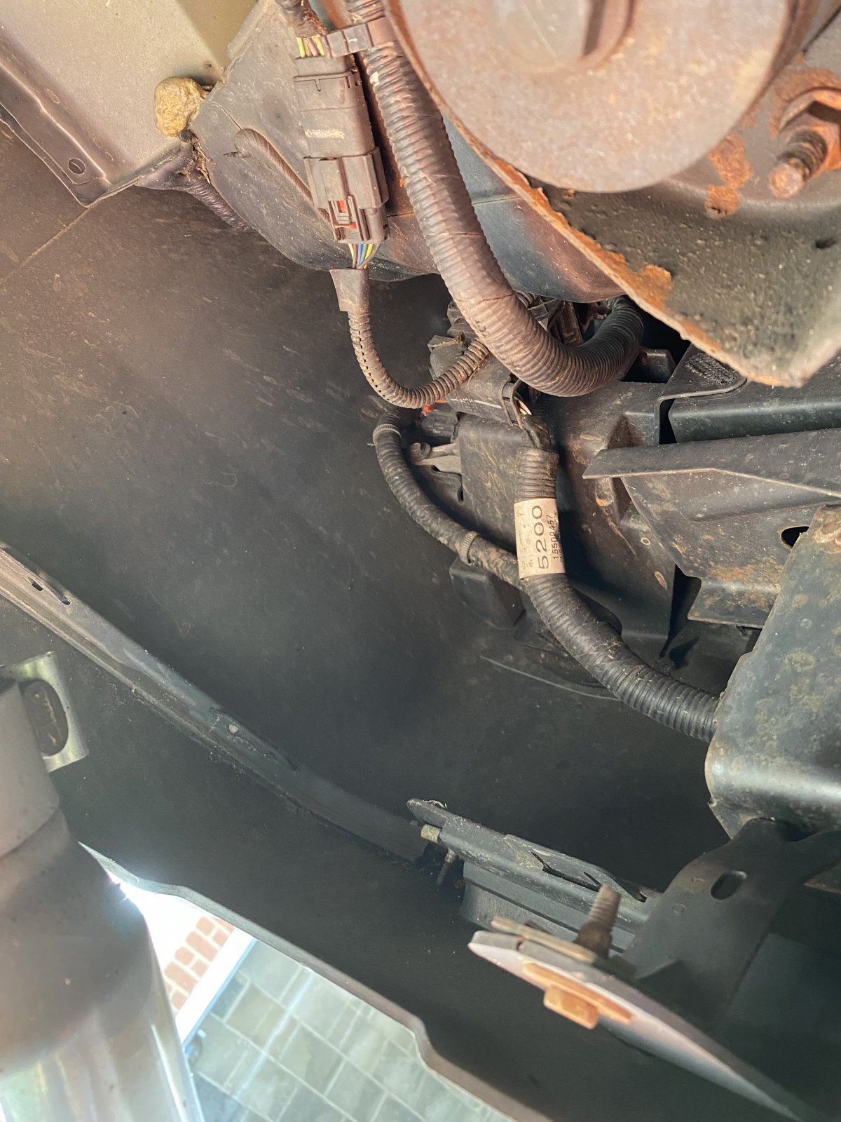

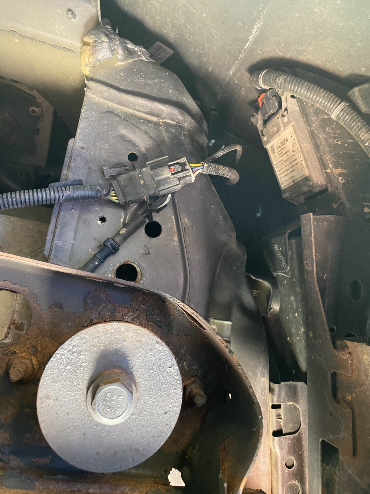

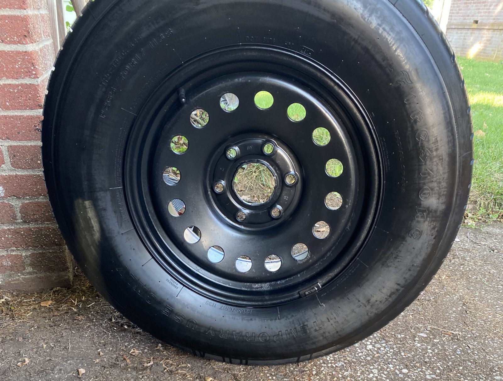

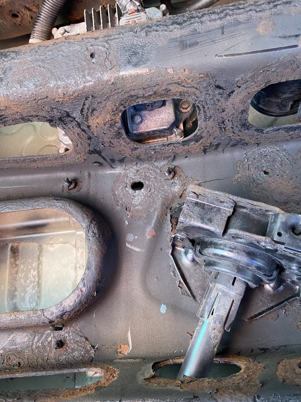

Went to check on the sensor harness near the exhaust for condition and all was good but one thing led to another and wound up refurbishing my spare and scraped and wire brushed the rust on the bottom. Hit it with a rattle can for now as I rarely drive in snow/salt

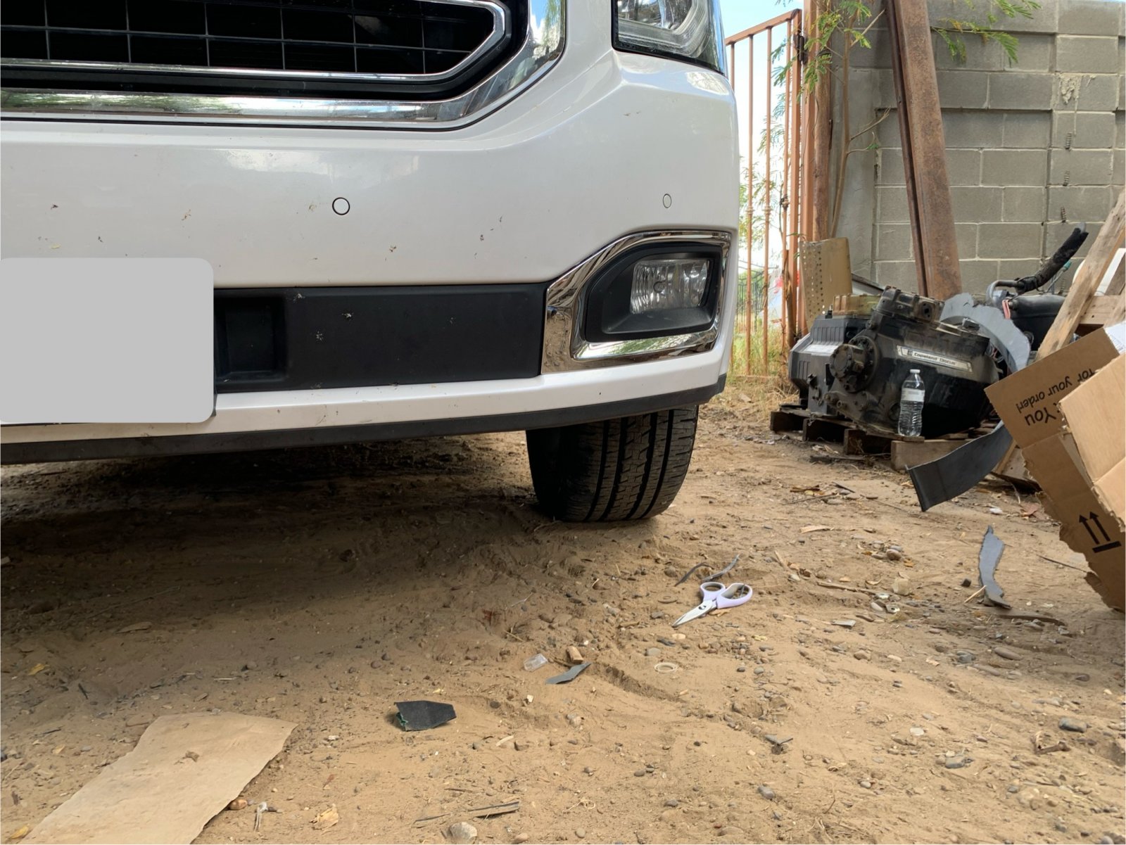

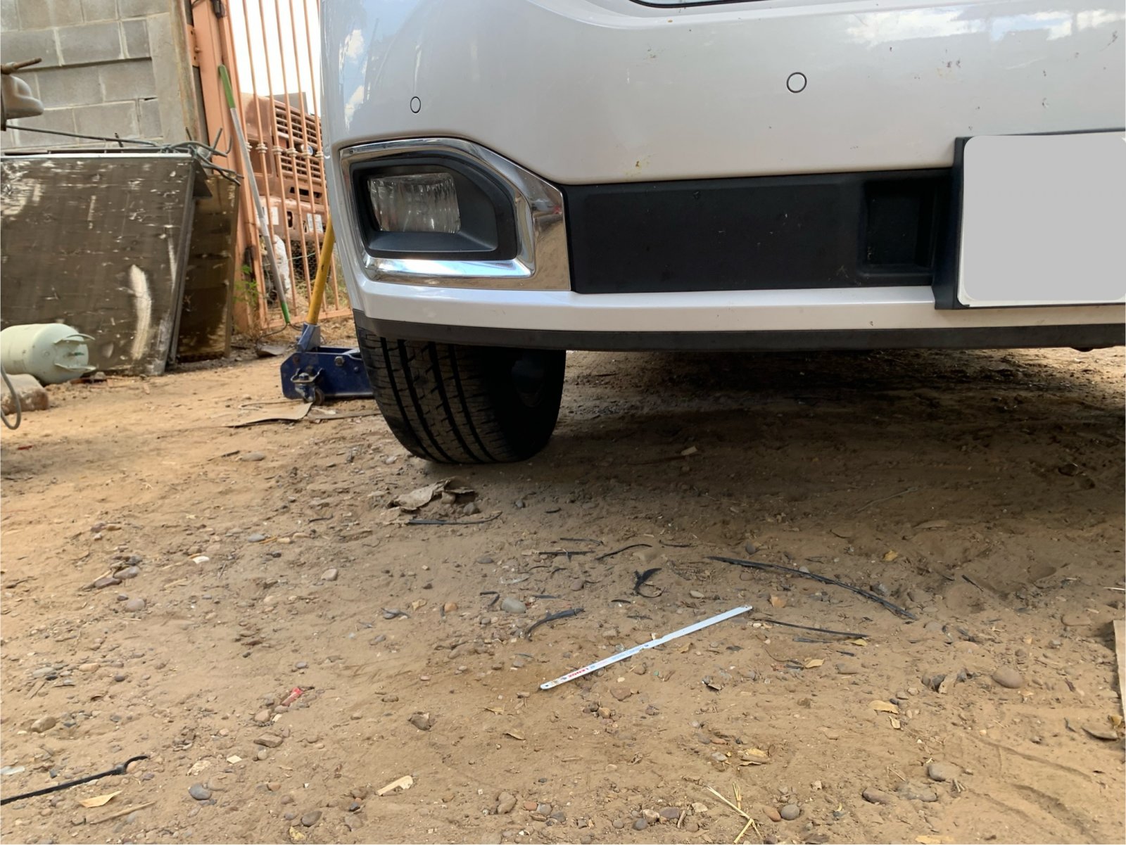

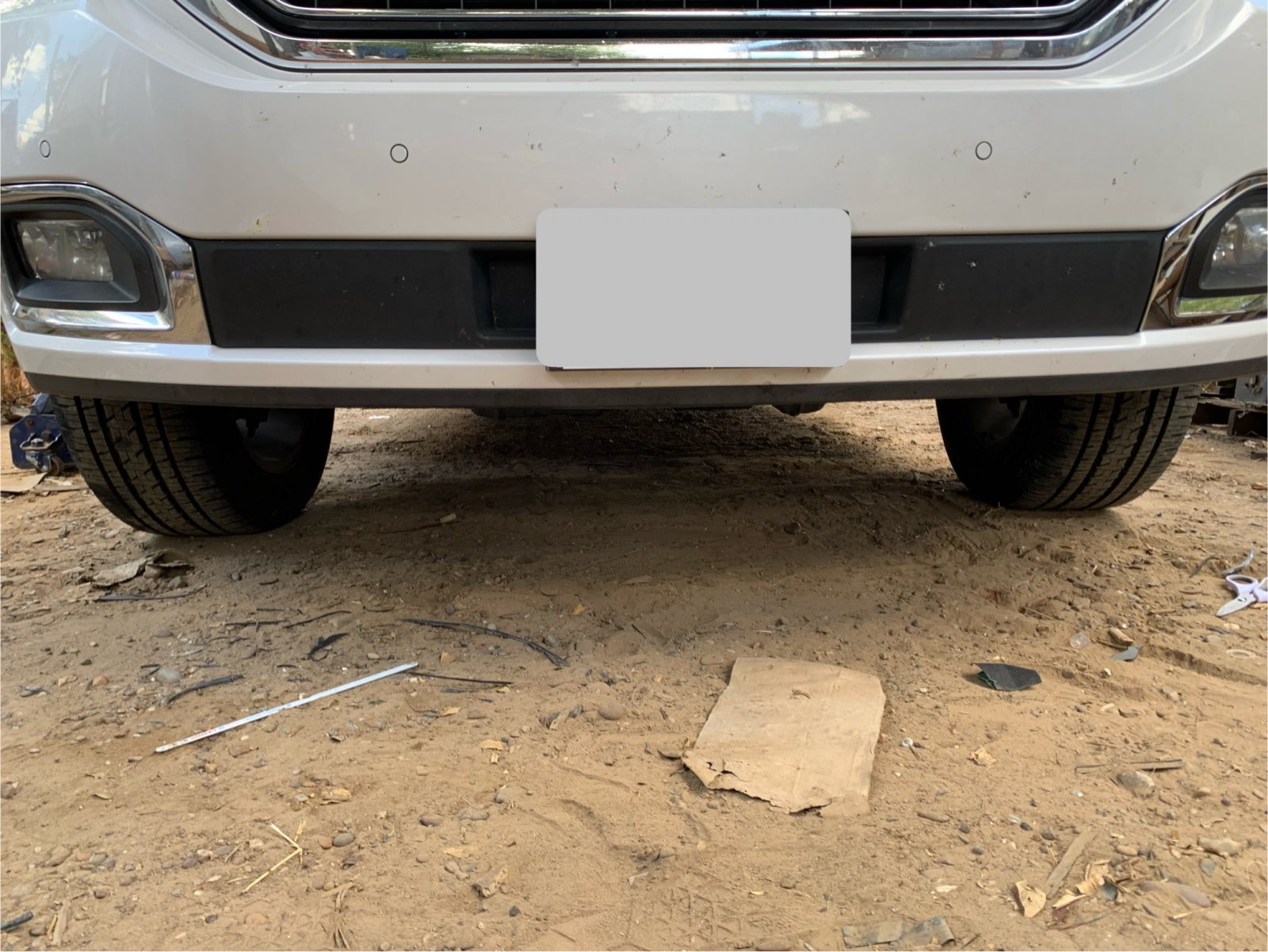

Finally trimmed the lower front valance.
Overall width is now 1 1/8”
Looks pretty trick if you ask me.
The only tools you actually need are a reciprocating saw and xacto knife. With the knife, you can carve and smooth out any jagged edges if you don’t feel like sanding the plastic down- just a keep straight hand.
Next mod is 2” front lift to level out the Yukon.

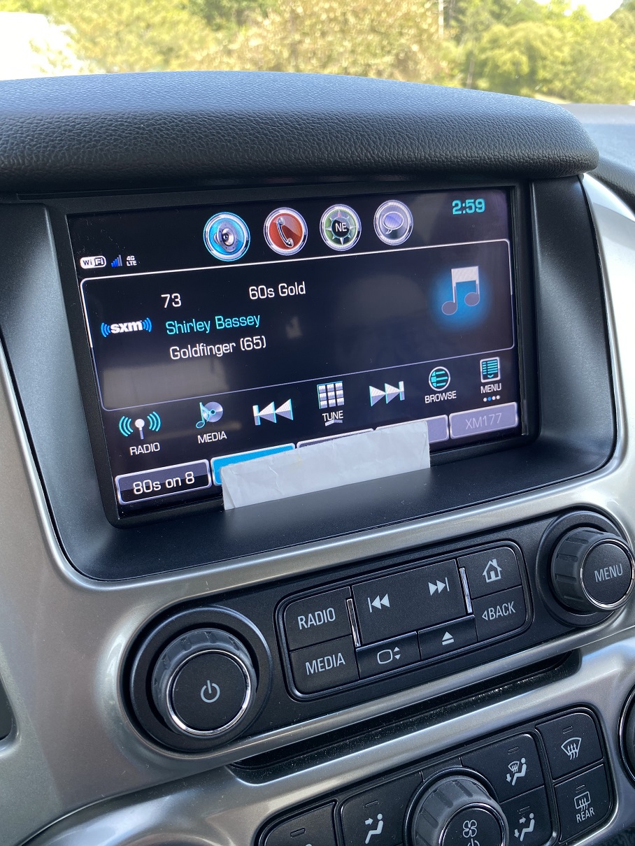

Touchscreen on the radio system started fouling last year. Got much worse lately. See lots of Youtube videos on this. Tried a couple fixes, no help. Recalibrated the screen, helped some actually but still ghosting. Figured out that with the screen up it goes dark but the radio and XM works ok. Put the screen down on a piece of thick paper and the display works fine, backup camera also, but the touchscreen goes dead. Knobs and steering wheel controls work fine. I'll live with that but I suppose it will need the membrane and face replaced at some point.

i replaced the one in the wife's burb couple weeks ago, seems to be working fine now. it's normal for the screen to go black when in the up position.
took about an hour or so to r&r

Where did you get the screen panel? What was their part number for this? I see several for the up to 2018 models but little for a 2019. Might be the same? Did you find a youtube video for the one with the moving screen with the storage pocket behind?

I replaced it on the wifes 2016 (the 8" that lifts to expose the cubby with usb port), I did find a mostly helpful video
once I had it out of the vehicle I just took it to the kitchen table, put a bath towel down and set it on there so nothing would be get scratched up
you will need some long small screw drivers and torx type also, a pick tool is helpful as well, note how the ribbon cables are routed in the cage (take pictures)
and use caution handling the ribbon cables and ends if you crack or break one of those then you will have to source one from somewhere.
i know the screens are all noted for 15-18 but the same part is also noted to fit 2019 also in the compatibility list
this is the screen with digitizer, it arrived in about 3 days but I think the shipping location is not far from me

Thanks for the info. I see some of the screen replacements are only the membrane and glass while this one does have the panel with it. Sure hate to tackle those push in fasteners on those dash panels. Easy in, a bear to get out.

ya doing just the digitizer is probably not for everyone myself included, for $30 more it's a whole new part. R&R and done.
