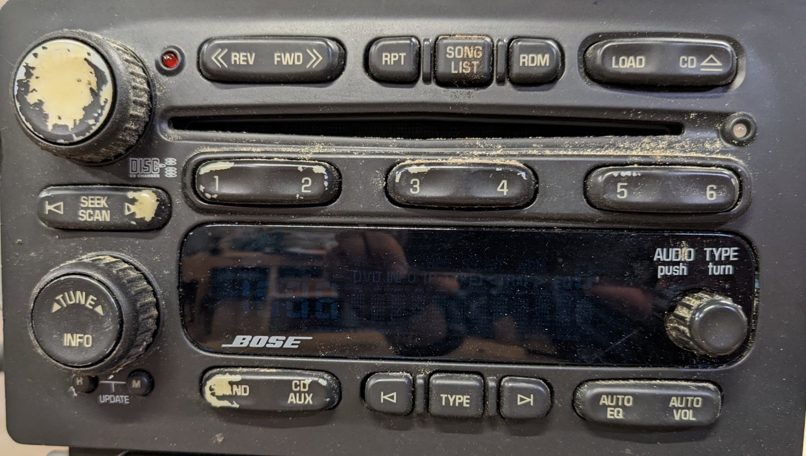

I'm working on Bluetooth receivers for 2002-2006 GMC Trucks/SUVs. For the head unit that does not have the 6-CD changer built in, I am able to fool the head unit into thinking I am an external 6-CD changer, so that the aux input can be selected. But that doesn't work with the head units that have the CD changer built in:
Does anyone know what external devices are compatible with this head unit, that you could select the "Aux" input?

Other factory devices that can be connected to it are XM receiver and RSE DVD player. Actually, I'm not sure that is true for 2002, but it is for 2003-2006.

Yeah, I've had a couple. First one (which sounded the best) hijacked the XM but tapped a few wires on the back of the radio and gave a true 3.5mm aux input. I ended up plugging a bluetooth receiver into that. The second is this all in one device that also hijacks XM but has a slick tee harness at the actual XM radio in the glovebox. I don't know if I'm imagining it or there's either no or different DSP, but it doesn't sound as good as the other one which I've long since thrown out because I couldn't find the instructions and just haphazardly removed it.
Second device:
USA Spec BT45-VETTE Bluetooth Music & Phone Interface for GM Class2 Radios with XM (Satellite Radio) Capabilities
Neither of these are selectable via CD/Aux but rather XM.
Thanks, Doug. Exactly the info I was looking for.
