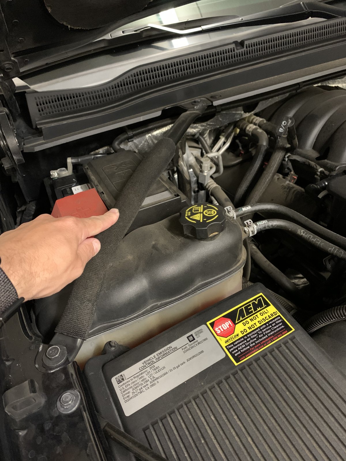

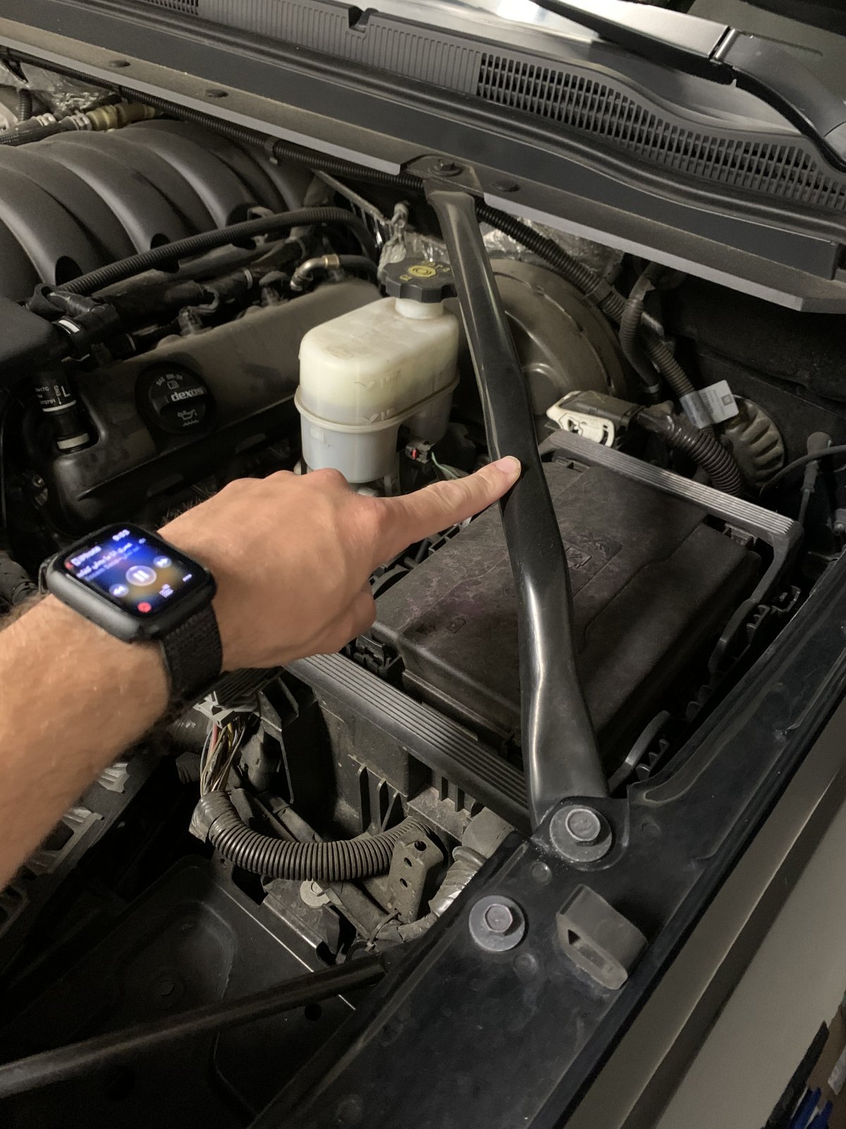

Ok so back in 1999 I had a straight V6 Jetta the torqe was awesome however the factory sway bars were crapola.
So nuespeed sold a sway bar that attached to what I am seeing in the Tahoe engine bay but unsure if these are sway bars or what there used for.
I doubt they are sway bars...but hey I could be wrong.
What are these for and what do they do ?

They are just support brackets for the fenders, sway bars are under the vehicle

Yes, those are definitely the sway bars. Don't believe what these other fella's are saying. Also if you haven't already, Check your blinker fluid whenever you get a chance.

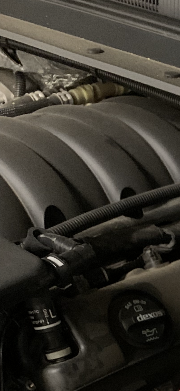

OK instead of creating another thread can somebody tell me what this covers for it looks like it’s got baffling in it to illuminate some sound from the engine maybe?

that is so the engine compartment does not collapse in a crash (in an unintended manner) that reminds me i need to replace mine as it's missing

on the tahoe it's for the small overlap crash test.. as noted only being installed on the drivers side front corner

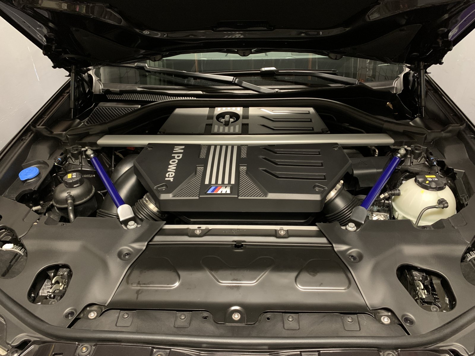

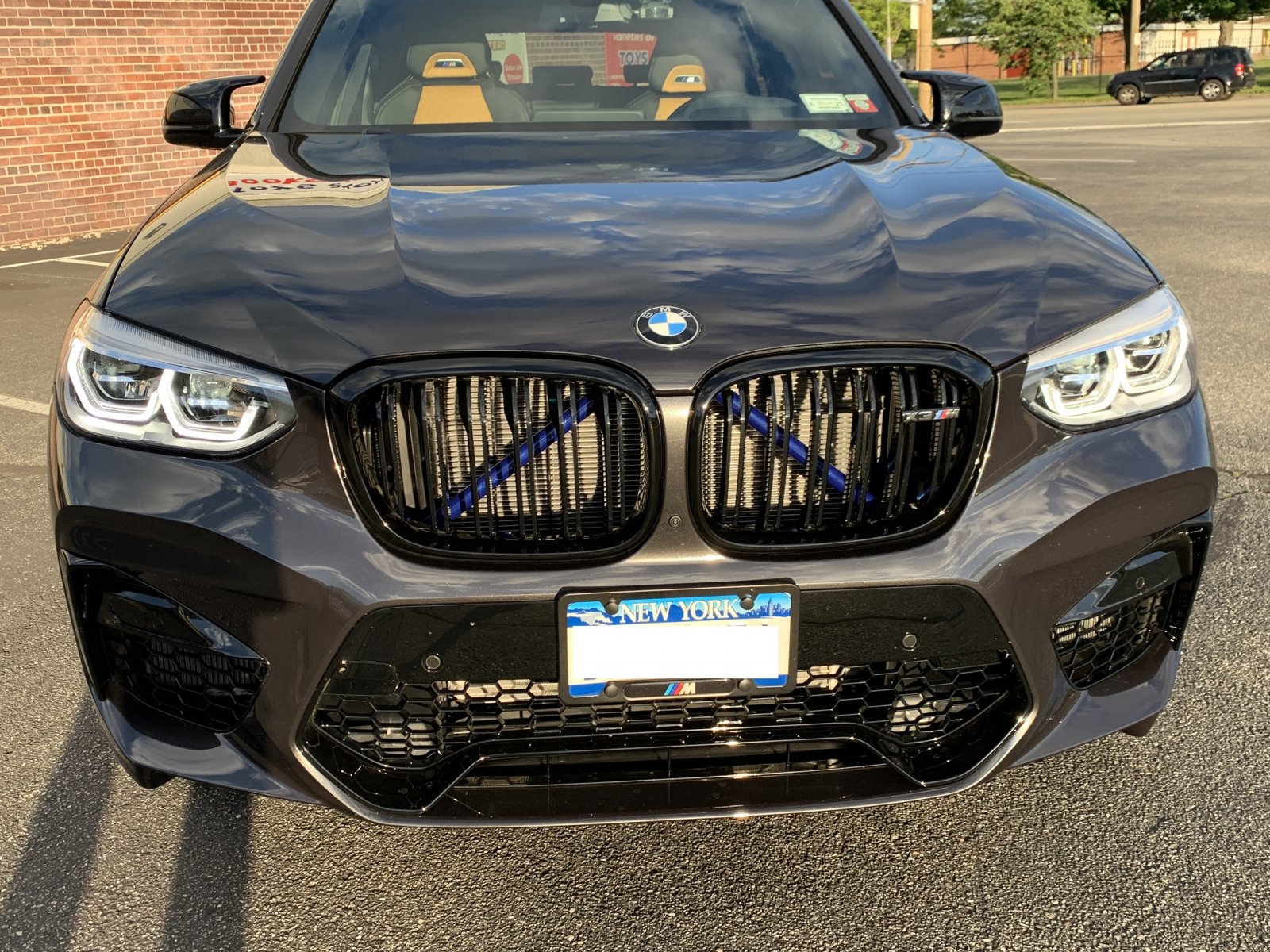

Sway bars, or more correctly "ANTI" sway bars are under the vehicle. There seems to be a distinction between "Strut Tower Braces" (which connect struts together) and "Engine Braces" which are additional braces in the engine not connected to the struts.
There are varying opinions on whether or not these make a difference in handling (by stiffening the front end), my experience is they do.
Speaking of other vehicles, they come stock on my BMW X3M and the Toyota Supra (also made by BMW). I cannot imagine BMW would not stop including these if they made no difference as they are all about cost savings.
If you are really trick, I recommend wrapping the braces in your choice color of vinyl to give it a nice pop :).
Below is my X3M with both a strut tower brace (not wrapped) and engine braces (wrapped) along with the "V-brace" (wrapped) behind the grill.
