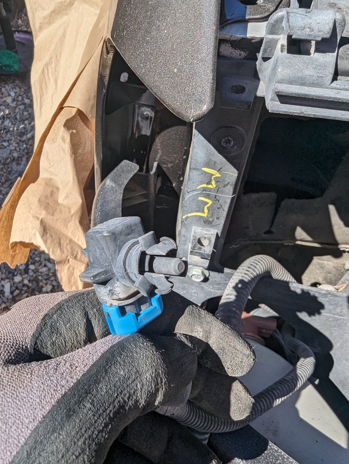

Hello all,
I am new to the forum. First post and looking for some help. I have done a full paint restore on the 'ol Yukon. All that could come off did. Months later I cant remember where this goes, or what it is for that matter. I have it all back together since this picture. Working through this and some codes it is throwing out. Thanks in advance.

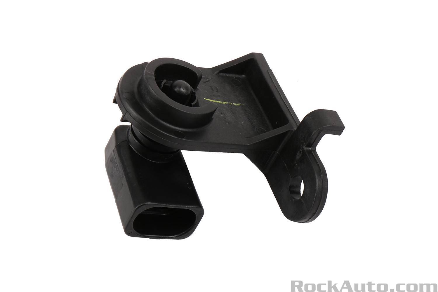

like stated it is a ambient air temp sensor, usually they mount up on the radiator support bracket, it doesn't have to go exactly where it was just where it can read the air passing thru, so not behind the radiator or external trans cooler (if equipped) otherwise it will read incorrectly. to the side of the radiator or in front of it is fine.

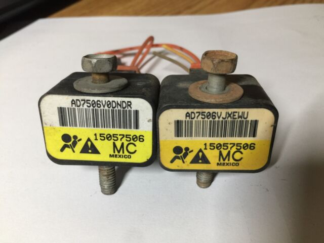

These are the only style of sensors I'm aware of, besides what's under the seats:
not sure what year's they started but a smaller version of those can be found inside the door's also for side impact detection. they are mounted in the center of the door on the center brace
Thanks! Got any pictures? We should post a thread with all the GMT 800 sensors like that and sticky it.
