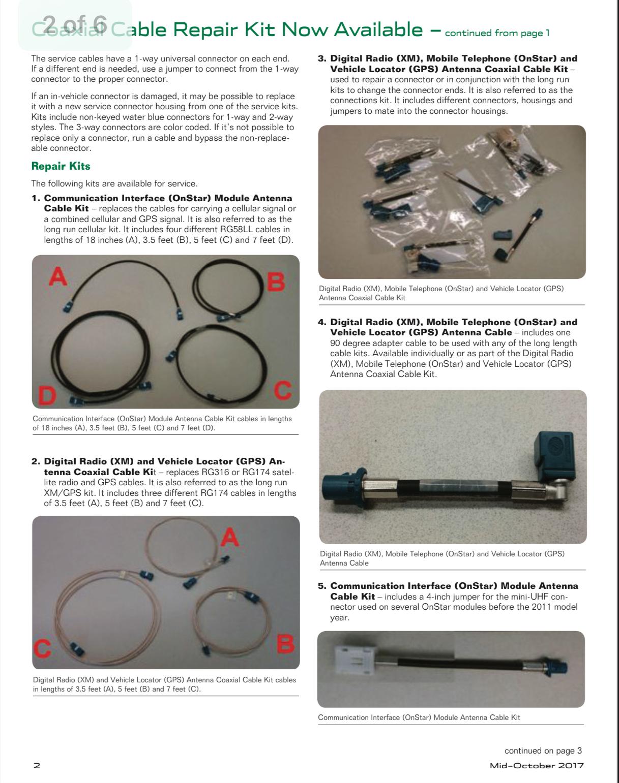

This is 2017 info, not sure if GM has the parts still or uses this strategy for repairs.
https://techlink.mynetworkcontent.com/wp-content/uploads/2017/11/GM_TechLink_20_Mid-October_2017.pdf
