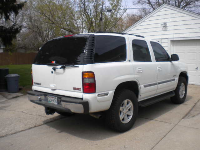

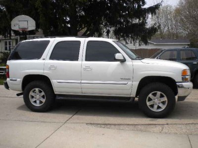

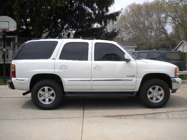

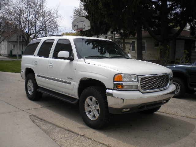

I know a lot of you guys are not a fan of the lifted trucks, but I am getting too freakin' old to be bouncing around all the time. This thing rides better than a Cadillac! I am going to take the side molding and badges off as soon as it gets a little warmer. And yes it's dirty, the weather has not been cooperating lately.

Nice...I like it. Tastefully lifted, not ridiculous. That's probably the route I'd take if I had more money.
What size/kind of tire? Pics aren't quite clear enough to make it out.

I put 2" ebay spacers, 2" max suspension keys, Edelbrock 2" lift shocks (#63050 & 64050 $25 a piece on edelbrock.com) 295/70/17 Nitto Terra Grapplers, 2010 GMC Sierra 17" wheels. The front sits @ 38 1/2" and the back @ 39". I have the keys adjusted to about the middle of the bolt. The ride is BUTTER! And yes I did it all myself. Anthony, I assume you got that drop on w/no problems?
