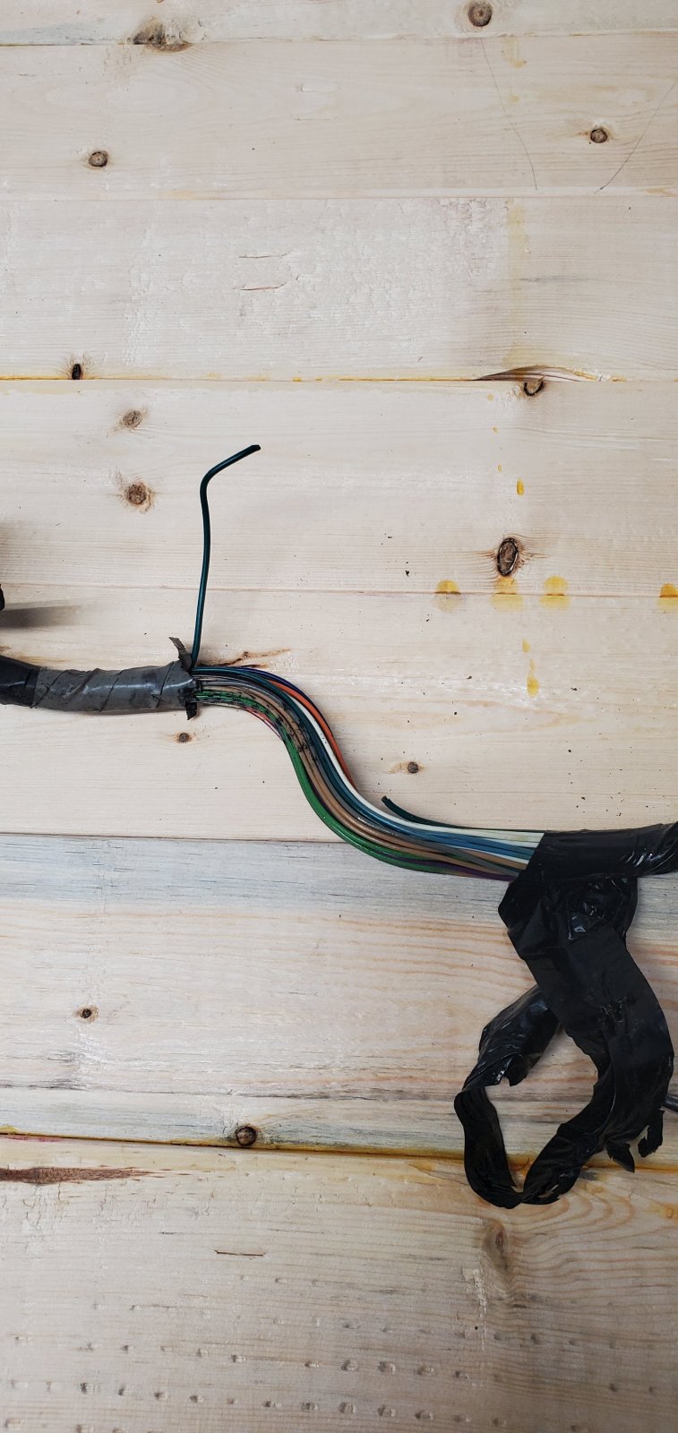

Im getting complete no power to my driver door was wondering where did you find your break in the wire

When you open your door there is a loom of flexible conduit that goes from the door jam to the door. If your rig is the same years then the inside kick panel, next to parking brake pedal, can be removed and that exposes the wiring coming inside and there is a big plug there. Anyway, the loom protects the wiring and over the years the wires work back and forth and rub insulation and the wires get exposed or broken. Look in there.
