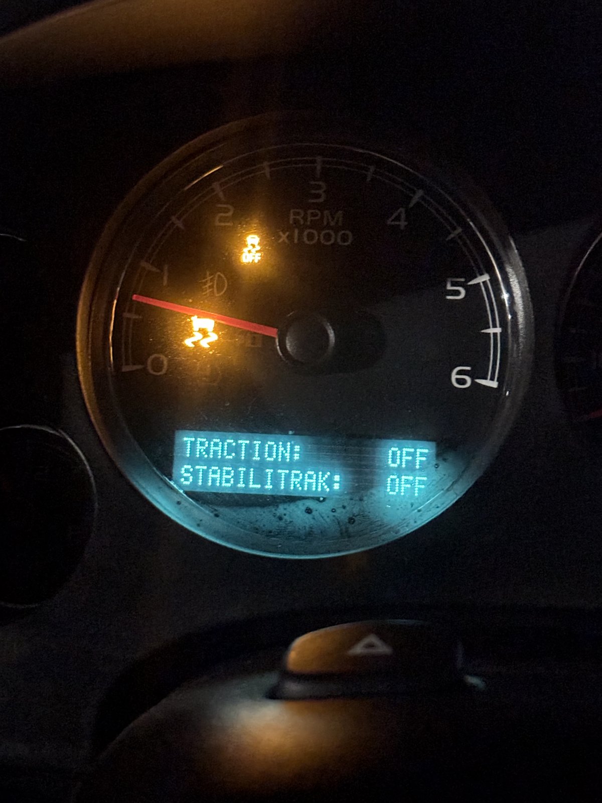

was driving to work and she just started throwing these lights

I’ve unplugged this sensor to work around it while doing my shocks months ago but I’ve plugged it in since. Now it’s showing these lights as of this morning after taking a sharp turn i guess. I tried unplugging what I thought was the right one and plugging it back in, but now the ABS light is on and wont go away idk what I’m doing. Idk if it being -30°F has anything to do with it.

what did you do to the shocks?
there's a plug on the top of the frame rail at the passenger side rear. it commonly gets bumped and unplugged when working on the rear shocks. you can't see if you gotta feel for it up there.
byond that you're going to need fault codes to point you in the right direction.

dang, i swore that the tcs and stbltrk plug was on the drivers side. that would explain the ABS light! ill check that out... if it persists ill try and get some codes

it was plugged in and than the lights jsut started flashing, mustve goten knocked loose

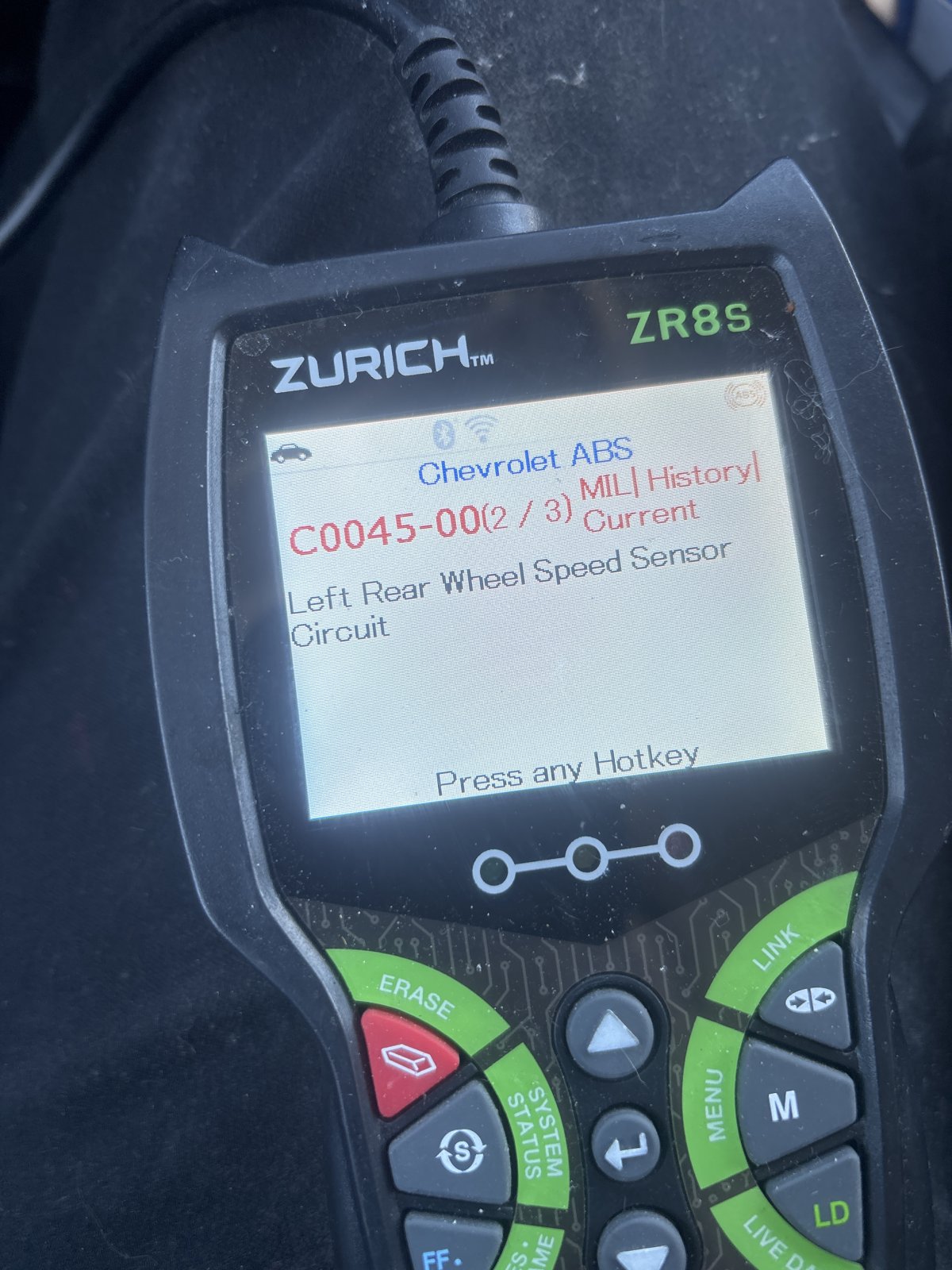

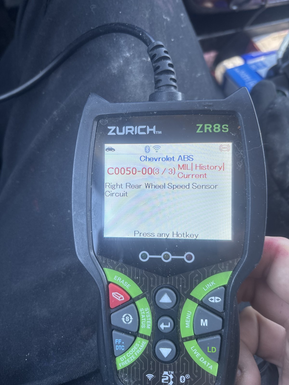

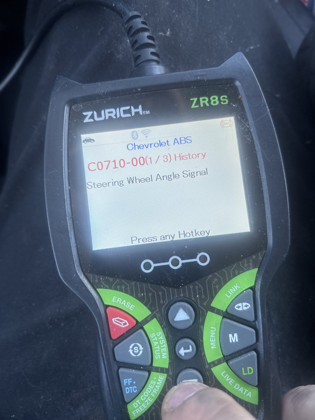

These are the codes I got. Not sure where to go with this?
Replace sensors? Wait till it warms up to see if it goes away? Disconnect and reconnect battery to reset ECM?

I don't know your scanner, but this look like history codes. not current. those take a long time to clear themselves. some take like a 100 key cycles.
I don't see any current codes? I'm not really sure what you got going on there. maybe someone else will know.

ya... plugs are secure, unplugged and plugged just to make sure... i guess all i can think of is cold weather. if it persists ill take it in tomorrow. man if it wasnt so cold out here in the midwest. i wouldve had my gas tank dropped and evap lines blown out and had this taken care of smh

tried clearing thecodes to, only one that went away is the steering wheel angle sensor
