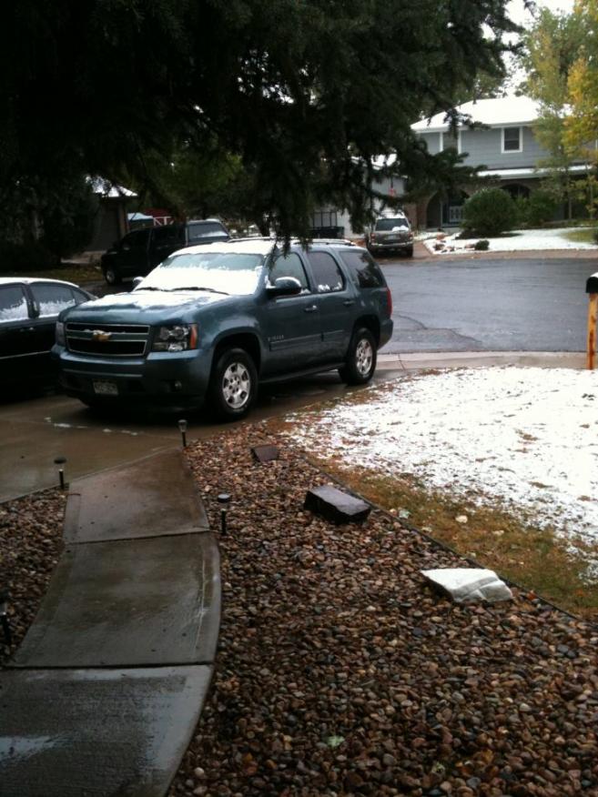

I have an 09 LT2/5.3/6speed/4X4 and I want to put 6" to 9" of lift, but I have a family and the money would not allow. Also it would be hard for the wife to get the toddler in.
So I am thinking about a spacer kit with rancho quick lift front and new rear.
I was thinking about this spacer,
http://www.ebay.com/itm/LIFT-KIT-BI...oe&hash=item2ebd1b6fca&vxp=mtr#ht_1849wt_1185
I would go with the CCM but want more this one gives maybe 3.5f/2.5r.
I also want to run some XD series wheels 18" and 33/12.50/18 nitto mud grappler.
Questions
What does the quick lift give you by itself?
Also do you think with all that I want could I do 33" without rub?
(i guess it really does not matter I do not mind trimming but still want to know)
As you can see in one pic I am not afraid to get dirty!!

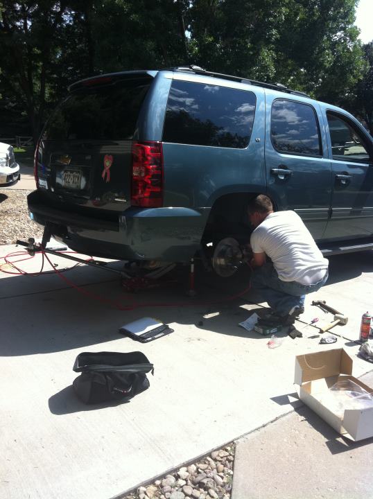

Well I ended up putting together a kit from the Rancho quick lift loaded and a 2.5 spacer and then the box 1 from the BDS 4" lift w/ knuckle. Then did a 3" spacer on the rear. This got me 4.25" in the front and 3.5 on the rear. It gave me a level stance with 9" between top tire and wheel well. I also went with Xd revolvers and Nitto Mud Grappler 33/12.5/20.
The set up looks awesome, When I get home this time I have a few finishing touches and then I will post some pics.
