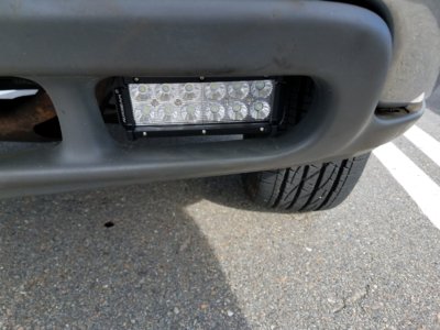

Alright guys. I took a look at mmeachem's links and had a set of brackets made up at my work. I am a mechanical engineer at a lighting manufacturing factory so I have the advantage of having sheet metal turret and laser machines and press brakes at work.
I managed to get the guy that runs the mahine shop to run me some brackets out of 0.046" Galv. Steel after drawing up a quick print from measuring the stock plastic bracket.
The brackets came out slightly short because I didn't account for the drop of the ears on the side so I made up for that with a bunch of 5/16" washers lol.
I used these lights that mmeachem recommended:
Auxbeam LED Light Bar 7 Inch 36W CREE Driving Lights Flood led off road lights waterproof for Jeep Off-road SUV Truck Car ATVs Boats (2 PCS)
https://www.amazon.com/dp/B00T8UY53Q/ref=cm_sw_r_cp_api_SyjVzbKC6PCNW
I'll be sure to get you guys a night shot some time soon! Going to do a 4hi mod as well.

One thing I forgot to mention was that he ran me two sets of plates just in case, so I still have another set that someone could use if they want it.
It holds the light great and is solid, doesn't move. Like I said I did have to use a decent amount of washers as spacers for it to get to the height I wanted it at.
