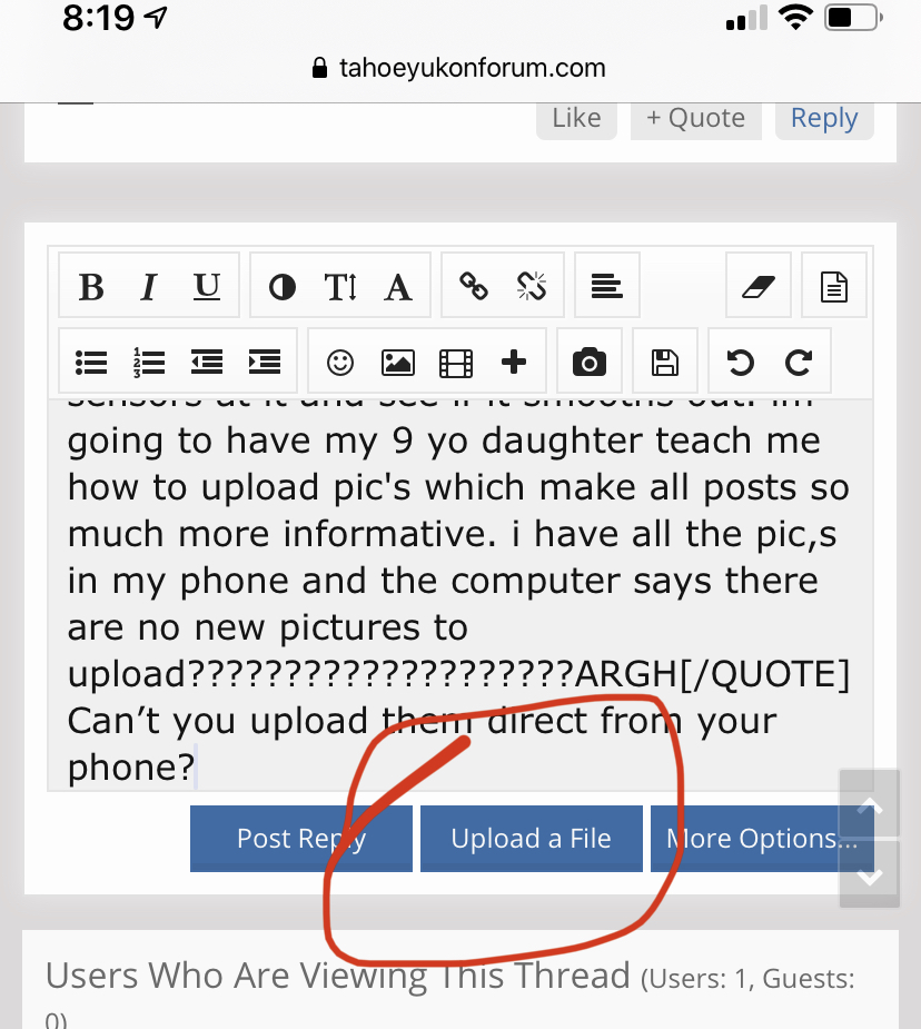

Can’t you upload them direct from your phone? That’s usually what I do.

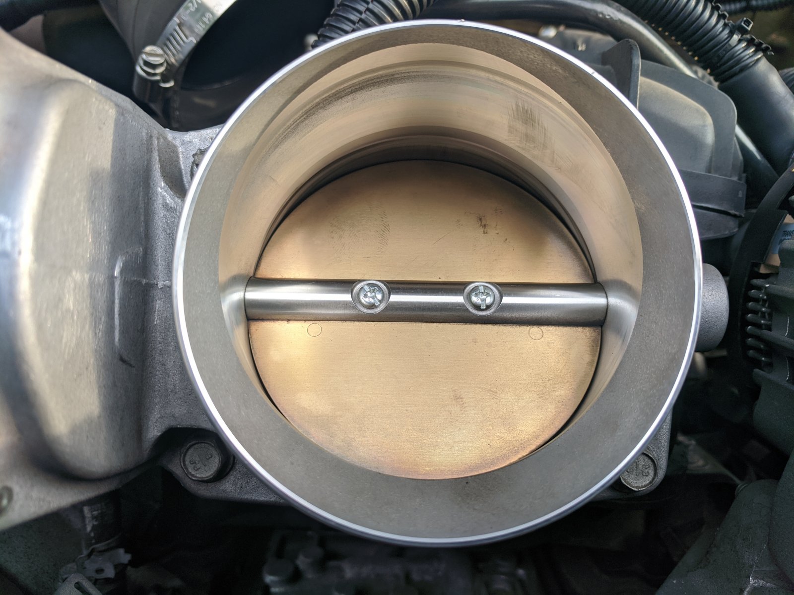

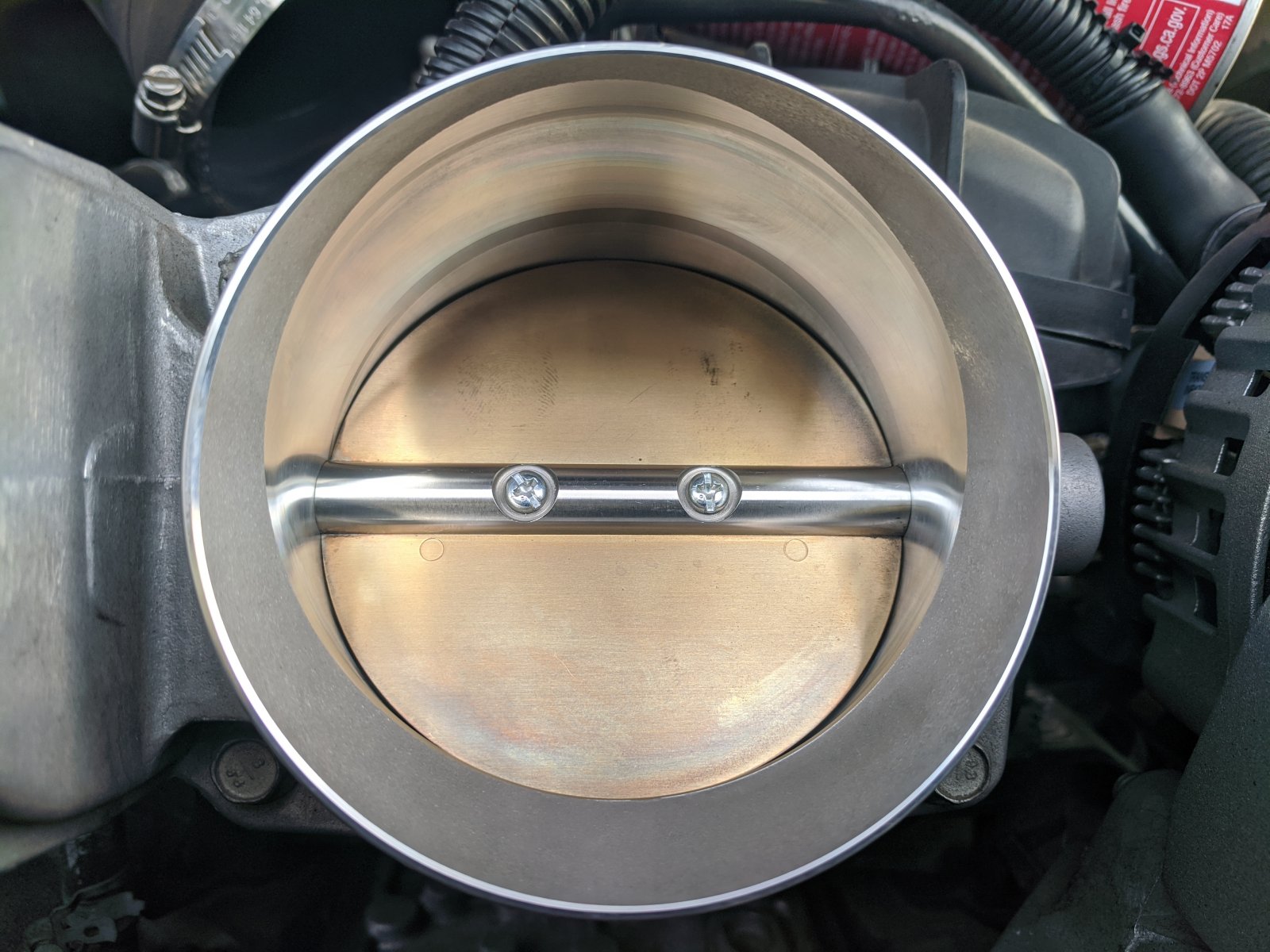

what is your method? are you simply cleaning the throttle body?
I usually pull off the intake pipe, pull out the maf and spray the crap out of it with maf cleaner and set it to the side to dry, then I get a soft rag (one that doesn't leave lint) and spray both the rag and the throttle body with throttle body cleaner and just hold the plate open with a finger while I clean all over with the rag, it's ok to be generous with the spray wont hurt anything, usually give it a good 2-3 times over reaching in the intake as far as I can, when you don't get any more black smudges on the rag then you know it's clean enough. then put the intake pipe back on and put the maf back on. sometimes when you use a lot of the cleaner it can make it idle a little rough for a second or two when you start it back up but it clears right up.
only tip I can give you is DO NOT pull on the throttle plate hard, just hold it enough to keep it open it's only going to move so far and stop, then just make sure you have the intake all back on correctly and tight, if you get it back on ****-eyed it can suck unmetered air in past the MAF.
30,547
47,997
Just went out and did it, this is before and after the shadow on top of the plate is just from the light, as you can see it doesn't get very dirty since I keep it clean, seen some that are caked in black soot like a dirty chimney
