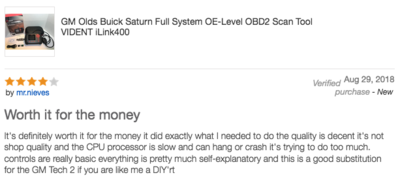

I think so.
Would like some confirmation from a real human on here though :)
