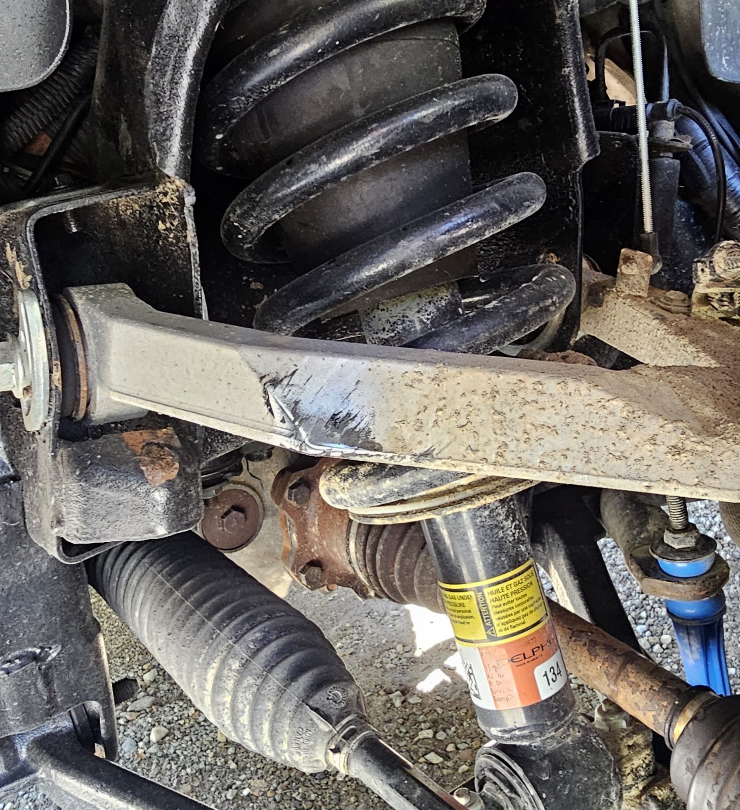

When changing the oil this weekend, I discovered that both my tires are rubbing the Rough Country upper control arms. No to bad and only about the last 1/4 turn from lock.
I don't know what that black schmoo is. Feels kinda greasy.
Checking the tires and they appear undamaged but had rub marks for sure.
Want to keep the RC control arms as i have a 2 1/2 inch (ish) strut spacers on it and the ball joint angle is almost perfect. Don't know if i can train my self to never turn sharp when moving.
If i put the stock arms back on the ball joint will have a bad angle for sure and be closer to the bump stop.
Trying to decide on what way to go.

Well, I did not specifically put them on for 2 1/2 in. I left them on from a 4in lift that was junk I tried putting on. RC 4in spacer lift was just junk in my case, Might be good for someone else.

I don't understand why you guys replace the uppers when leveling. My 2012 has a 6.5" lift with stock uppers since 2013 without issue.
I was under the impression that if you lose too much droop, ride and handling go to poop. ?
It seems like most aftermarket upper a-arms require a wheel spacer..

I will probably lose a little droop but not enough to matter?.
The only time a person would know it is when it hits the bump stops. Mall crawling will never affect it. Im in the woods often so i may beat the snot outta the bump stops.

True i guess. I'm talking about that little piece that stops the arm from dropping on the front bottom of the mount pocket.
I have 17 in wheels and that might be contributing to the problem also. Any case, stock arms will cure it.

Don't really wanna run spacers. The tires already are very close to rubbing and spacing the wheel out further will just toss mud up on the sides more.
