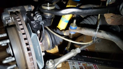

if you dont want to pull the hub, just pop the upper bal joint, lower ball joint, tie rod end, abs wiring and pull the whole knuckle, hub and axle as an assembly. Its not the ideal method, but it can be done this way.
That's what I was going to say; just unbolt the CV axle from the diff flange and then remove the spindle (as required anyway) with the axle/hub attached as a big a$$ assembly.

My '02 Tahoe 4x4, 166k mi, 2nd owner, Indiana car, everything rust welded. I just overhauled the front suspension, replacing everything but pitman arm and idler arm. The YouTube videos helped a lot, with two notable deviations:
1) I didn't need to pull the half-shafts to replace the lower control arms. Wiggle and persistence did it.
2) I didn't have to unload the torsion bars.
The hub bearings were factory and a PITA to separate from the steering knuckles, but persistence won.
It was a lot of work but it paid off.
PS.: I didn't replace the steering knuckles, but de-rusted and painted it.
