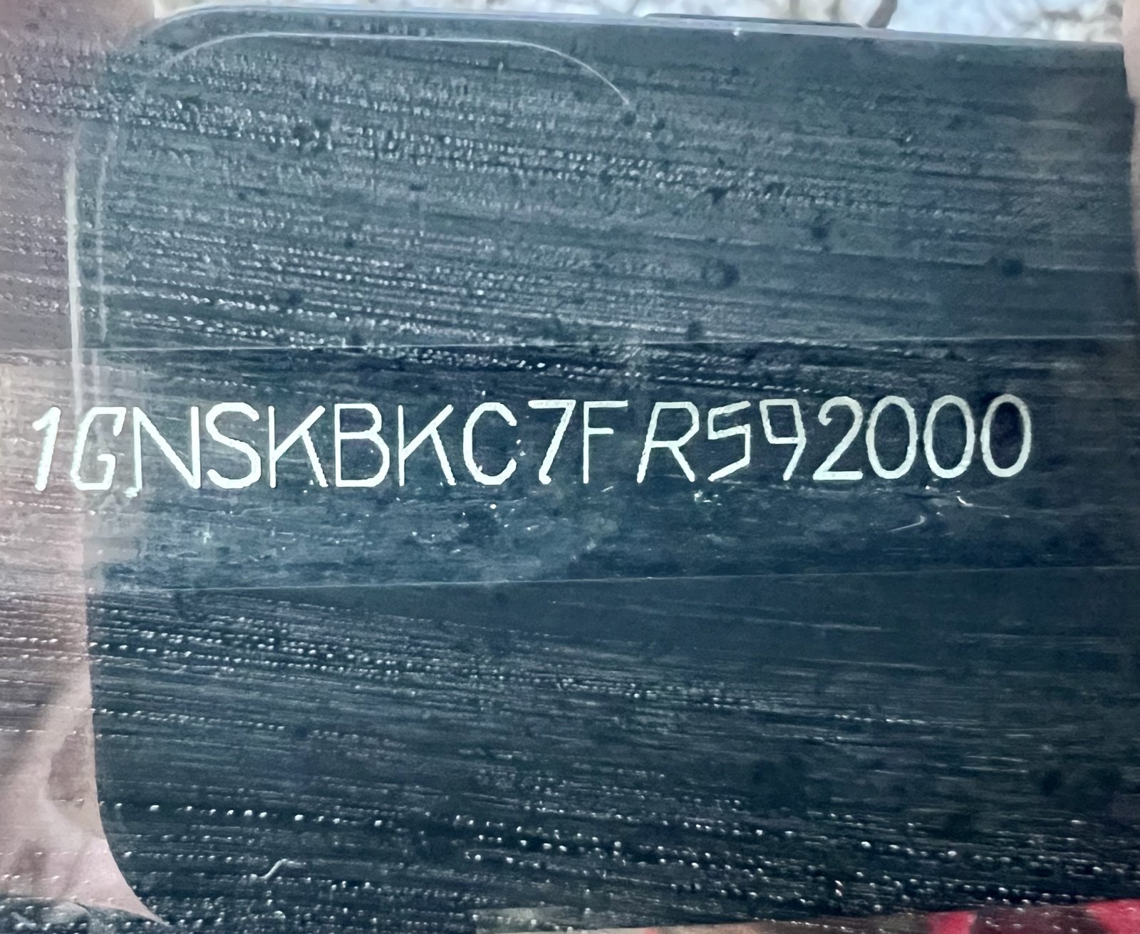

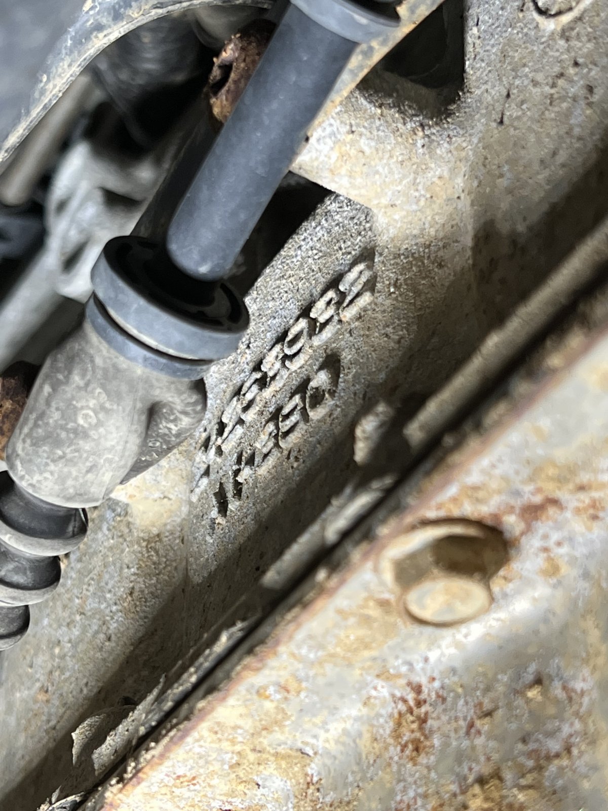

I’m going to do the first fluid and filter change in a few weeks and figured this post would get me started in the right direction.
2015 Tahoe LT 5.3 L83?? See VIN below
6 speed 6L90e?? See pics below
53,000 miles
No current concerns
CARFAX doesn’t indicate any transmission service to date.
Besides the severe maintenance schedule (would someone mind posting a copy of that please and thank you), what might be the first few most cost-effective things to upgrade on the transmission?
2+ quart pan?
Lower temp sensor?
How many quarts does this thing hold and what type - Dextron 6?
Also, is my exhaust pipe supposed to be flattened on the bottom? (see pic)

Yes, the exhaust is designed that way.
The transmission holds just over 12 quarts in total, six quarts are exchanged when dropping the pan and replacing the filter.

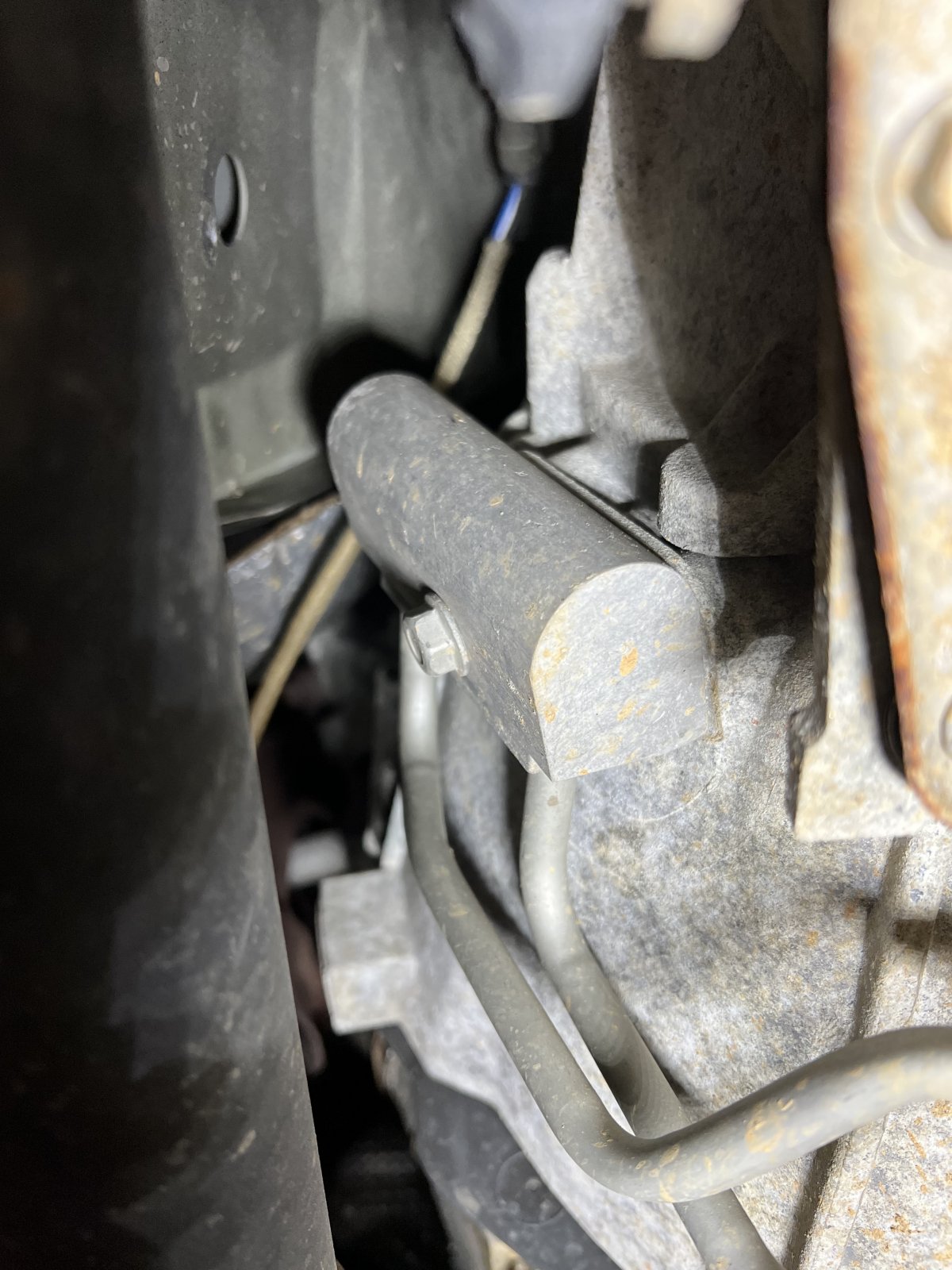

If yours were mine, the first thing I would do with the filter and fluid change is to put in that lower temperature thermostat or "flip the pill". Being in Clearwater, you don't have to worry about the transmission being too cold!

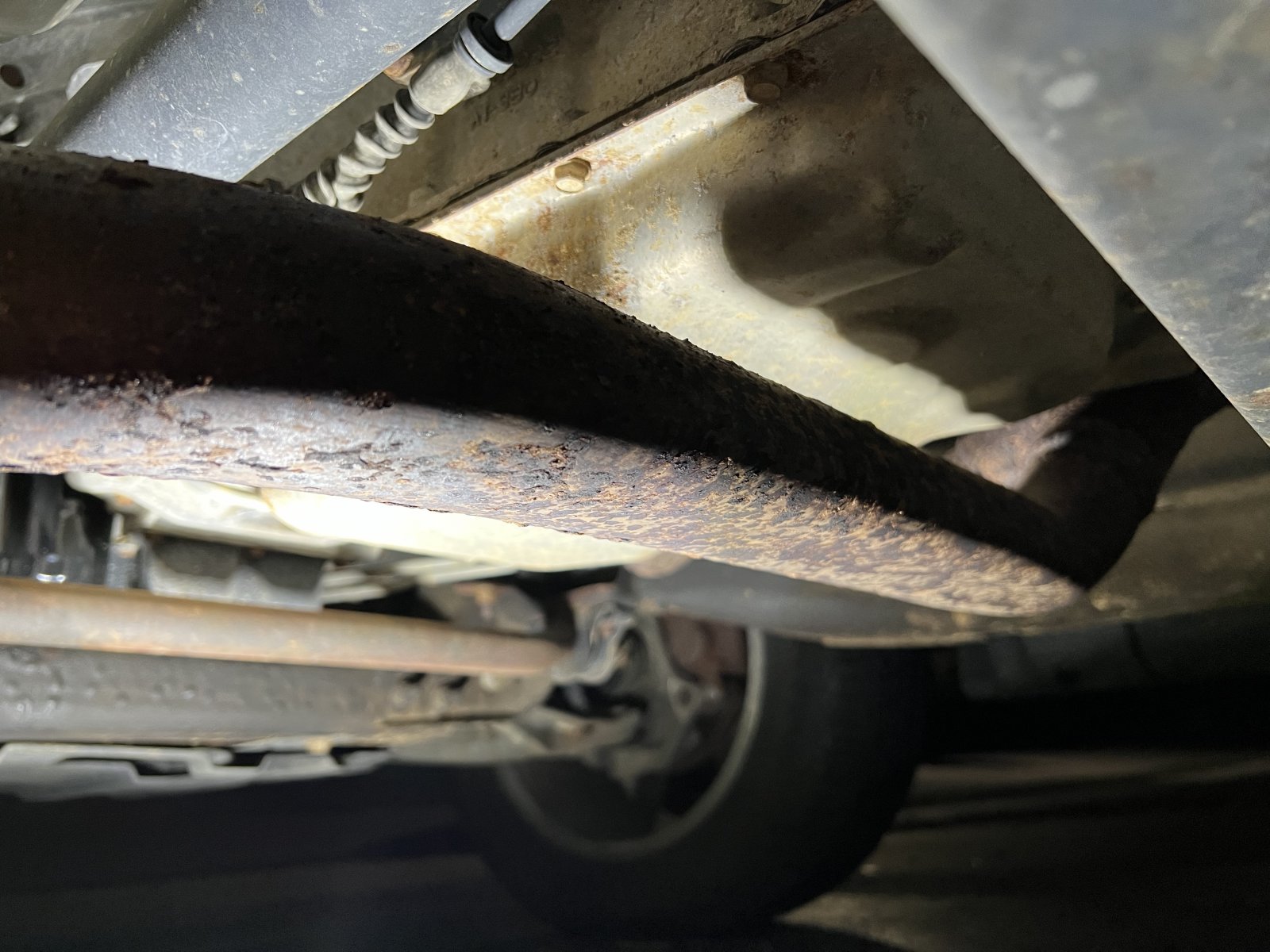

I see a lot of rust or corrossion underneath, is that from boat ramps or Yankee winters? I would address that too with some kind of oil and cavity wax.
Transmission is a 6L80. A gallon of GM Dexron VI Full Synthetic is under this part number: 10-9244 or 88865618.
You can download a digital copy of your owner's manual in PDF form on Chevrolet's website. Our site does not allow such large files to be posted.

The rust and corrosion is from her first 3 years in Yankeetown and I plan on coating it with PB rust prevention.

I began with using an oil extractor pump and pulled 4 quarts out through the dipstick. I then went under the truck and pulled the transmission thermostat housing and ‘flipped the pill.’

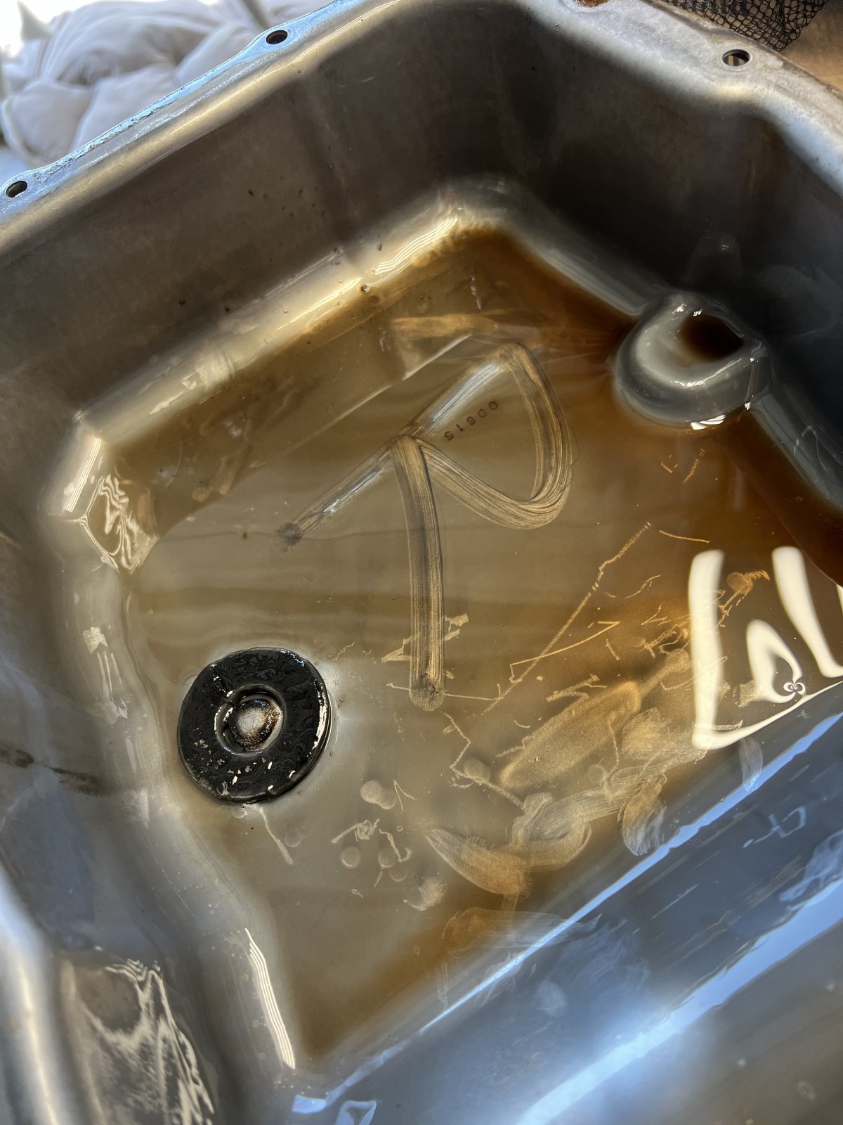

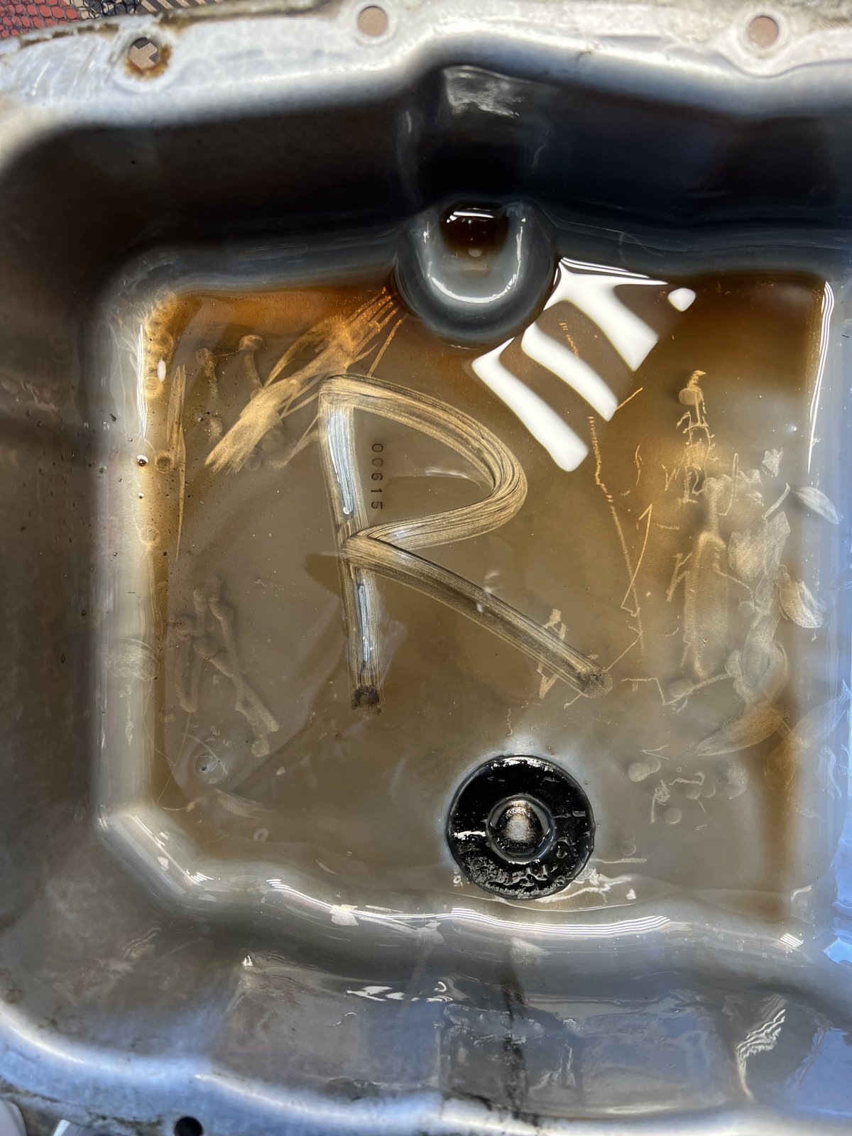

I then replaced the thermostat housing and dropped the pan and changed the filter. I chose to leave the original filter seal in place and reuse it. I was able to suck out another quart from the bottom of the pan.
Call me lucky but I didn’t have to mess with the exhaust as most mentioned. It definitely took some wiggling and shifting back and forth for about 5 mins but then she released.

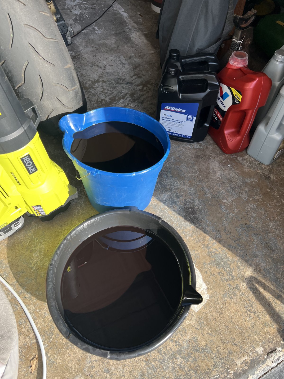

I’ll post a pic of the inside of the pan and extracted fluid.
Cleaned her up, used a new gasket and new filter and put 6 quarts of fresh Dextron VI down the dipstick.
Then I moved to the upper transmission line off of the radiator. It was crazy how fast and how much fluid came out! I chose to use a 3/8” OD hose to fit inside the radiators fitting and had to keep firm pressure to keep it inside while the pump was pumping fluid. I added another two quarts and ran it again until it sputtered.
All in all, I retrieved 11 quarts of dirty fluid with 54k miles on it, 9 of which was very nasty. It is such a great feeling to get the old out and bring in the new.
