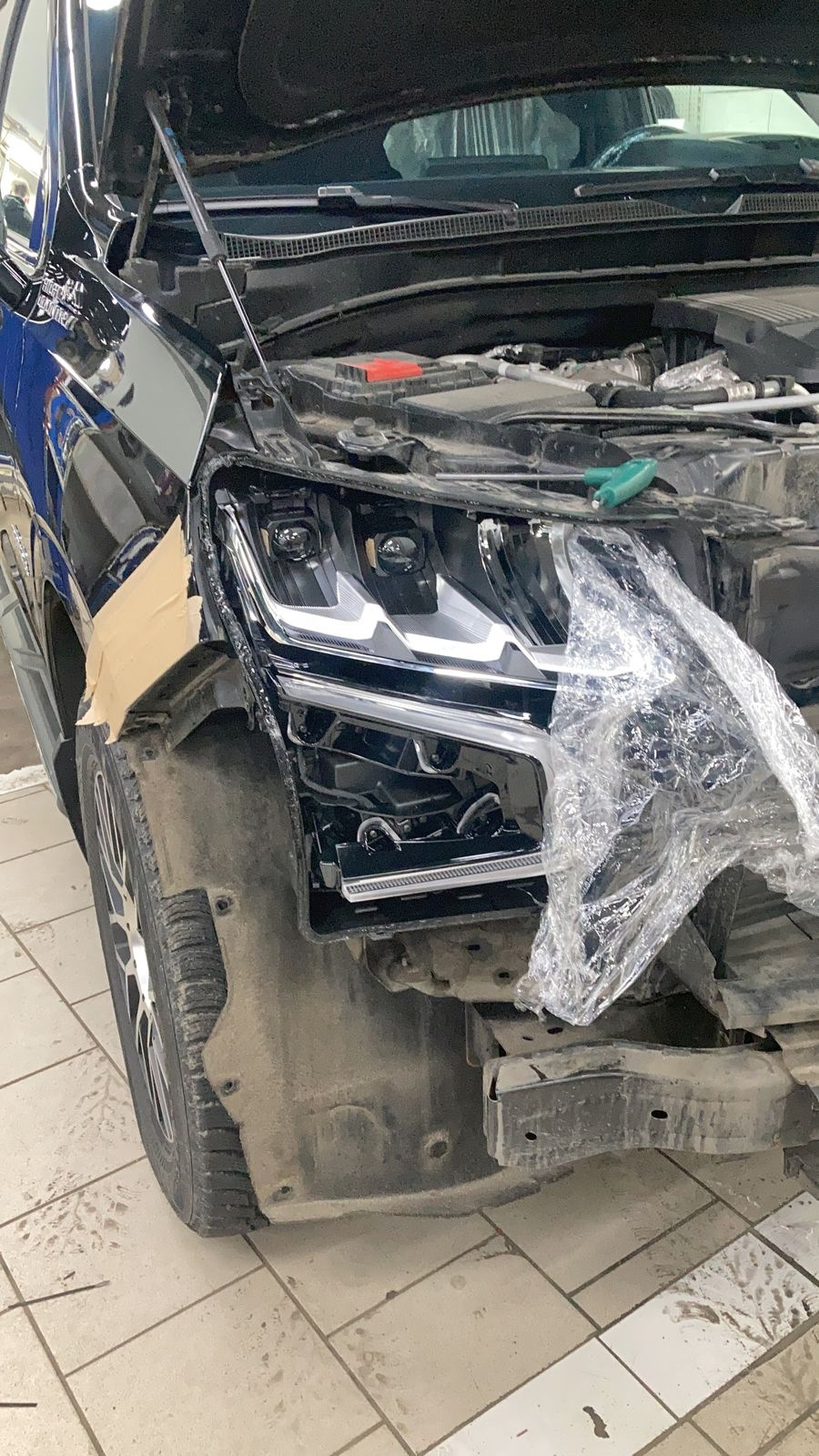

Hello everyone, in one of the topics I posted information on the experience of improving the head light of the Chevrolet Tahoe 21+. I was asked to elaborate on this by creating a separate topic about it. I repeat right away, this car is not mine, I have a Yukon. In general, let's go.
Initially, the light in Tahoe and Yukon is very different. It's worse on the Tahoe. A buddy of mine decided to get some light work done on his '21 Tahoe. He gave the car to the lighting studio, they checked the level of light. Dipped beam gave out 25Lux. And this is how he shone in near and far mode on the wall

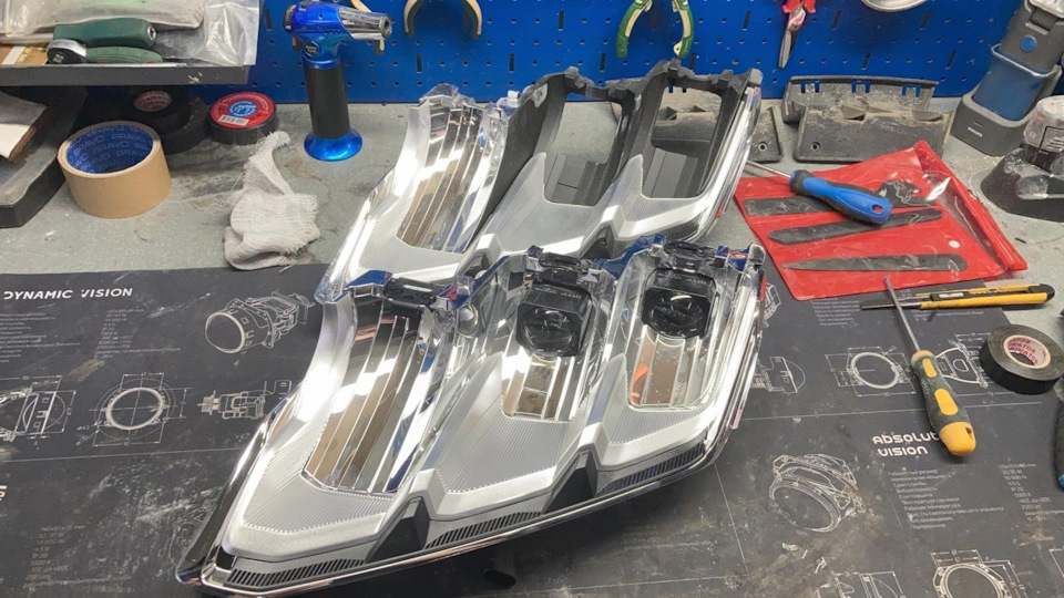

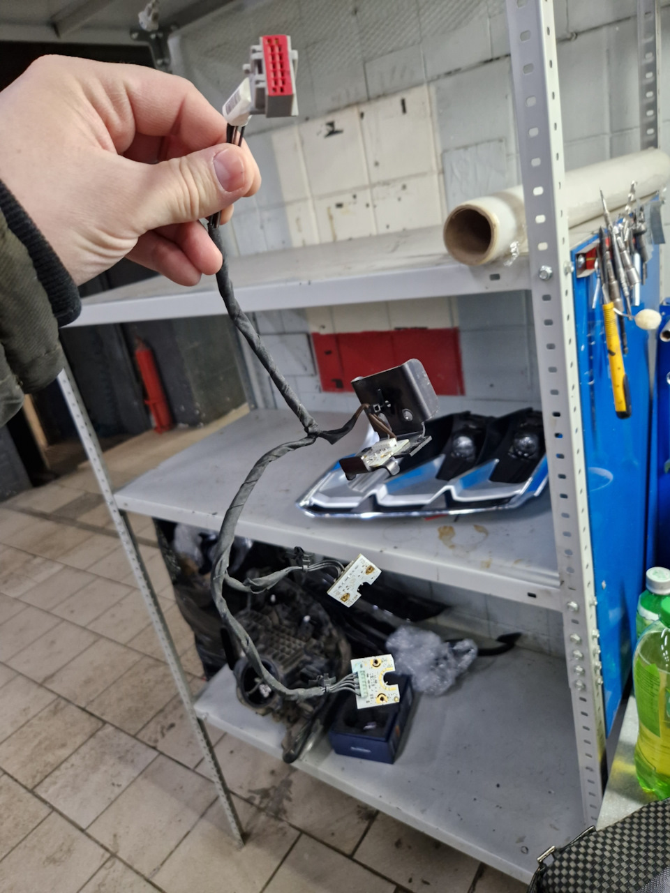

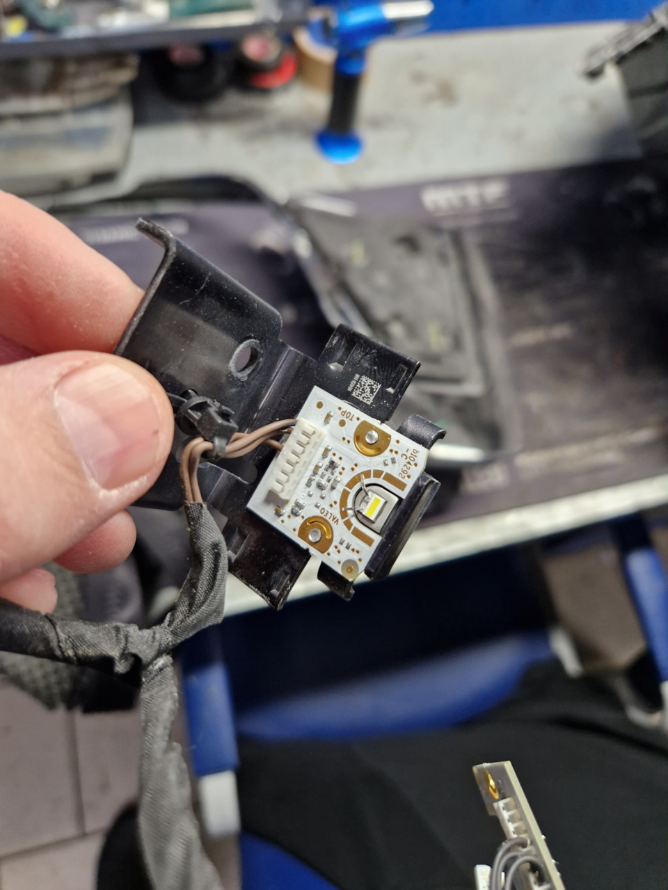

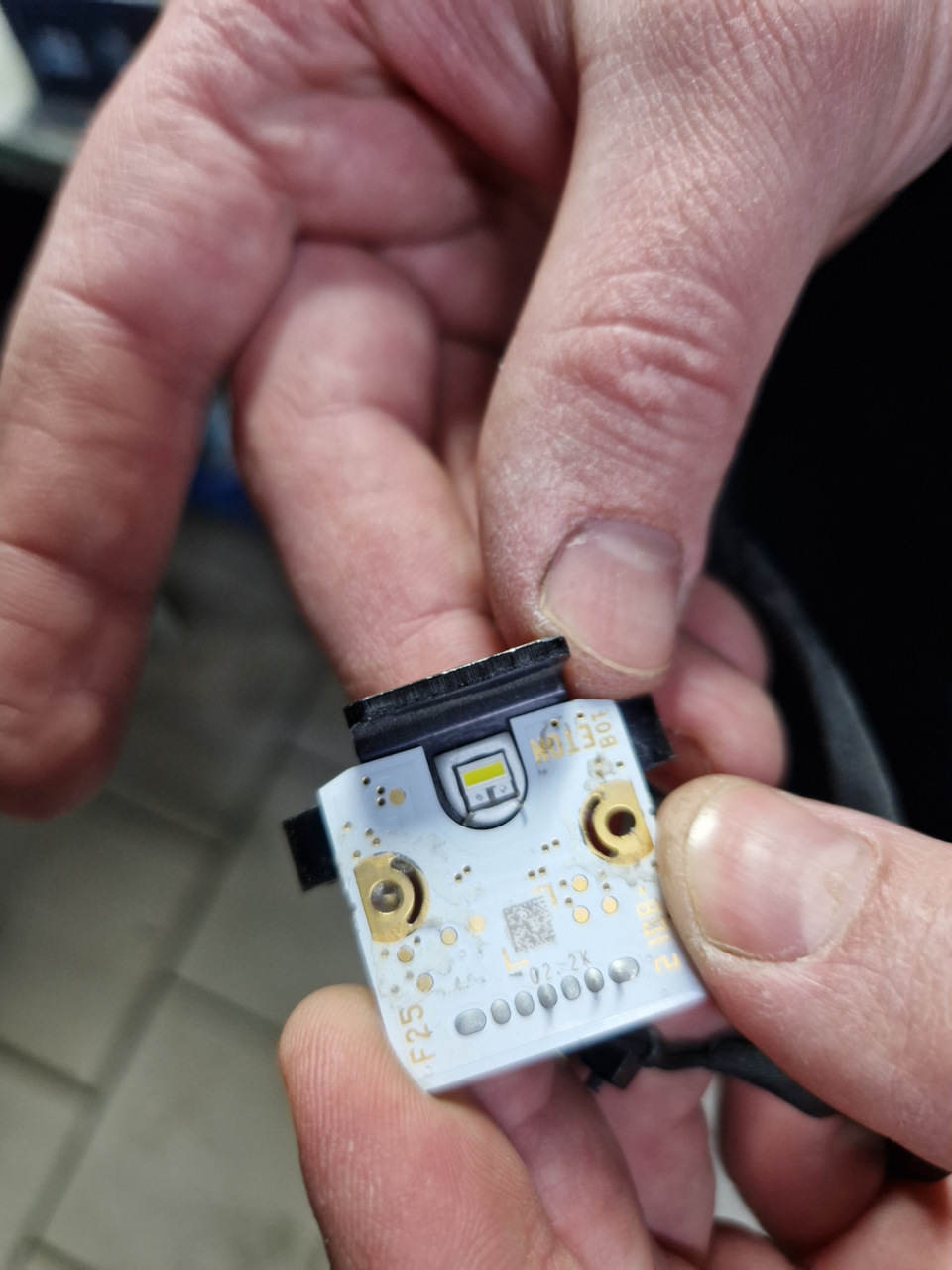

In the studio, the headlights were dismantled and regular diodes were taken out. They looked, frankly, poor. Some cheap Chinese diodes.

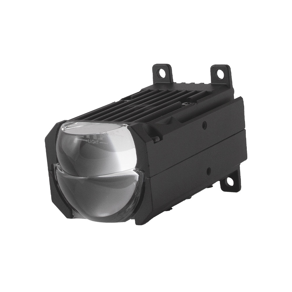

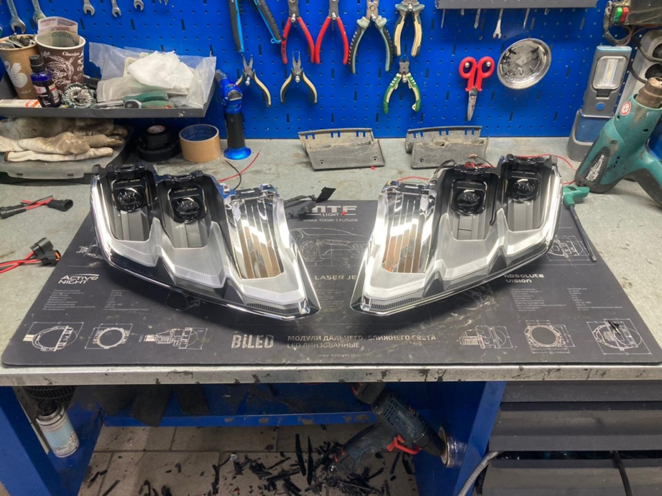

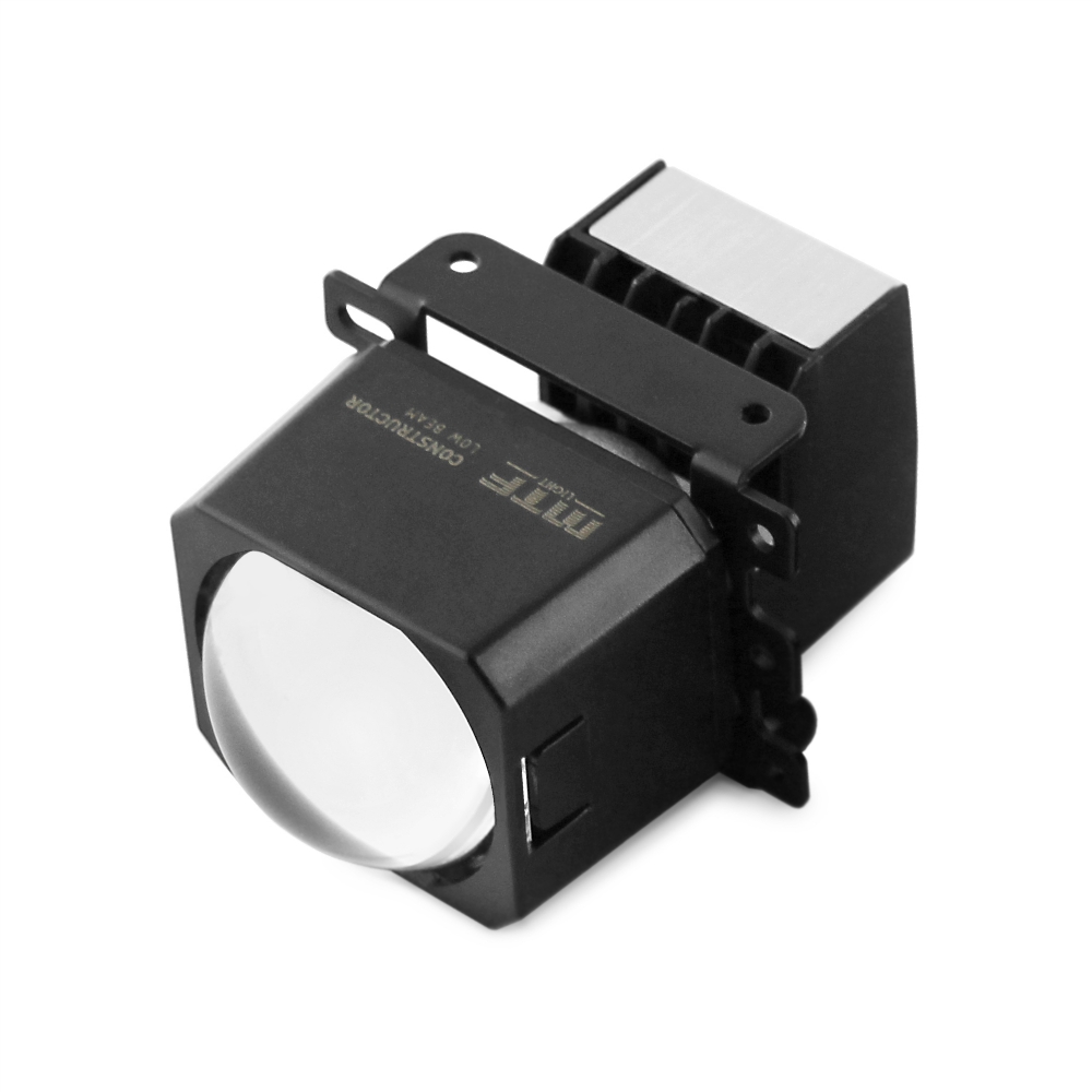

At the stage, we decided to put 2 low beam modules MTF Constructor Low Beam 1.8 ″ 5500K into the headlight unit, and separately put a more powerful diode into the high beam unit. What kind of diode the studio did not tell, since they also develop solutions based on diodes themselves. Kind of a secret))))

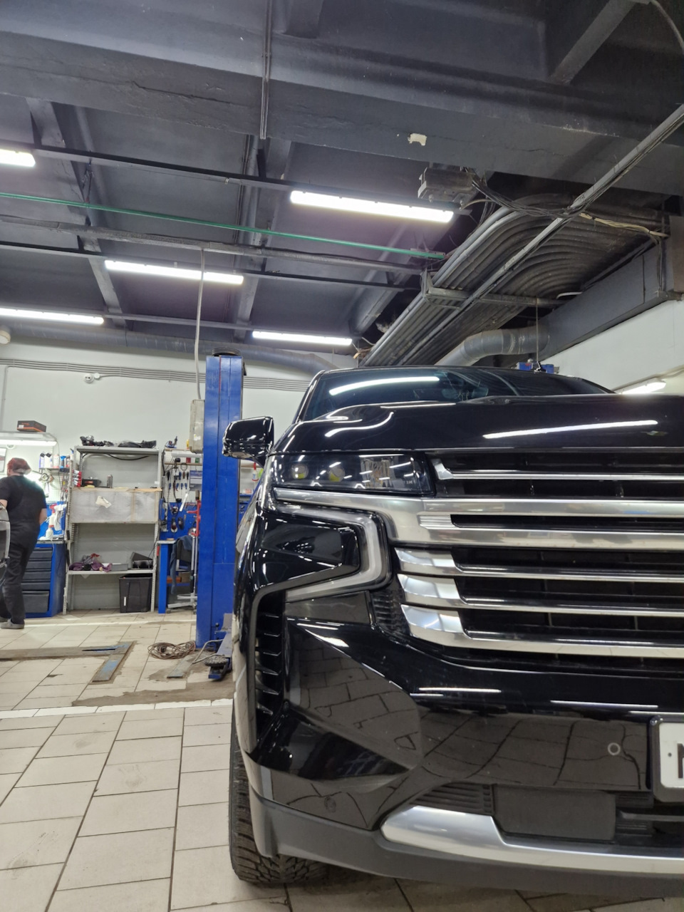

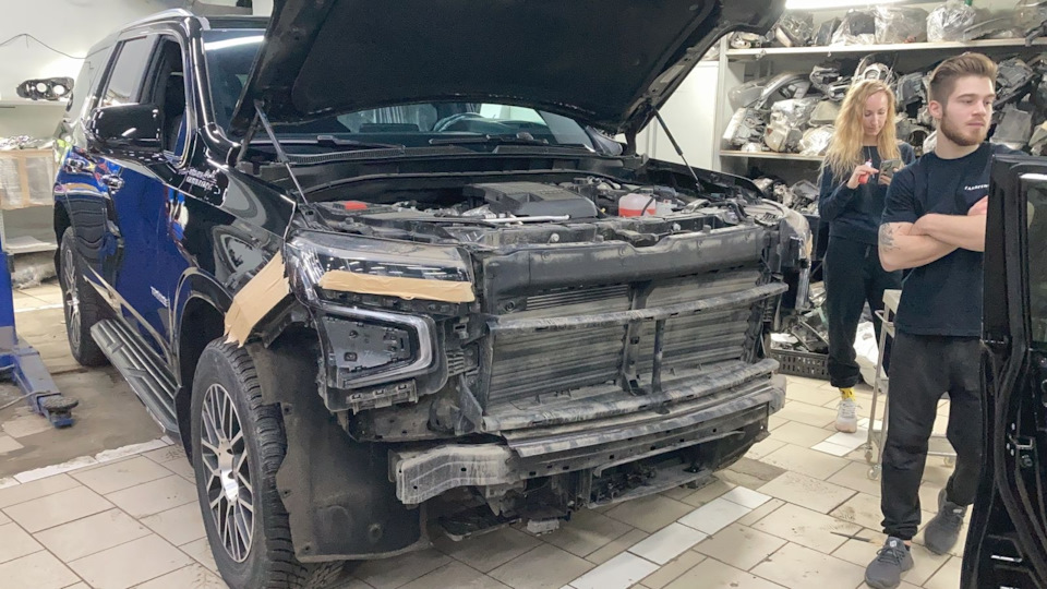

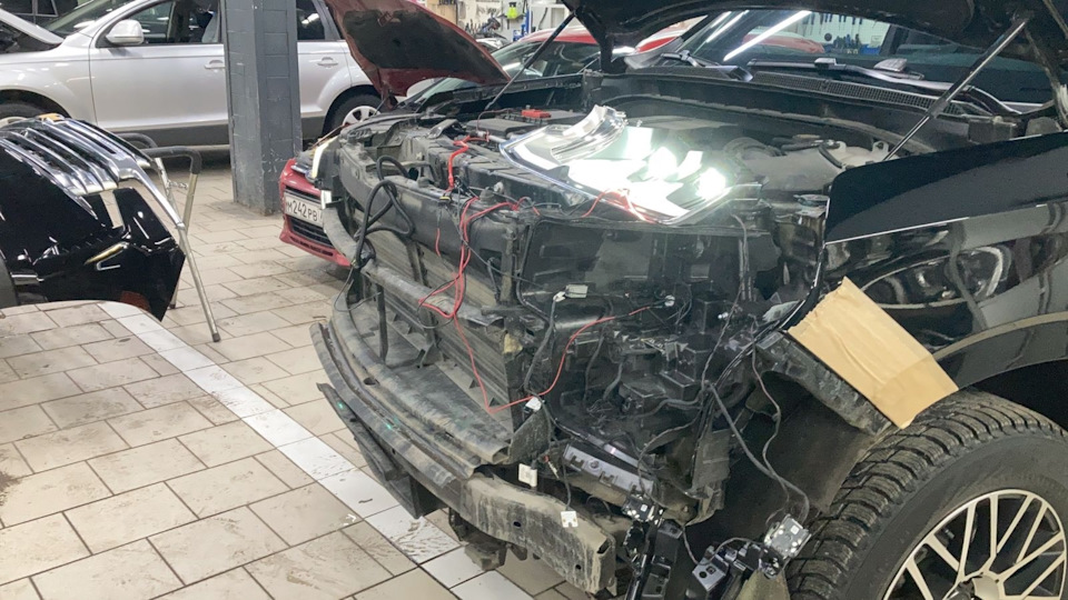

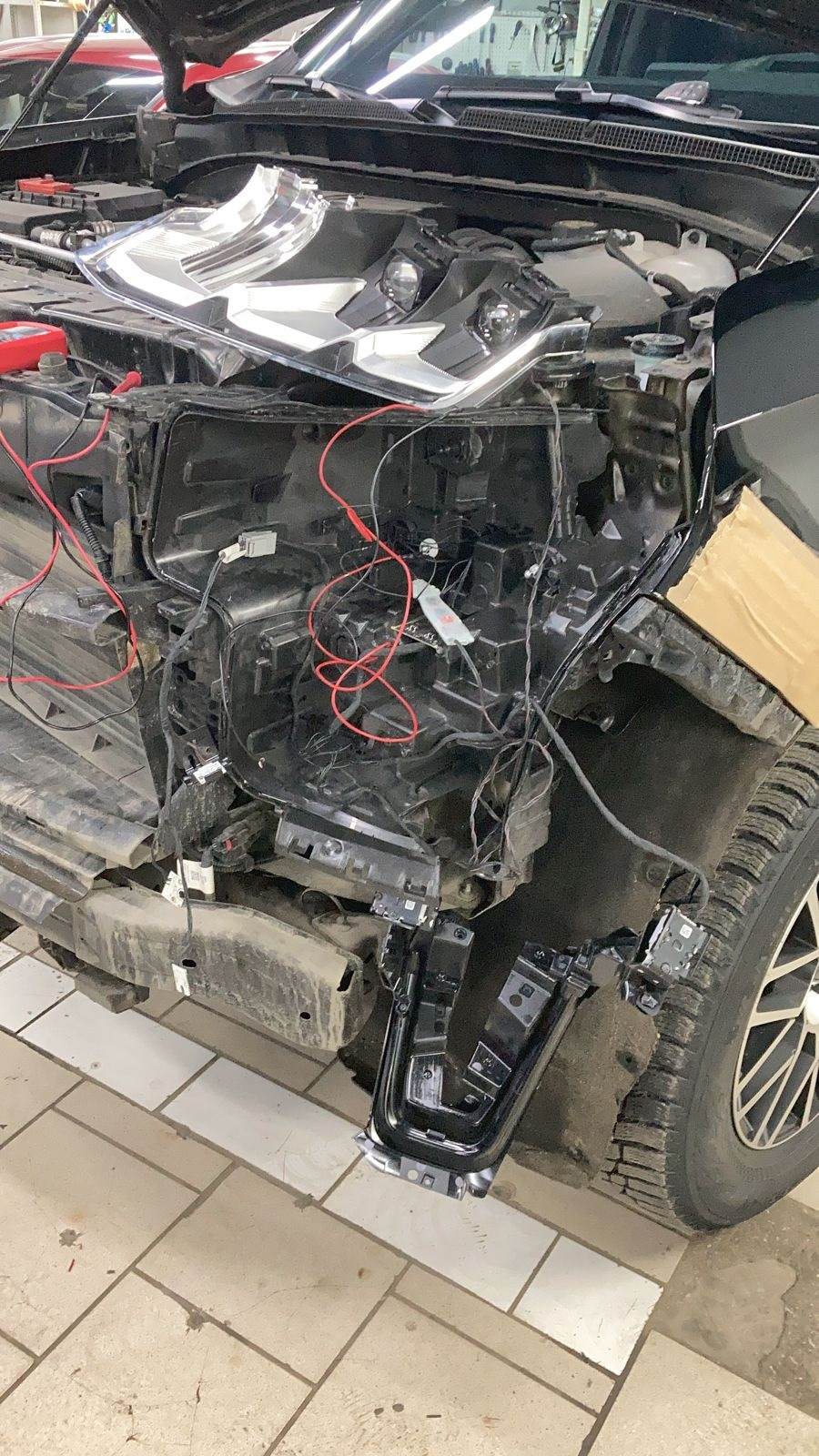

Because of the custom solution, it took a very long time to try on and adjust the light on the car itself.

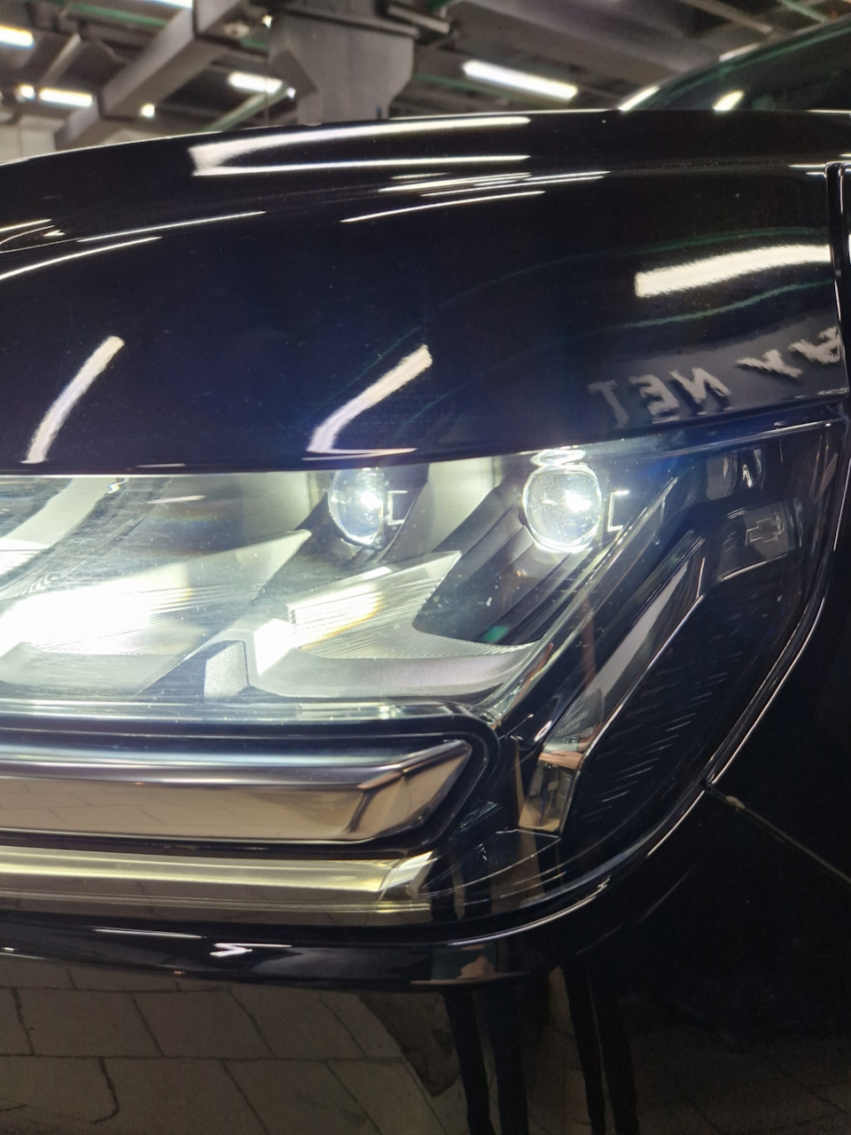

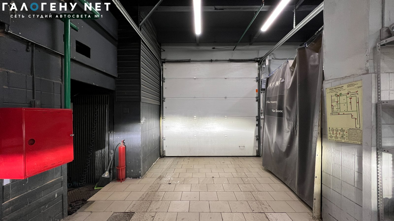

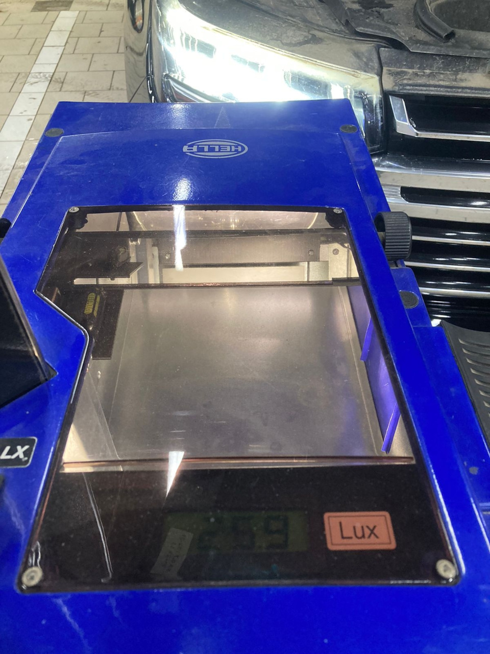

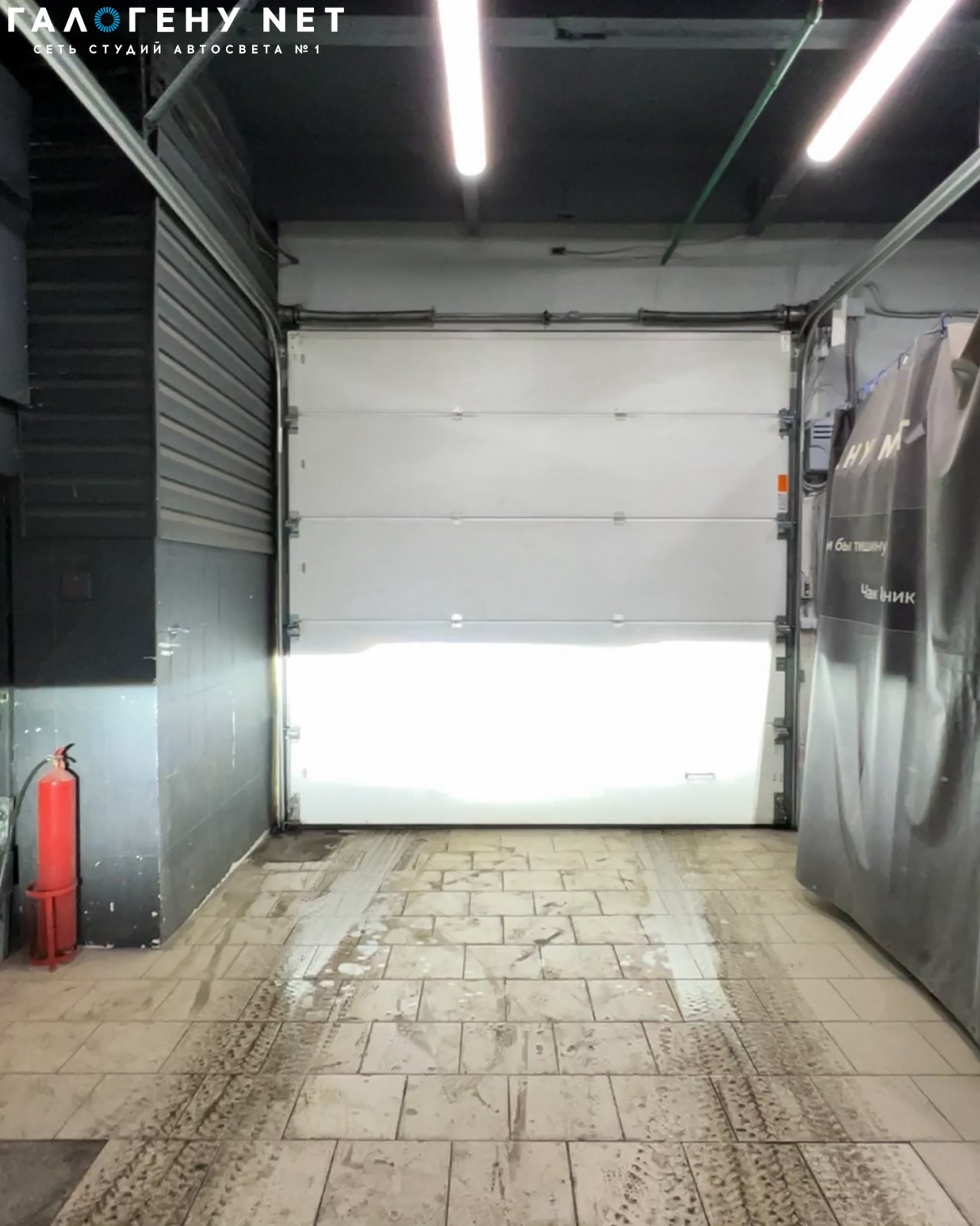

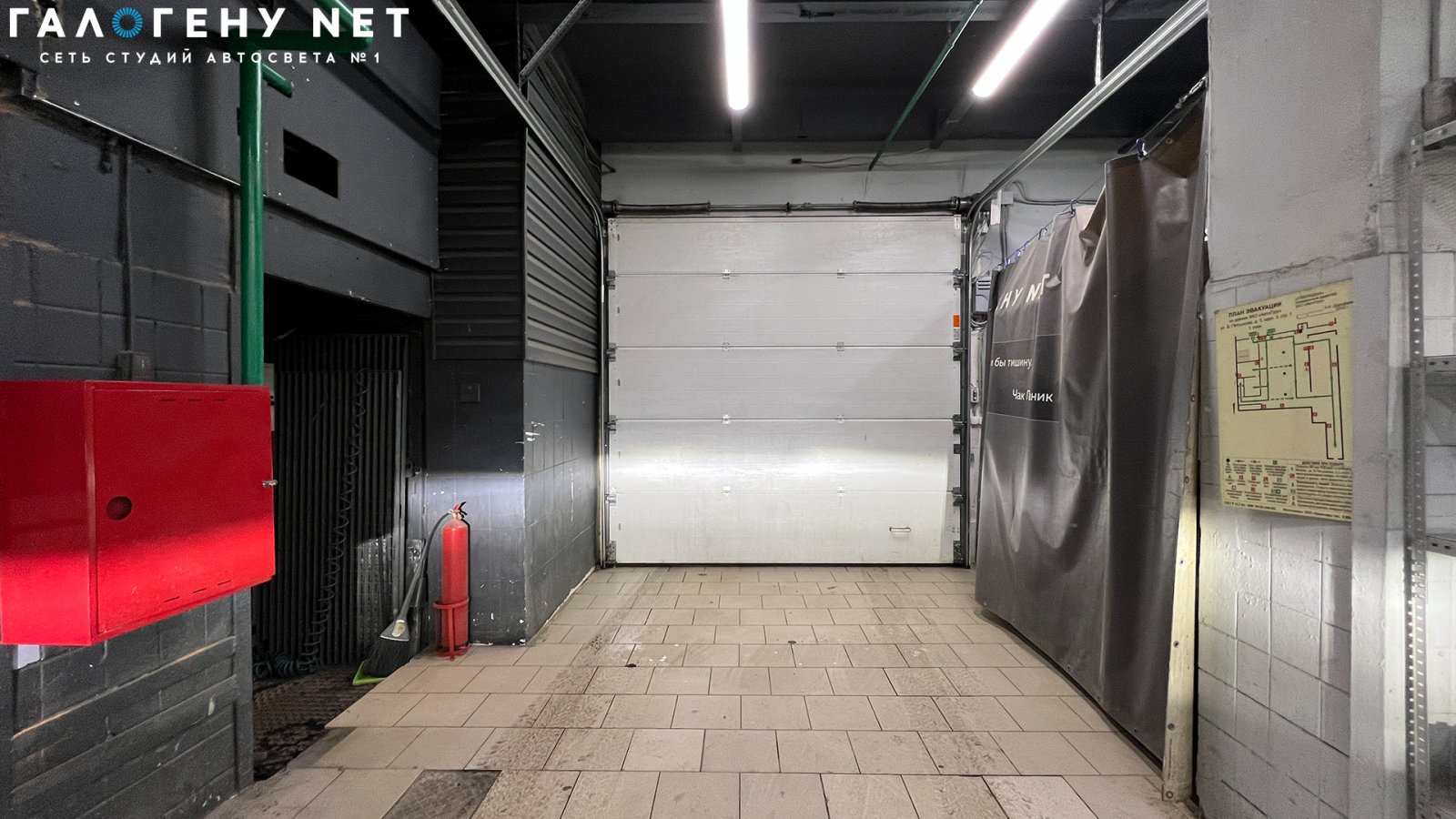

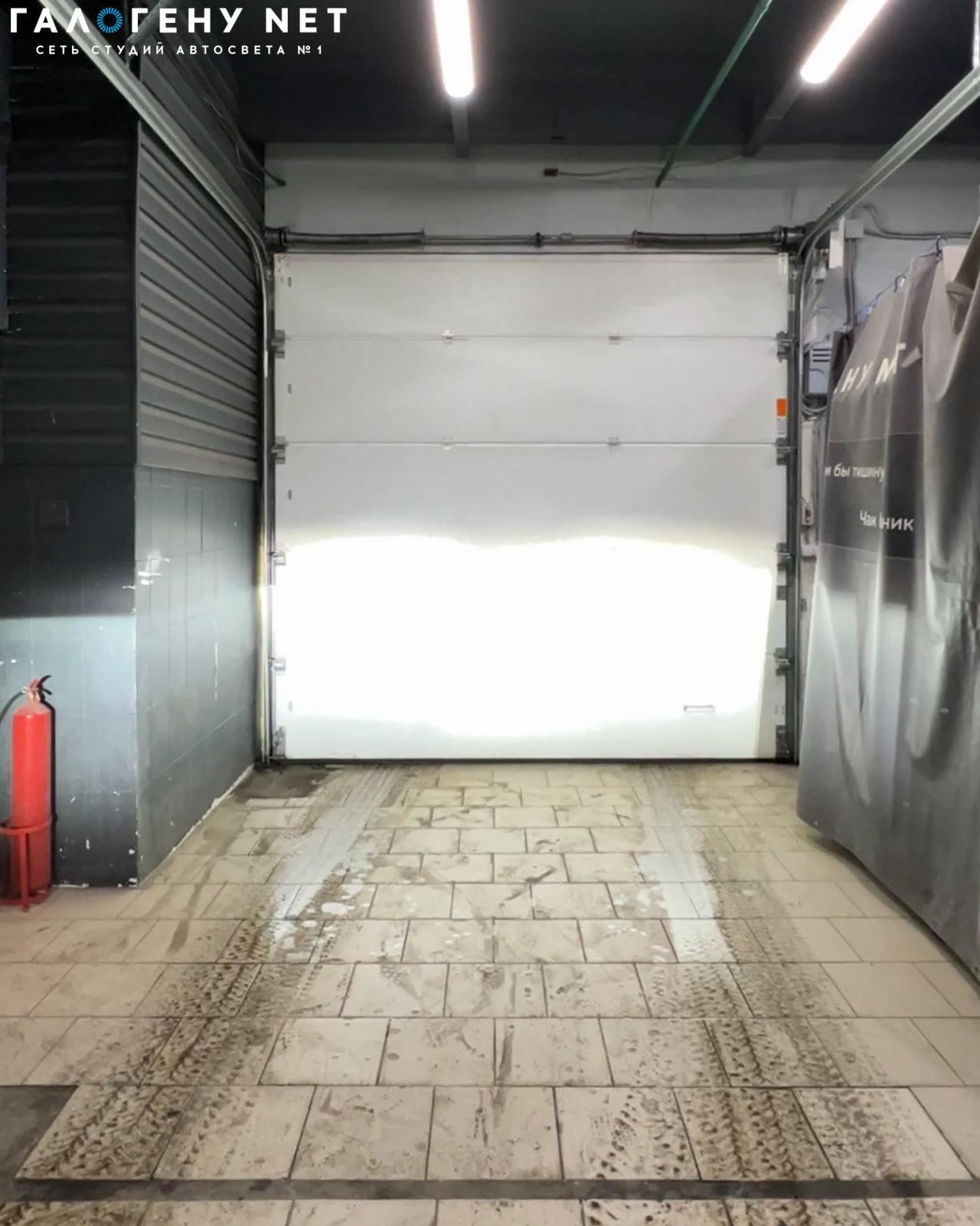

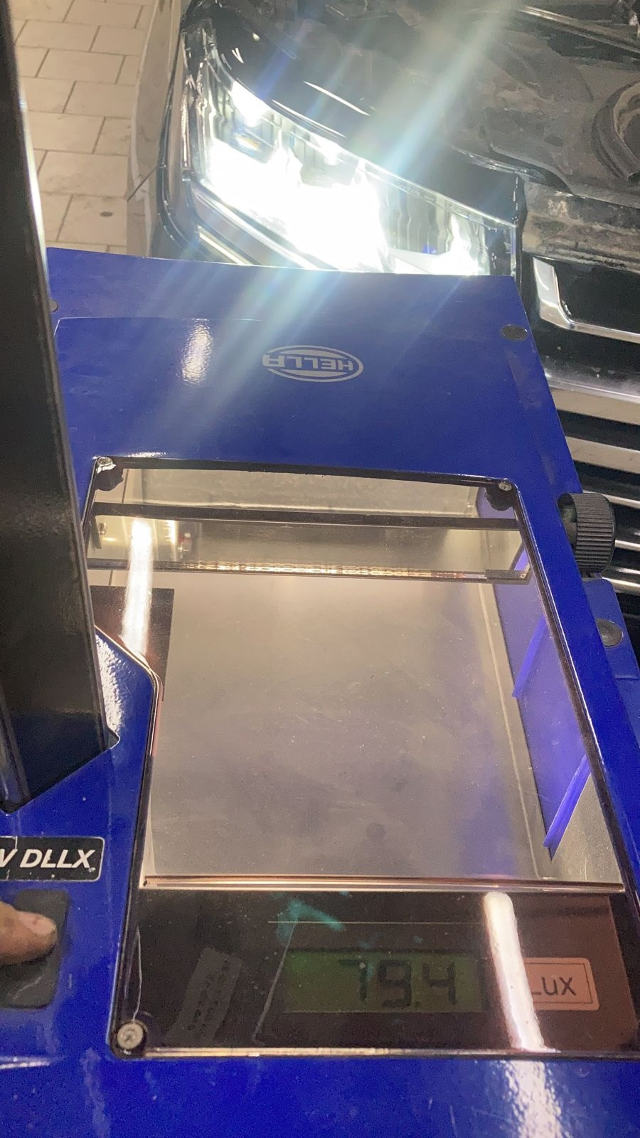

In the end, everything was set up and assembled. The measurement showed that now the dipped beam gives out 79Lux, against 25Lux of regular light. And here's what happened on the wall. The difference is very noticeable.

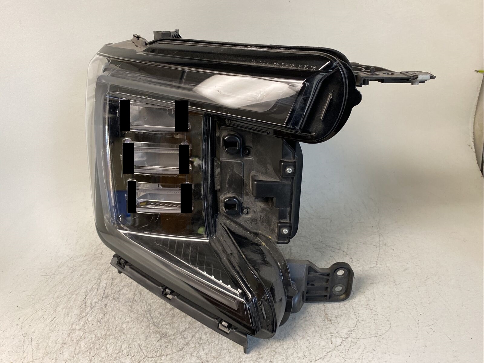

So I've looked at the MTF Constructor LED Low Beam 1.8 ″ 5500K projectors a bit more, and they also offer a High Beam LED Projector. They're a very powerful and efficient compact LED projector. They're ability to be installed in both horizontal and vertical arrangements offers a lot of flexibility.
Checking out their website they even have a Bi-LED 1.8" 5500K LED projector!
There has got to be a way to open up a 2021+ GMC Yukon LED headlight and put 3 sets of those Bi-LED projectors in there! To have all 3 on for low beam and all 3 on for high beam would be the ultimate 2021+ LED headlight set up!
Have you opened up a 2021+ GMC Yukon LED headlight to see how similar the mounting and wiring is to the 2021+ Tahoe LED headlight you guys upgraded?

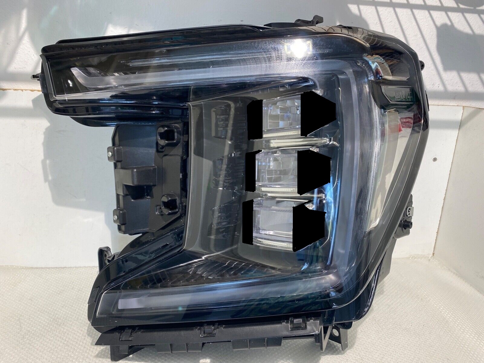

there is another problem. If you install modules, then most likely the awesome design of Yukon headlights and rectangular sectors will disappear. Plus it is not clear how the cooling will cope. In general, in order to understand what is inside, you need to disassemble Faro. And if we have a lot of Tahoe, then Yukon is a rarity. And it will be quite expensive to bring a broken headlight for disassembly from the USA)))
Yes the rectangular sectors or lens(s) would disappear, but they would now be replaced by the modules. Which is fine by me given the additional light output and performance you gain. The challenge would be how do you install the MTF modules in place of the OEM rectangular lens and still make the install look clean and OEM+ when the headlights are not powered on.
The challenge I see is there doesn't appear to be projector/module "shrouds" offered to be used in conjunction with the MTF Constructor LED modules. Like there are for typical 2.5", 2.8", & 3.0" Bi-LED projector retrofits to create a cleaner install.
Without taking measurements the OEM rectangular lens seems wider than the MTF Constructor 1.8" LED module.
As you mentioned it's hard to tell what's doable without disassembling an OEM headlight, but the OEM LED rectangular lens(s) might just snap into place either individually or as a single piece inside the headlight. If the OEM rectangular lens could each be cut/trimmed with openings for the MTF Constructor 1.8" LED modules to be put in place, then painted gloss black to match the rest of the OEM headlight housing I believe that may be a way to use the OEM rectangular lens as a "shroud" to the MTF LED modules creating an OEM+ look.

For some reason, I have a feeling that the Yukon has a rectangular lens. It's just a decorative cover. but I could be wrong)
I hate to break it to you but Valeo isn't a cheap company, let alone Chinese...
