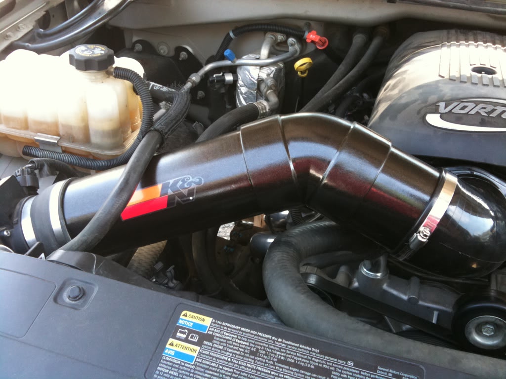

You're right about the ebay "cold air" intakes being gimmicky. Common sense- where does that [crappy] cone filter get this "cold air"? From the engine bay that it's open to, 20" from the exhaust manifold? Yeah, there are some that have a heat shield. But, none of them seal the filter from the engine heat anywhere nearly as well as the factory box or a high-priced aftermarket kit. This is why they're called "hot air intakes". The factory design IS a "cold air intake". I agree that $150 is steep for a plastic tube that yields very little more than a nice intake growl. If you're patient, you might run across one for sale from someone switching it up or returning to stock. I've bought two- mine for $100 from a forum member and another for a friend's truck for $60 off craigslist.
If the labor is worth it to you to save the cash, you can make one out of plumbing fittings. Considering the work you put into your wheels, this might be your thing. Or, go middle of the road and buy an ebay piece and use just the tube.
I can never find the pic of my buddy's homemade tube but it looks similar to this:
I think his ('09 Tahoe) has an extra 45° fitting in it to aim straight at the factory filter box after arching over the rad hose. If you don't like the flared parts for the slip-fits, you could cut them off and use PVC cement to "butt weld" the joints together, then sand and paint/wrap/dip it.
I'm liking the homemade option! I was already thinking about that but the pic and description helped a lot. Finding some good stuff on Google, including the full post this pic came from. I was also thinking about buying one of the cheapies on ebay and just using the tube, but I think there'd still be some tweaking to it to get it to mate to the air box.

I can never find the pic of my buddy's homemade tube...
Found a pic. Sort of a difficult angle to study, but you can get a good idea. It looks to be a 90, two 45s and maybe a foot total of straight pipe to join the elbows together. I would've sanded the lines and text off the flares before painting it:

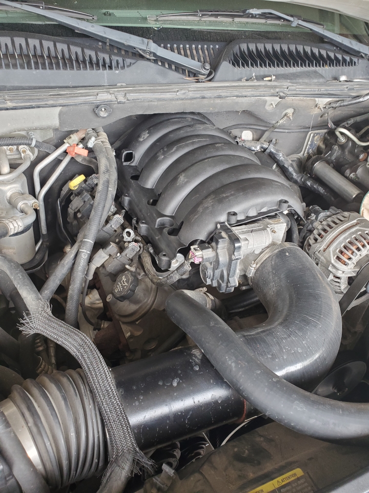

Get some pvc pipe and the 90 elbow from Amazon. That's what I did, I also have the K&N filter.

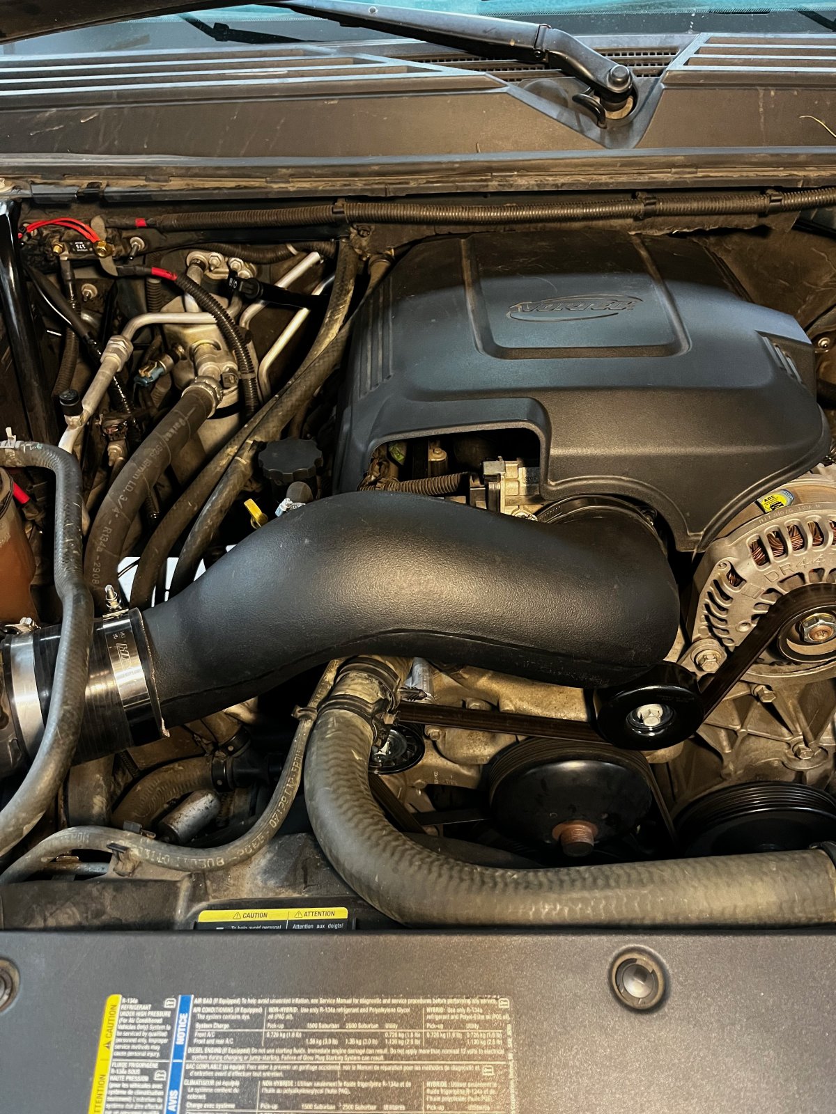

@Dave09 i have one available for sale. Used it for less then 6 months. Let me know if your still looking.
I received it today - went on no problem, looks great. Thank you.
I decided to buy the used one @crownvic31 had for sale. Very reasonable price - judging from the price of those rubber splices in the plumbing section, I don't think I would have saved much/any money by making my own. Pleased with the result. I was a little worried it'd be too noisy up front without the resonator chambers, but I barely noticed. Just at hard throttle can you hear a little more intake noise.

I decided to buy the used one @crownvic31 had for sale. Very reasonable price - judging from the price of those rubber splices in the plumbing section, I don't think I would have saved much/any money by making my own. Pleased with the result. I was a little worried it'd be too noisy up front without the resonator chambers, but I barely noticed. Just at hard throttle can you hear a little more intake noise. View attachment 402222
Looks great brother. Happy it all worked out and i was able to help you with this.
Enjoy
