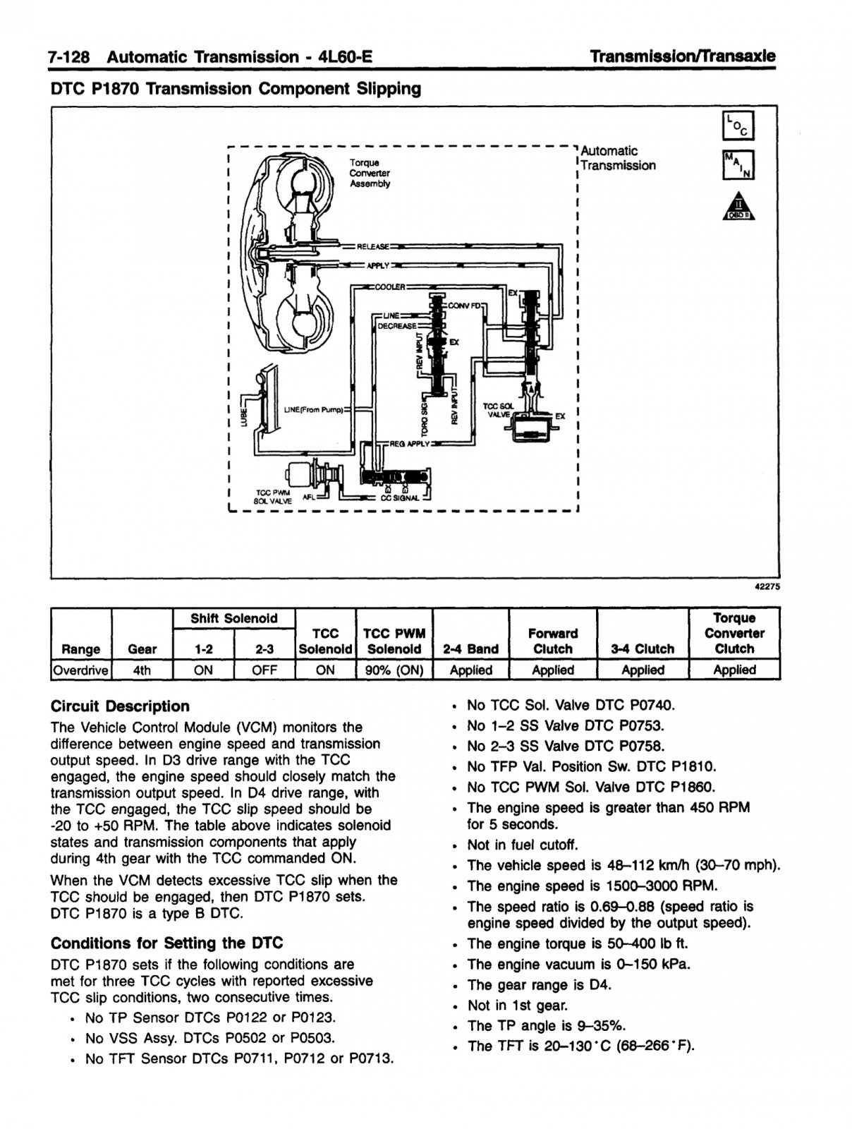

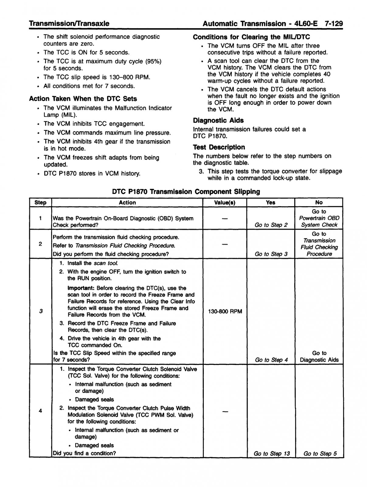

If a scanner isn’t in the immediate future, I’d try dropping by a tire shop or similar chain-store type place and ask the guy if they’d pull the codes for you real quick.
You might also consider getting a copy of the GM service manual. It has the diagnostic procedure tables associated with each code (once you get them) and are pretty straightforward. It’s largely written around the Tech2 scanner and can include references to special ($) Kent Moore tools, but it’s certainly worth looking into as you can usually workaround those things.
I don’t think that they have them for 1999, but the site below does have free PDF copies for 1998. While that should suffice for the majority of things on the truck, I couldn’t speak to any differences in the 4l60e for those two years. Best look for a 99 manual if you’re getting into the weeds on a transmission.
Alldatadiy.com is a subscription service which has nearly verbatim copies of the GM manual and is pretty easy to use. Used paper manuals (eBay) are another option.
Good luck!
Edit: Here are some sample pages from the 98 manual…

Thanks east, this is helpful- these sample pages are my kind of deal (way of thinking/working through things). Like others on here are saying and I knew would all-too-soon be the case, I broke down and ordered a Launch bidirectional scan tool today (so much conflicting info on Autel models, verions, etc I caved on it).
I will for sure download the manual on that link for my 98 Tahoe!
