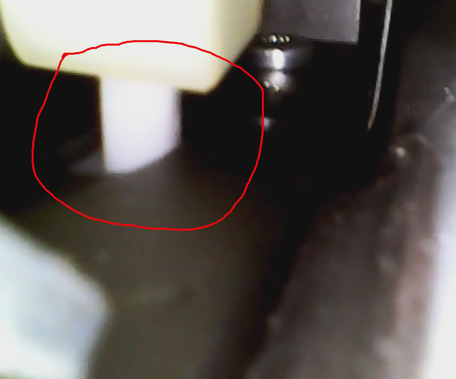

I was able to get the door panel off and get a look at the actuator using a fiber-optic camera. The only thing I could find that looked stuck is the small white lever that sticks out of the actuator housing and attaches to the yellow-colored gear that is attached to the metal rod for the manual door lock. Does anybody know if there is a way to trip the door latch manually from inside the door? I have done it on older cars but, I can't see anything in here that would accomplish that. Surely they made it possible.

If it is from freezing, the damage is already done because it is not cold enough for anything to be frozen now. Now I just need to figure out how to trip the door latch.
