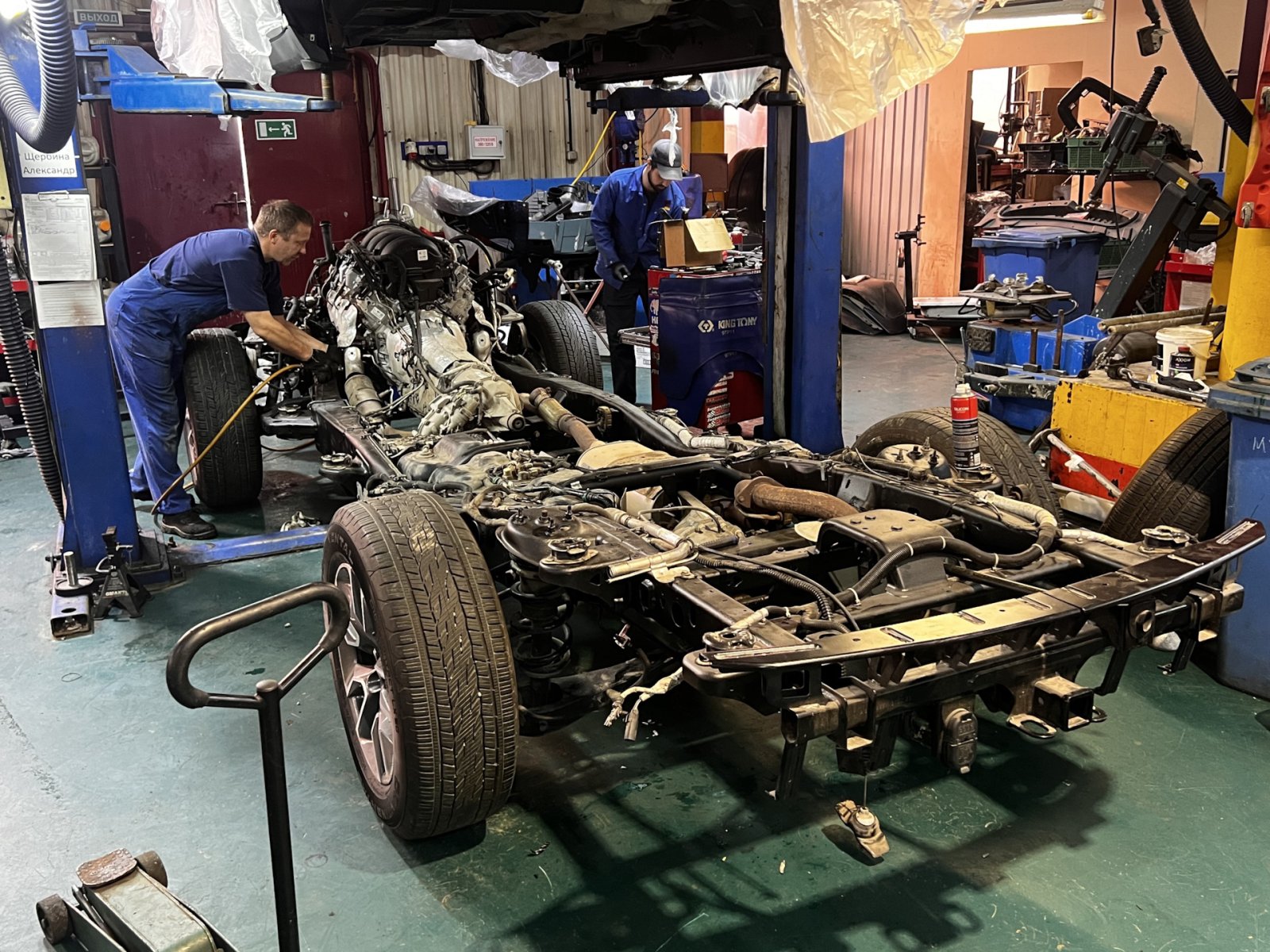

If you do, then with the removal of the frame. But there is no point in just watering from below. It's a waste of money.

Are you going to lift the car every time?
Vladimir2306
May 18, 2023
1,064
1,250
Did you see what I posted?
I've seen that it's effective, at least somehow, if you lift the car and wash the bottom from below. And if you don't, you won't wash anything anyway. Yes, and that's not why. I live in a region where salt and sand are poured for almost 6 months a year, and nothing has happened. The frame has not rotted. The anti-corrosion treatment on the T1 generation is much better than on previous generations.
