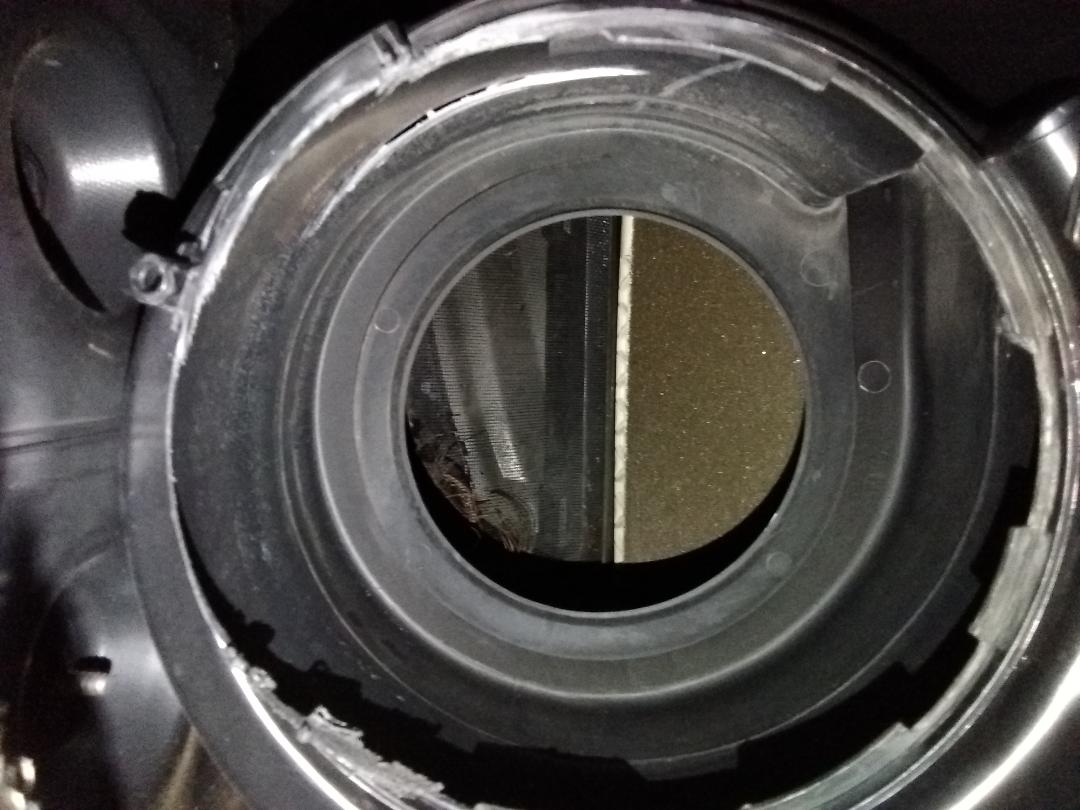

Hello,
Where can I get a new housing for the blower motor? (2005 Escalade - Same as Tahoe) The last time I installed the blower motor, I must not have had all of the tabs locked. The motor was making a little noise, but nothing alarming. Today the motor melted the housing, and fell out of the housing.
What is this part even called? Does anyone have a part number? Is it hard to replace?
Thank you.
Tom

my guess would be you would have to replace the entire box, probably easier and way cheaper to just put 2 or 3 screws in the plastic housing and use some bailing wire and cinch it up nice and snug, out of sight out of mind and fixed
