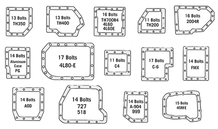

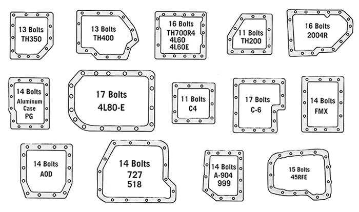

4l80's only came behind the 2500 yukon xl, not to be confused with the yukon xl denali 1500 which had the 4l60/5e trans. It could have been swapped already. You can just look at the rpo code in the glove box or look at the trans. You can keep AWD with a 4l80 trans.
**edit** 2002-2003 yukon xl came with the 4l80 in them as an option, not the denali

From the research I've found to make the 4l80e work you need to lengthen front drive shafts and shorten rear 30mm. Sadly my 1500 has the 4l60e. For future reference it's best to slide underneath and take a peak.

Ive read somewhere that 2500hd shafts fit, but I wouldn't put my faith in that working out, I'd get custom length ones to be safe. Swapping a 4l80e in an awd truck is not the simplest of jobs, but its been documented several times on pt.net & silveradoss.com to make things easier and take out the guess work. When I start having tranny problems *knock on wood lol* I'm going to start piecing together that swap.
