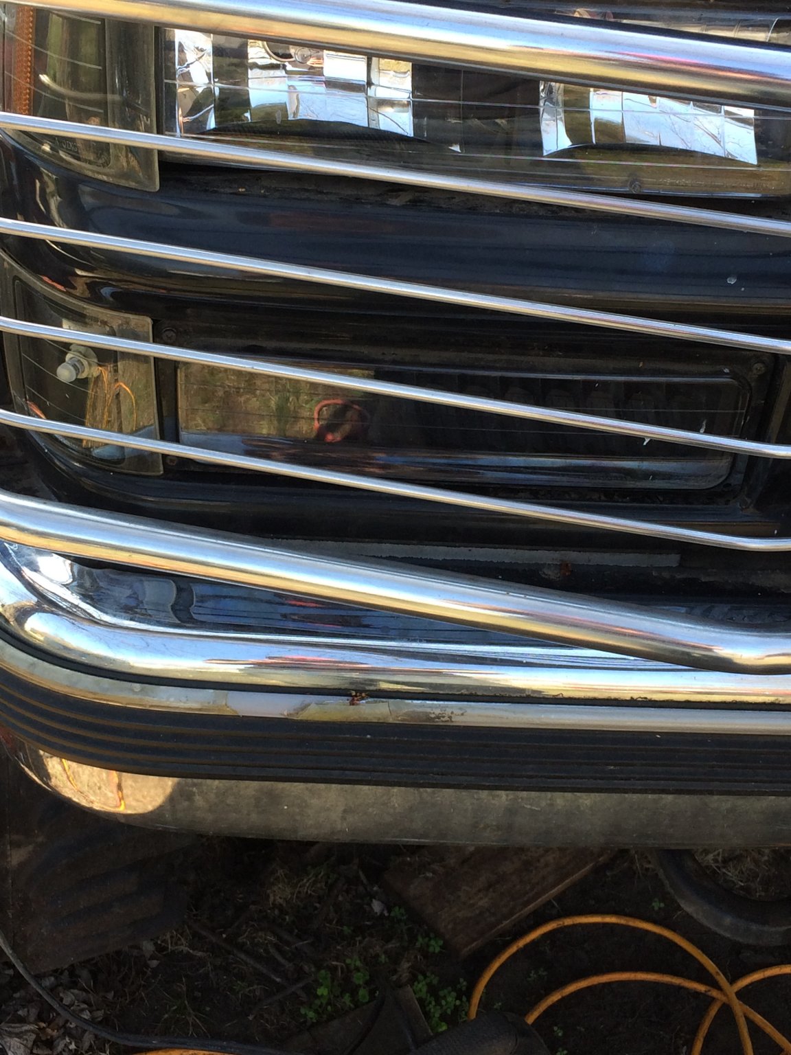

Ok so the only bulbs I have for the turn signals are the side markers. One was out changed it and still don't work. Swapped build to other side to make sure bulb was good and checked good.

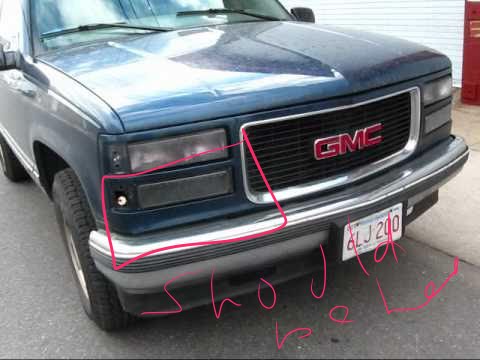

Sure about that, under the headlights in the grill you should have signals
This is a 95 tahoe right?

I'm almost pretty sure it's in my turn signal light. I unplugged right led side of the lamp and installed factory bulb and everything works fine now

Yes 95 tahoe only light bulbs on it are the hid headlights and side markers

Just now noticed you're using LED? If I recall correctly, in order to use LED bulbs in older model GM trucks you'll need to install several other parts that are needed in order for power continuity to be the correct voltage. LED requires less voltage thus your your current wiring will need some kind of converter. Do your research. I'm pretty sure LED bulbs are not just plug and play on older model vehicles.
