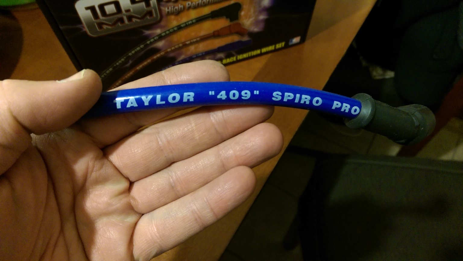

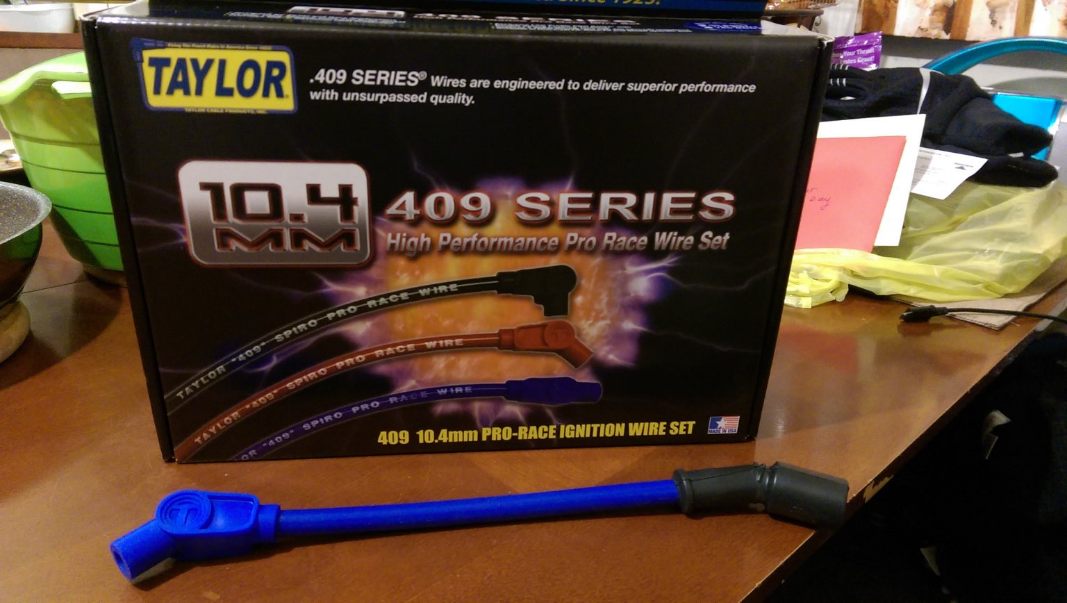

Personally I like Taylor wired. I've read a few independent tests that give them high marks.

Those Taylor wires get good reviews, but what's the warranty like? How does it compare with the lifetime warranty the Belden wires come with?

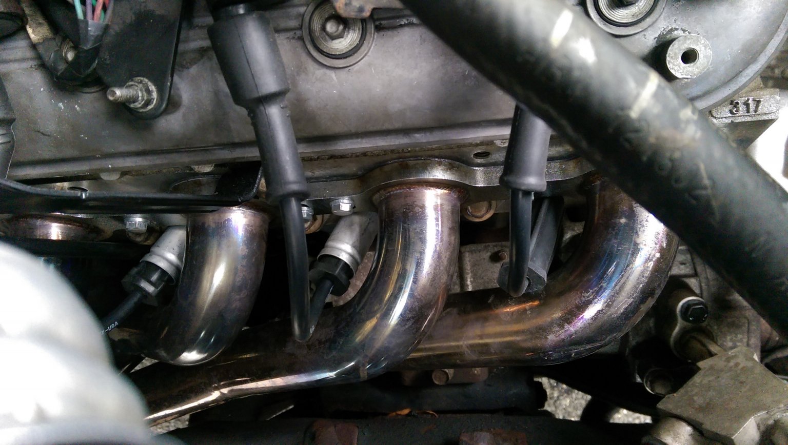

I'm not really sure to be honest. It fit what I needed, my boots we're burning on my headers and these fit the bill. Taylor make some really good wires.

Did you use the factory metal heat shields?
