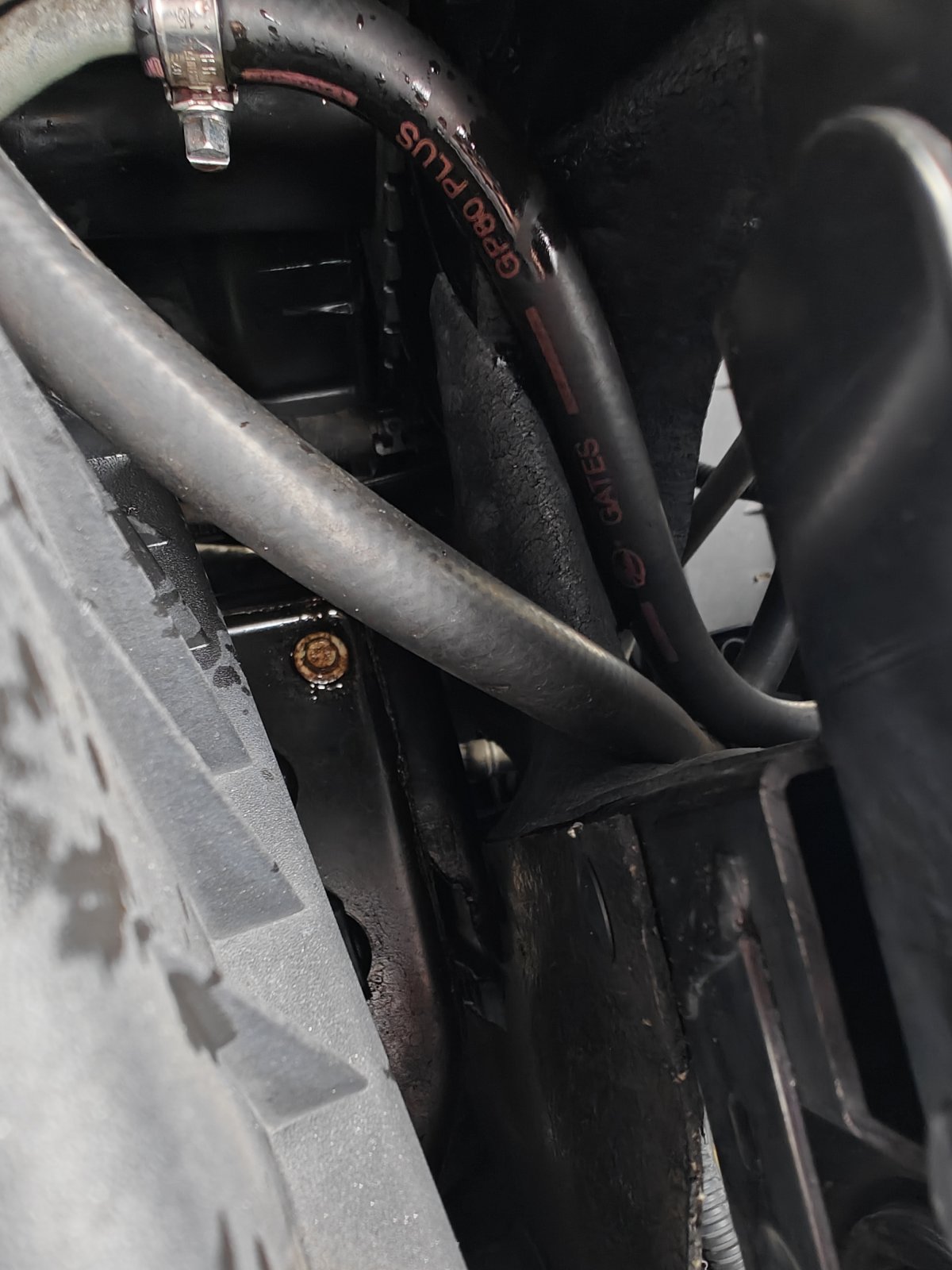

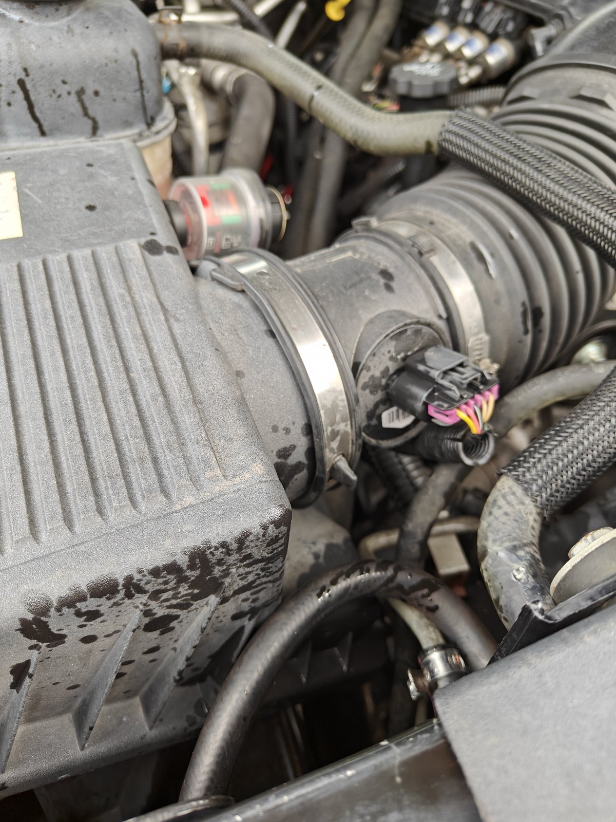

I've had a trucool transmission cooler on my 07 5.3 for a months.
One fitting just keeps on leaking, we've tried a few different clamps, but no joy.
Does anybody know of a decent fitting kit / connector set I could order up?
Tips appreciated.

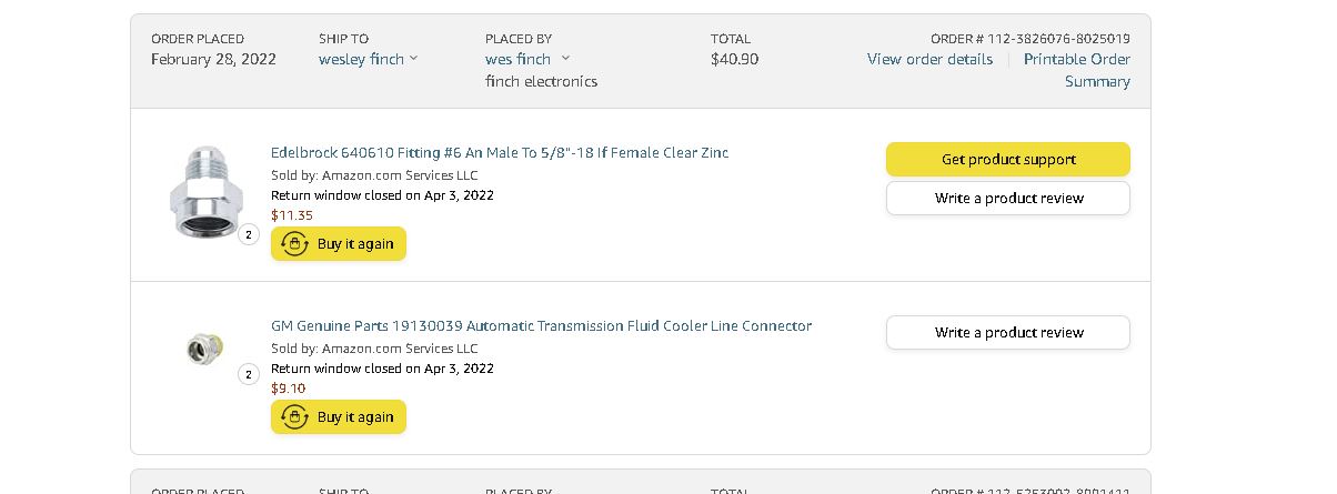

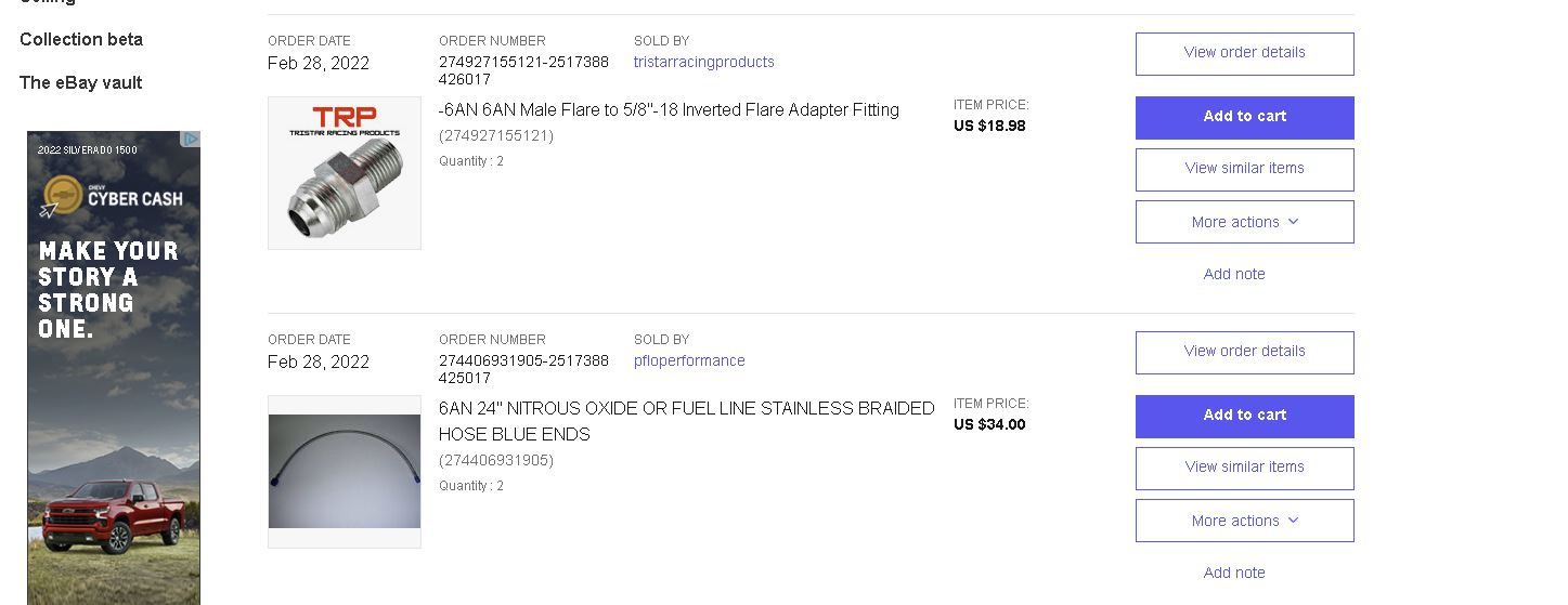

those are the sizes needed, search the part numbers separate for better pricing as those have gone up in price, thanks to you know who
the an lines from that seller are good quality.
