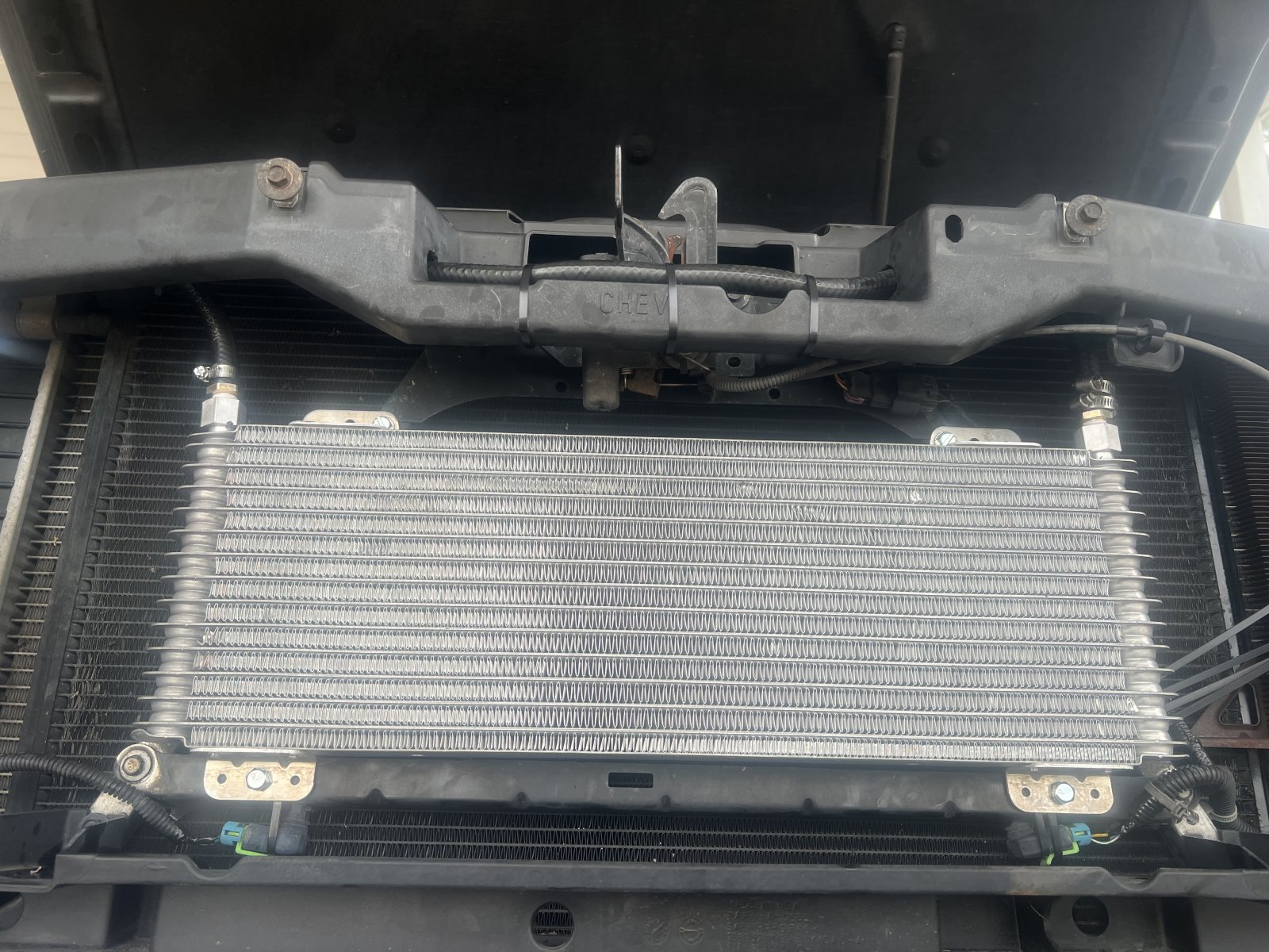

sorry 2011 tahoe LTZ just wondering if it matters which way the fluid enters the cooler via right side or left. Company told me it didnt matter but he wasnt too sure,

I actually mounted mine with the ports facing up so I could bleed as much air out the system when installing it also gave me a good line to run under the radiator support and through the passenger side

Ain’t to shabby for some redneck ingenuity! Only thing I diddnt like is I couldn’t get the driver side hose bent over enough to run under the support where it was out of sight. I also diddnt want any chaffing if they rubbed against the hood latch.
I drilled a couple holes and ran it across in front of the hood hinge but this was the only way I could do it with a straight shot and no kinks in the hose. My Tahoe diddnt originally come with a transmission cooler so I had to make a T fitting of sorts to tie it all together. So far no leaks and transmission temps went from 200+ to 165-175 once she’s warmed up good
Ain’t the prettiest but it gets the job done. Someone asked About the clamps being able to hold the pressure or not but so far I’ve ran the immortal dog shit out of mine here lately on the highway and shift points are over 6,000 rpm wide open throttle and again no leaks thus far.
