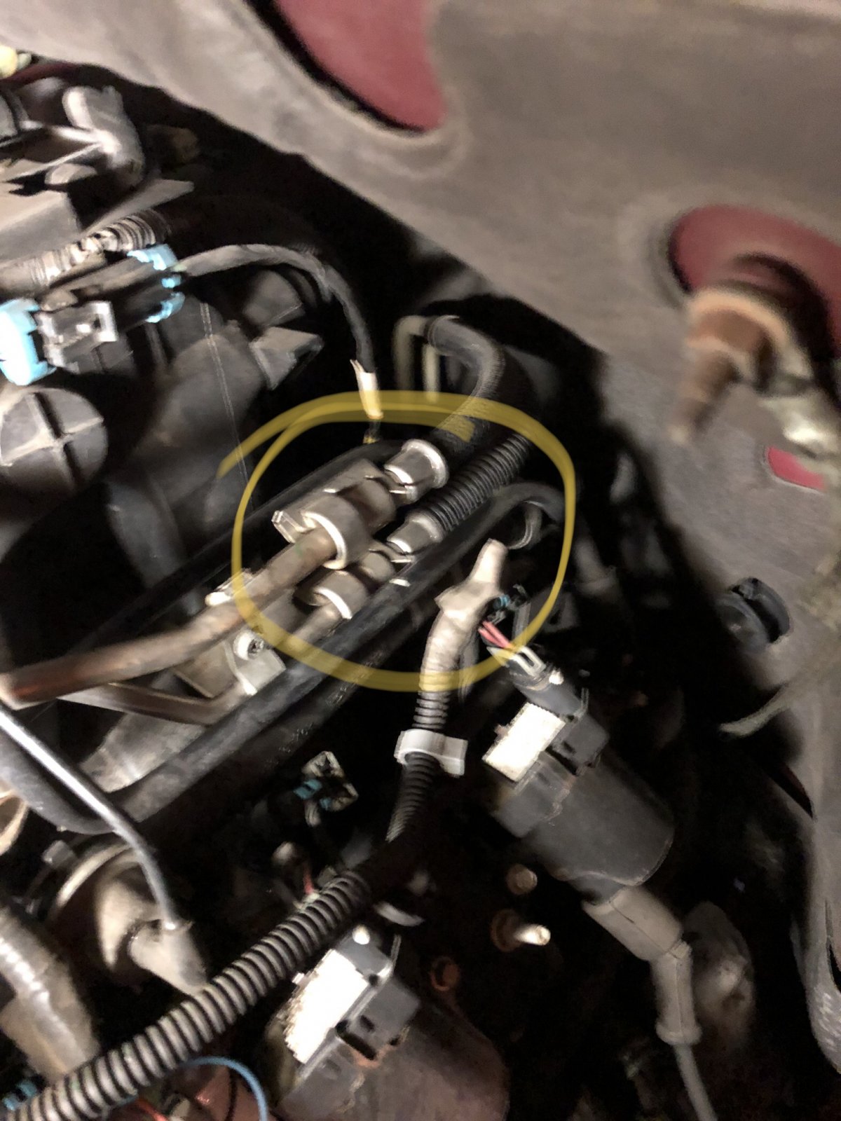

The circled area is where I heard what sounded like a vacuum leak. Again the propane did not have a noticeable change in RPm. Is this normal? I saw someone use water to locate vacuum leaked. I may try this next.

see that black tube leads tot he firewall then just out side the circle is a white connector? make sure that lines not broken.

Z engine, so Flex Fuel.
Another thing to check: since the positive fuel trims present on both banks, make sure there's no unmetered air getting in after the MAF and before the throttle body. The intake pipe should be connected tightly on both ends, and check for any cracks, or small hoses being disconnected from the intake tube. IIRC there should be at least one smaller hose that connects underneath the tube.
As @Scottydoggs noted, do a careful inspection of the condition of any rubber vacuum lines on the engine. A standard vacuum test with a vacuum gauge might help find something.
If you have vacuum assisted brakes, there may be a check valve in the line to the vacuum booster. Check that to see if it's acting right (can be done during the vacuum test).
