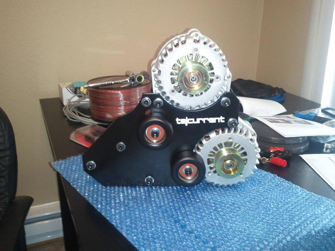

Figured i'd show you guys some pics. I got my bracket from tejcurrent. It can hold 2-3 alts, whichever you choose to run. The kit with all of the hardware and long belt is 330 shipped without alts.

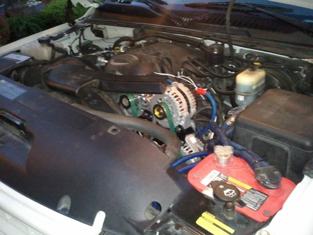

Tejcurrent pointed me to a sweet deal on brand new factory 130 amp alts for 66 bucks a piece that im running for now (speedycarparts.com), along with my powermaster 240amp one i've had for a bit. It'll give me about 500amps max of power. The instructions were very good, along with pictures.
The bracket took about 4-5 hours just to get everything correct. Relocate the "brain" a few inches forward and zip tieing some hoses out of the way. I assembled EVERYTHING on the bracket before i lifted it all into the truck, takes 2 people to get it lined up correctly.

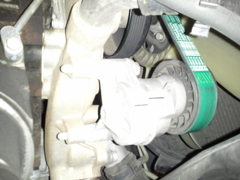

And here is a mark i drew on the tensioner, just with the 1 alternator and factory belt. Just to see how much more tension was on it after the 3 alts and new belt. Not too bad at all, i've seen some peoples installs where their tensioner is maxed out.

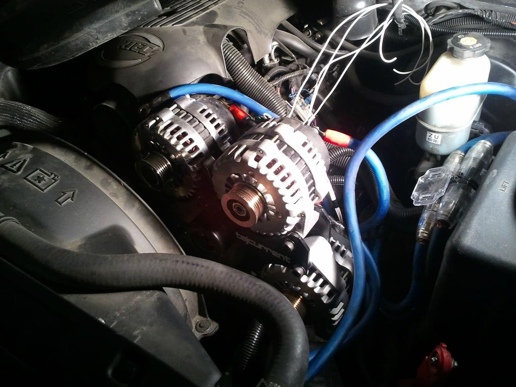

Sweeet. I feel like the quad setup would be even more of a pain to install! I was running one powermaster 240a alt built by mechman, redtop optima up front and 1 kinetik 2000 and 1 kinetik 2400 in the rear before with my RD D9 @ .5 ohms (5400rms). full tilt playing for 30secs at the least would dip to 11volts.
I was testing my batts before i started the truck with the new bracket and my kinetik 2400 was dead, sitting at 9 volts. I junked that and got a optima yellowtop to replace for the show this weekend. So now with the 1 powermaster 240a alt and 2 stock gm 130a alts, 1 redtop, 1 kinetik 2000 and 1 yellow top, at full tilt it barely dips below 13v. A BIG difference. After the show this weekend im gonna sell all my batt's and switch to something else. And selling my RD D9 for 2 4k's :)
