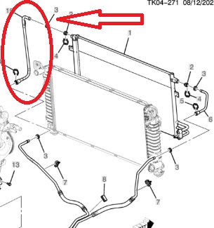

Replace this pipe if you have it

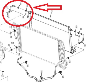

With this pipe 23352718
And enjoy 25-30 degree drop in trans temps, my 16 Silverado and 18 Yukon Denali both with the 10L80E rarely go over 160 trans temps here in Houston while beating the snot out of them both. When cruising I see 145-150ish.
I'm interested in doing this. My transmission runs kinda cool, but does see 212+ on really hot days, and I don't like it.
What does replacing the pipe achieve, technically? I have that pipe in pic #1. If I replace the pipe with the one you are showing, won't I have to plug up the original hole/holes on the radiator? Forgot to mention that I live in the DC area, so sometimes winters CAN be cold. Will this be an issue if I bypass the radiator entirely?
I think this is the part my truck has. It's a 2019 Cadillac Escalade ESV.

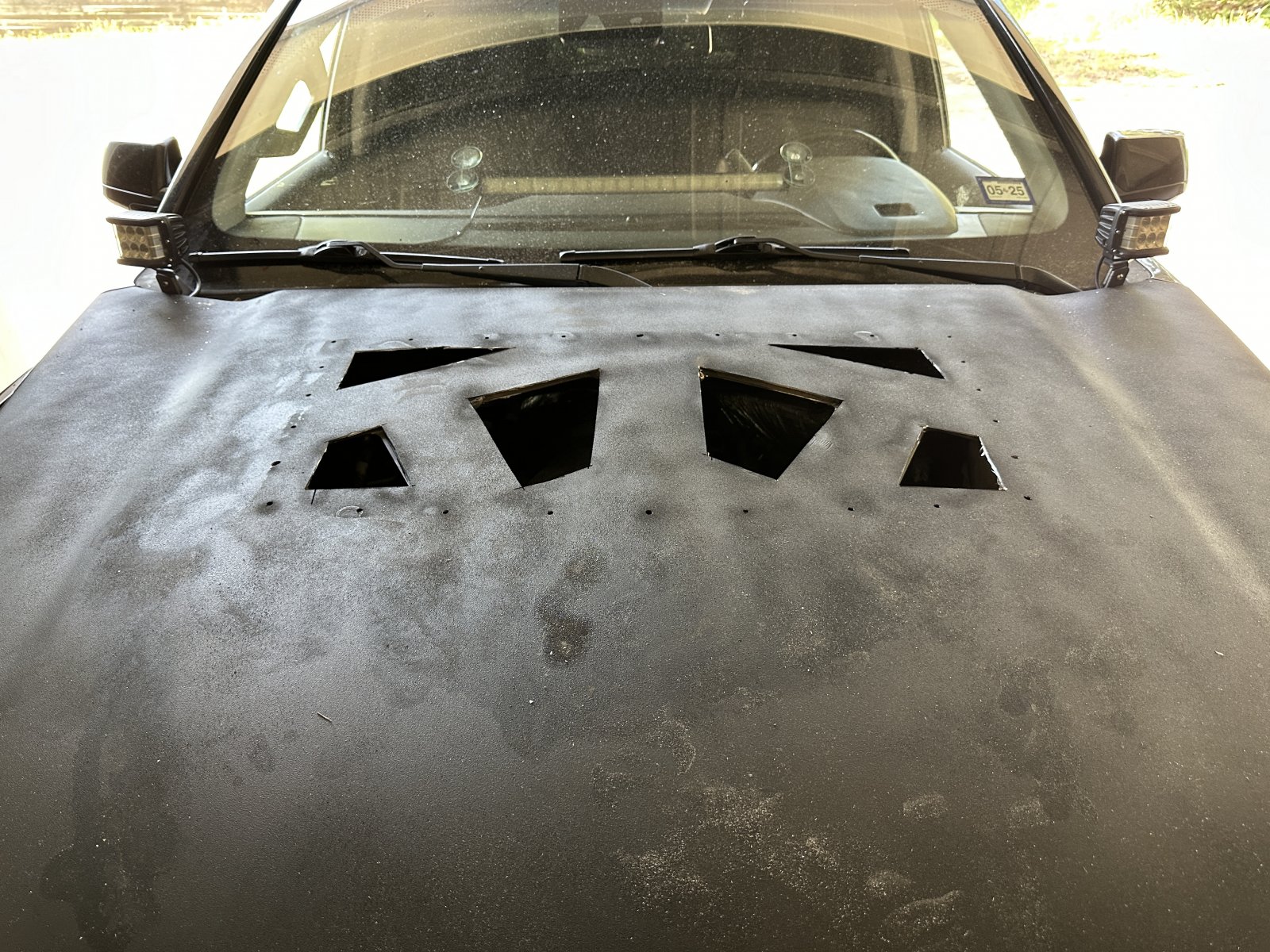

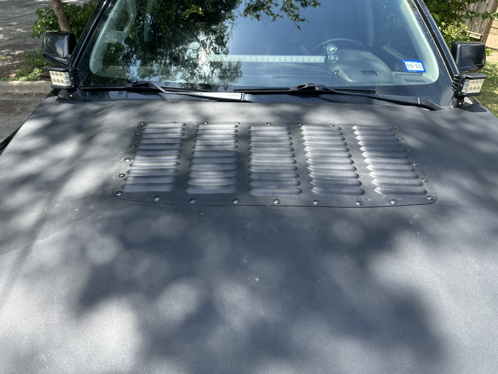

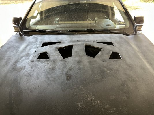

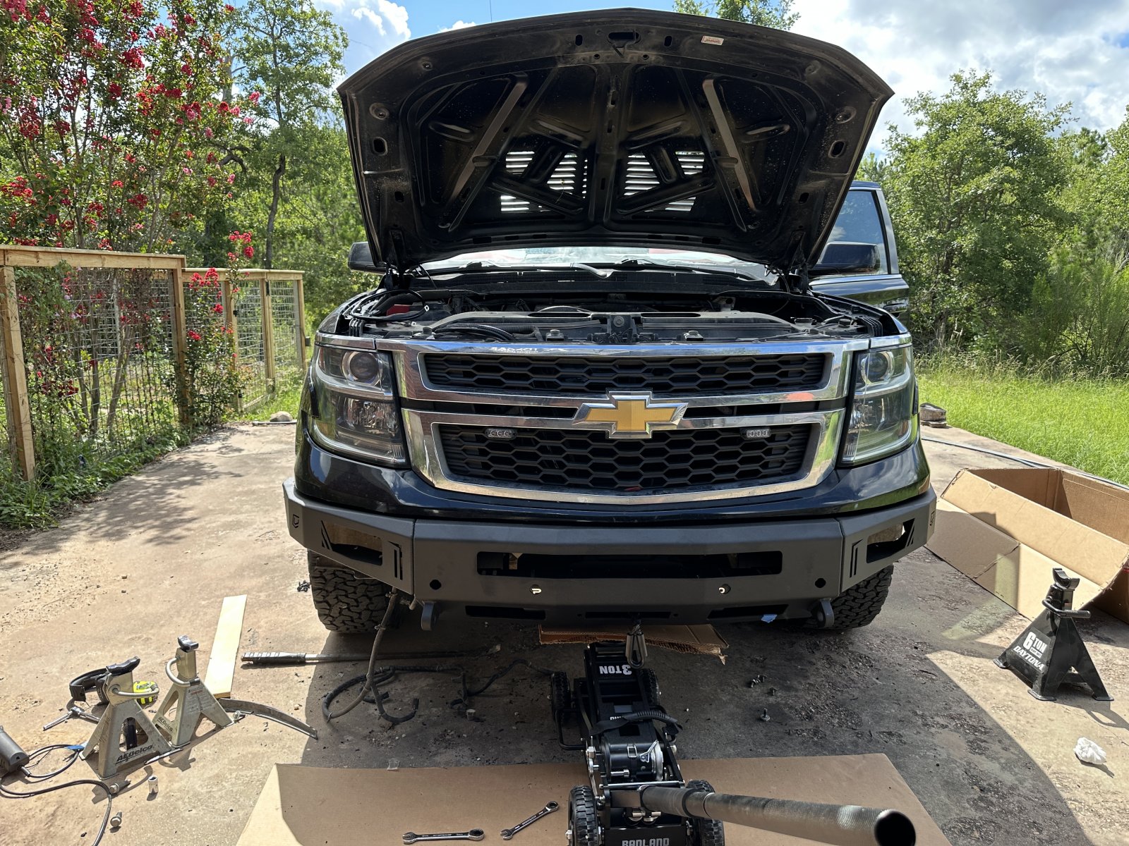

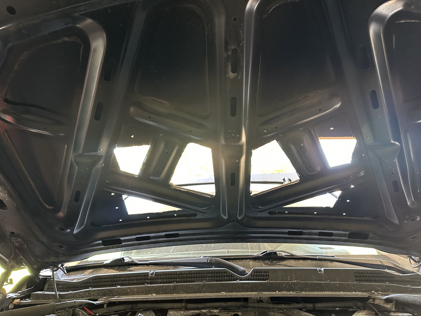

Lack of airflow on roads like that is why I ventilated my hood. Convection works too.
